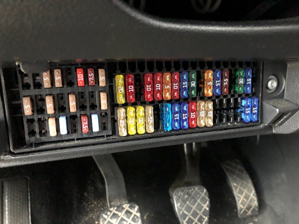

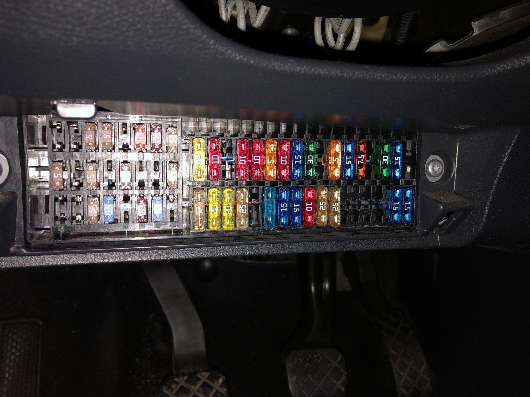

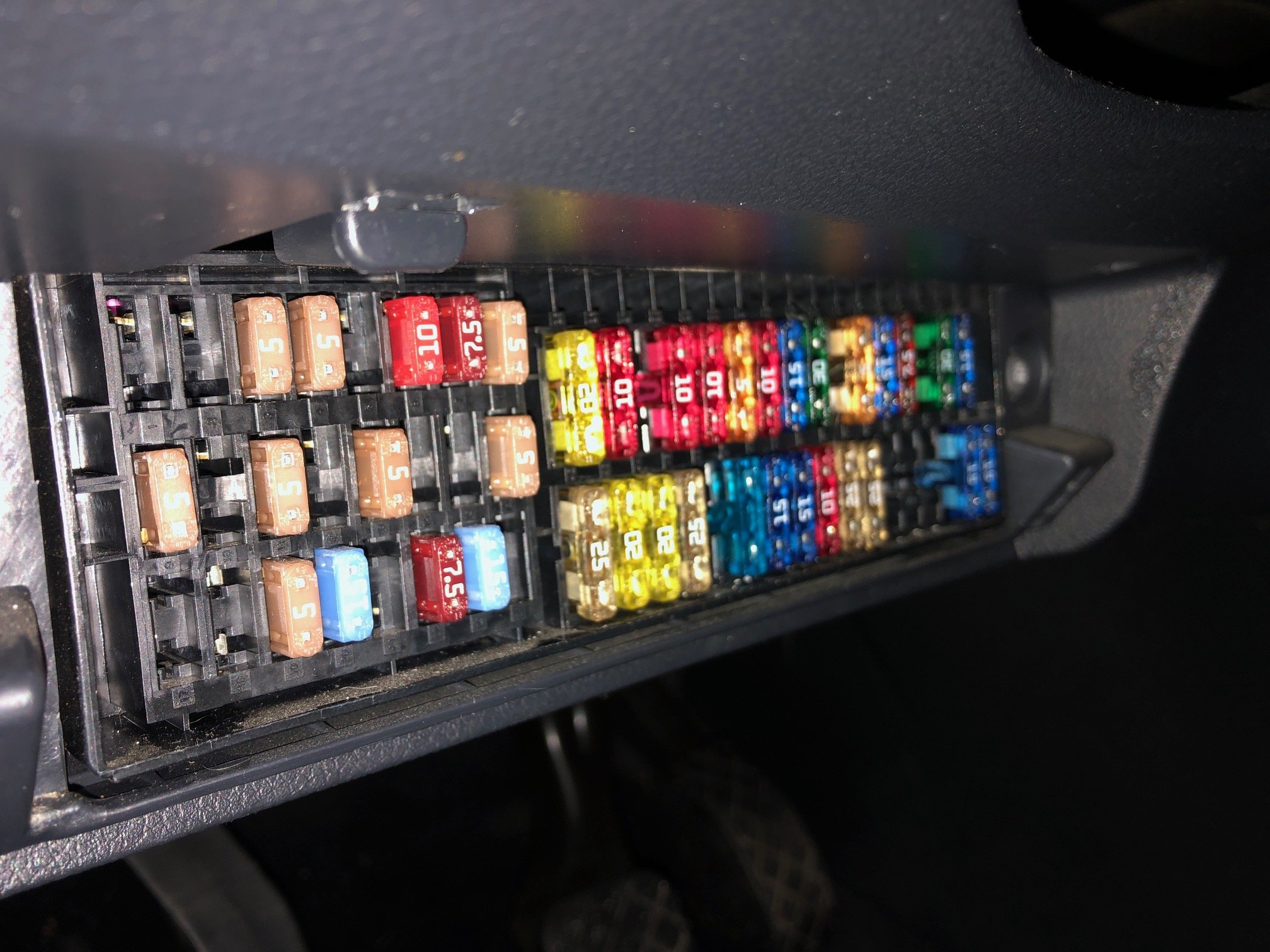

  2. The rear window wiper worked but not the hazard light and the battery was charged, so i am sure that it is not an alternator or battery problem.. What i would like to know is if there is any important fuses that is missing, as an exsample i am very much in doubt with fuse 24 , it is missing, should it be there in a 2010 1,6tdi manual gearbox? 24 Central control unit of the vehicle
  3. Hello, My Fabia is having electrical problems, it shut down while my wife was driving, first the dash board died then 30 sec later the car stopped.. The strange thing is that a lot of electrical things is not working, we cannot op en the trunk, hazard light not working and so on, but other things like the interior light and cabin fan is working, also front light is working.... My wife who was alone in the car thougt she could fix the problem by switching the fuses...!!!!! dammmnnnnnn !!!!!!!!!!!!!!!!!!!!!!! so now i am ended up with not knowing 100'% if the fuses are in the correct position... will you please look at the pictures and see if you can spot if there is something wrong with the fuses that is importent to run the car. Fabia 2010, 1,6tdi, https://fuse-box.info/skoda/skoda-fabia-mk2-5j-2007-2014-fuses-diagram Aircondition, heated side mirrors, cruise control, electrical windows, central lock, heated seats, rear window wiper, rear window heater,
