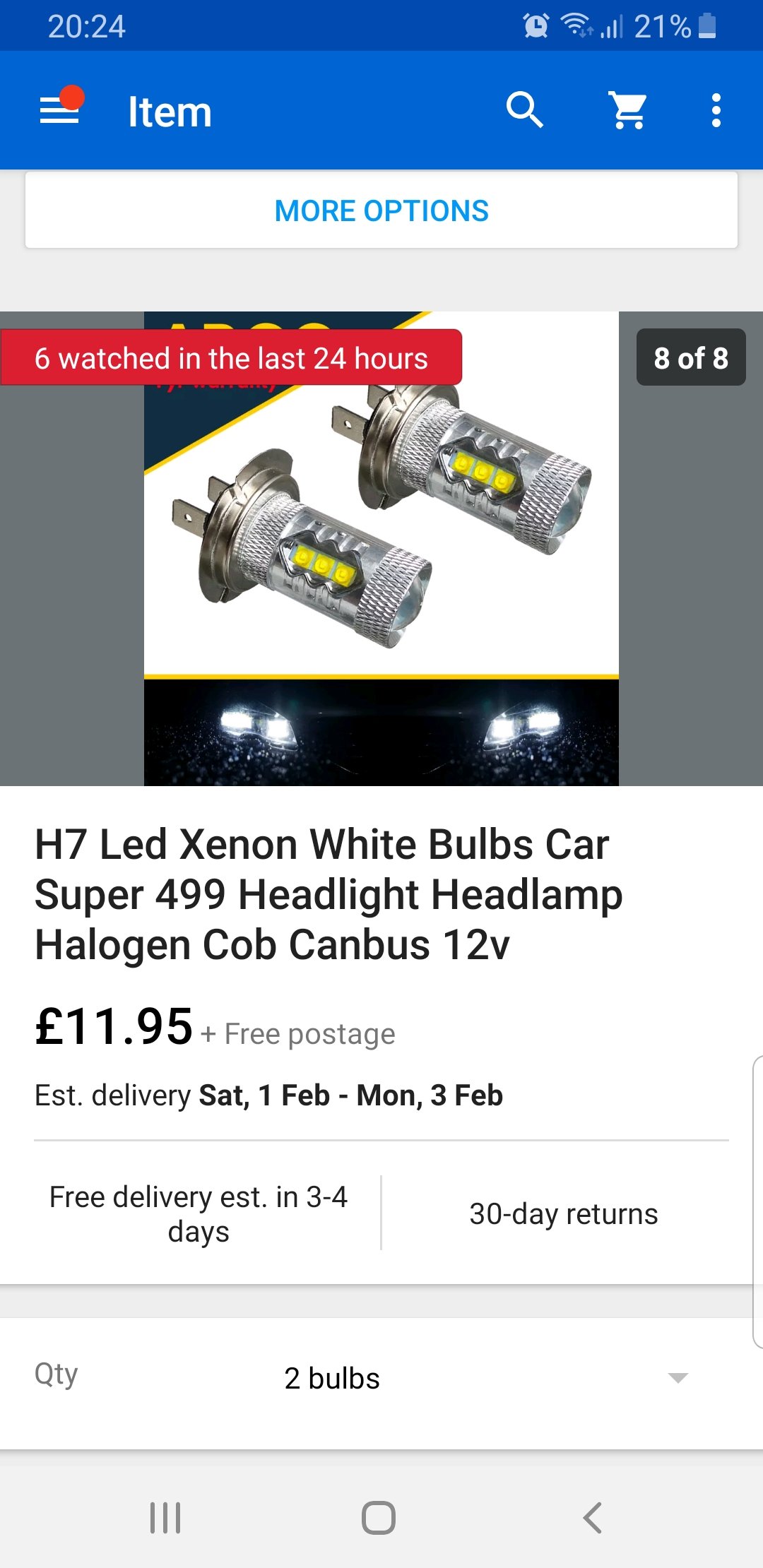

Thanks for the replies. Getting Xenons on the Karoq wasnt an viable option for us. The SE Tech doesnt even have them lol. She got a really good deal on the SE and the SEL etc are well into Tiguan money 🥴. Looks like we will have to stick those halogen ones in 🙄. She was happy with the light output from the standard bulbs. Just not the colour. I have fit HID kits with perfect beam pattern before tbh. Seems to depend on the headlight design. If the headlights have caps over the end of the bulbs (Mk5/6 golf etc) they seem to give a better beam pattern. But they wouldnt fit with the Karoq bulb holders either 🤦🏽♂️. Not used LED headlight bulbs before.. wont be again -

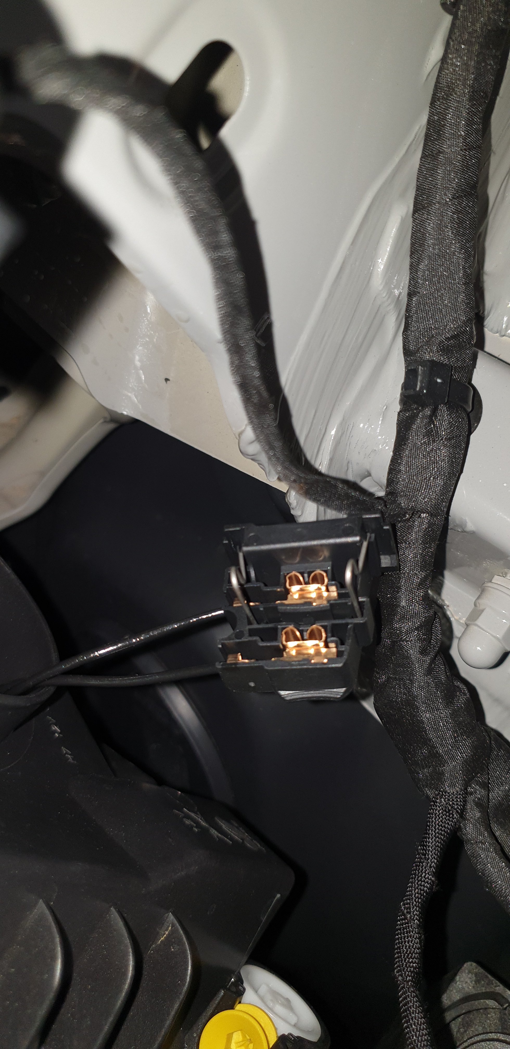

So my missus has just swapped her old Seat Ateca SE Technology (with LED/ xenon headlights) with a new SE Karoq. She loves the Karoq.. but hates the "yellow" halogen headlights. I ordered a pair of LED H7 headlight bulbs with seperate resistors for bulb warning lights.. (and LED sidelight bulbs to match) but the headlight bulbs don't fit. The headlight bulbs are held in using these plastic brackets (see pic). The 2 pin connector is part of the bracket (not a seperate plug like on the slightly older VAG cars). This means the usual decent LED headlight bulbs with seperate resisors don't fit. I have since fit some of the cheaper H7 LED headlight bulbs (see pic). They look good (nice clean white not chavvy blue) but the beam pattern is non existant so they just dazzle and dont light up the road. The ad said they had Can-bus resistors in them but they put the bulb warning light on aswell. I have removed them now. Has anyone found a decent bright white H7 bulb option that fits in the Karoq headlight bulb holders and doesn't put the bulb warning light on?
