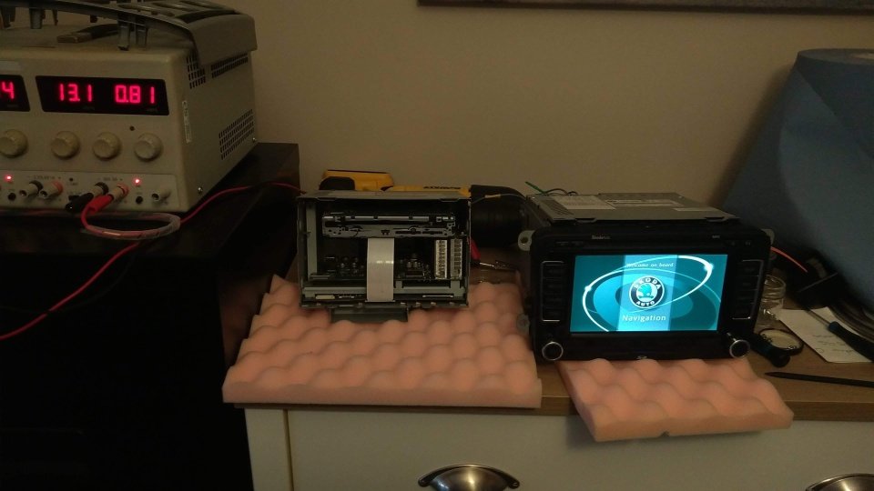

  1. I'm doing this to see if I can get a unit that I'd bought as spares (for the working LCD display module) back to working. It was freezing up at the security code prompt after booting, although did once start working properly (although it did eventually freeze again after an hour or so) so I was fairly convinced that it wasn't corrupted firmware as reported as being the cause of the lockups all over the internet, as it wouldn't have worked at all if that was the case. I managed to confirm that is was on F/W 5238 with map version 6317 while it was working. I expect a previous owner had updated it (or tried to), as the label on the top says HW: H04 SW: 1004. I've now swapped the HDD for an 80GB drive, re-flowed the Flash chips with hot air to fix any dry or cracked solder joints, re-updated to firmware 5238, and installed maps V3, and so far it seems ok. Will see if it's still ok tomorrow, after it's had a chance to cool down and reset itself. Is there a way of copying the maps partition from the old HDD across to the new one? Of the three partitions on the drive, only one is recognised by Windows, and it doesn't look like it has map data on it. Would Macrium Reflect's exact/forensic partition copy mode do it?

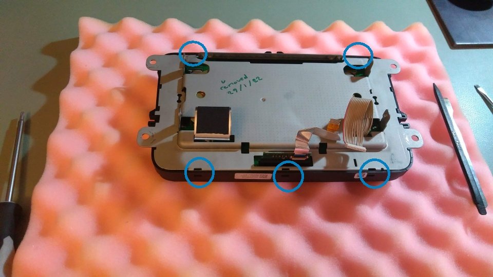

  5. I managed to find a donor on eBay with the freezing-up issue but with a working display & touchscreen; now nicely transplanted. So now I find myself with a spare locking-up main unit and a dicky display that could be fun to try to sort out Is there a recommended way of getting the metal backing plate off of the rear of the display module without breaking the plastic clips? Neither plastic surround nor metal tags seem to have enough give in them to easily release.

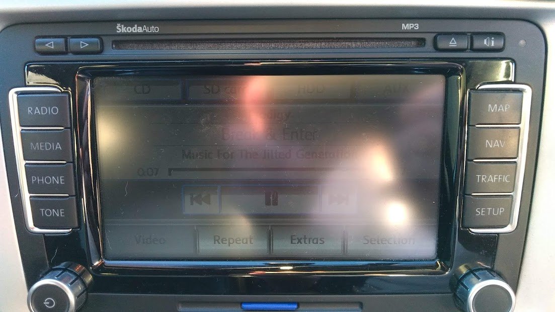

  7. I don't think red lighting would be right How much would you charge for the correct one?
