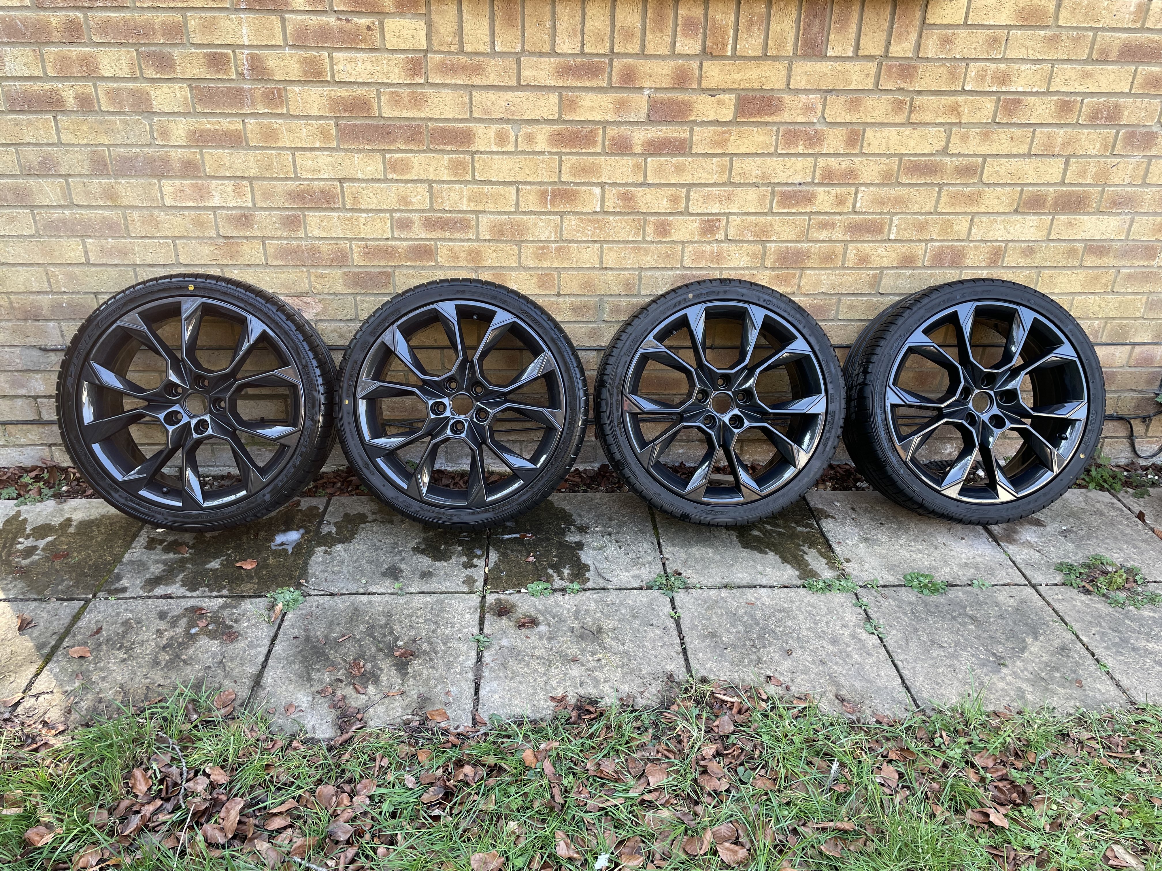

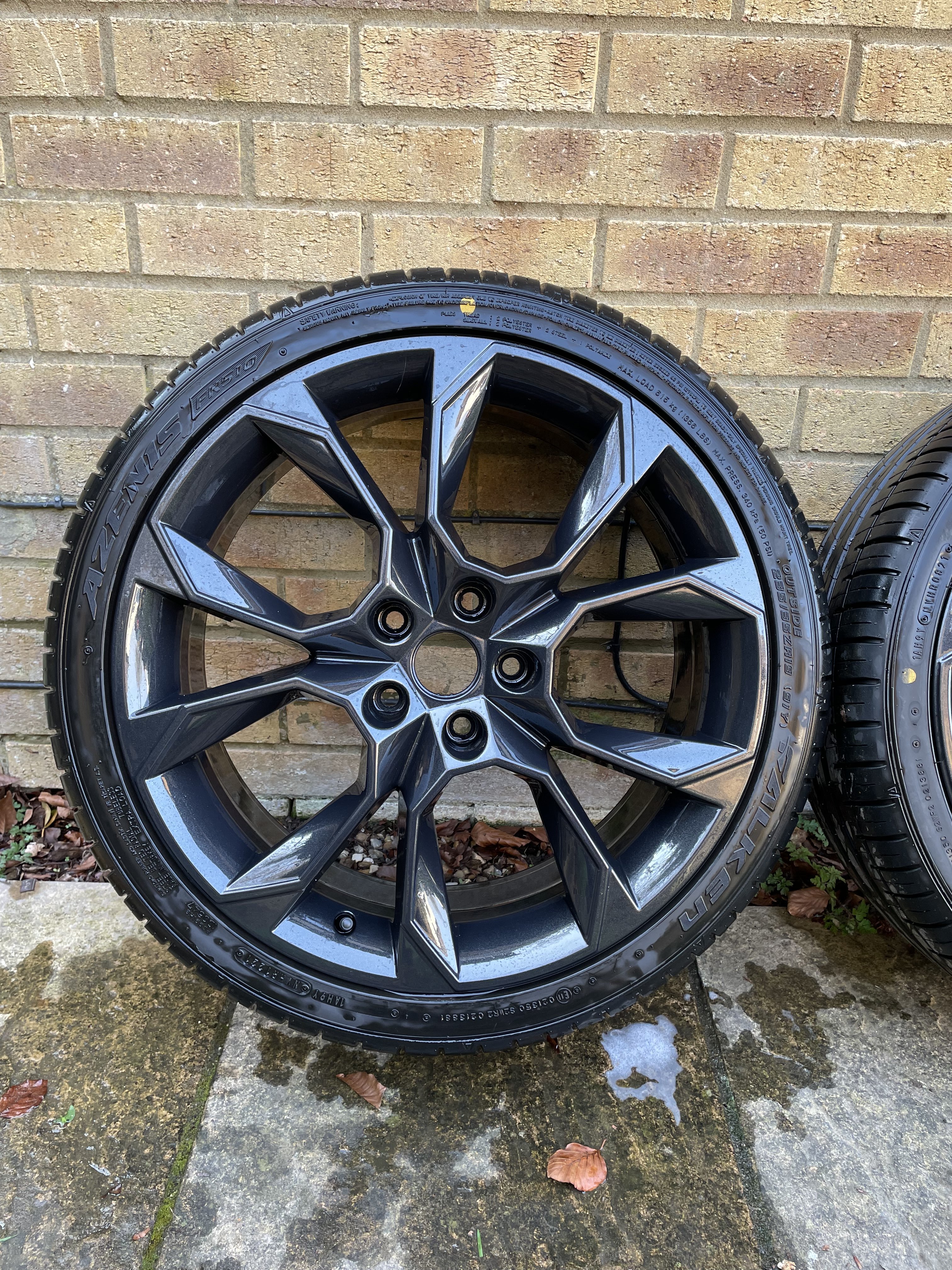

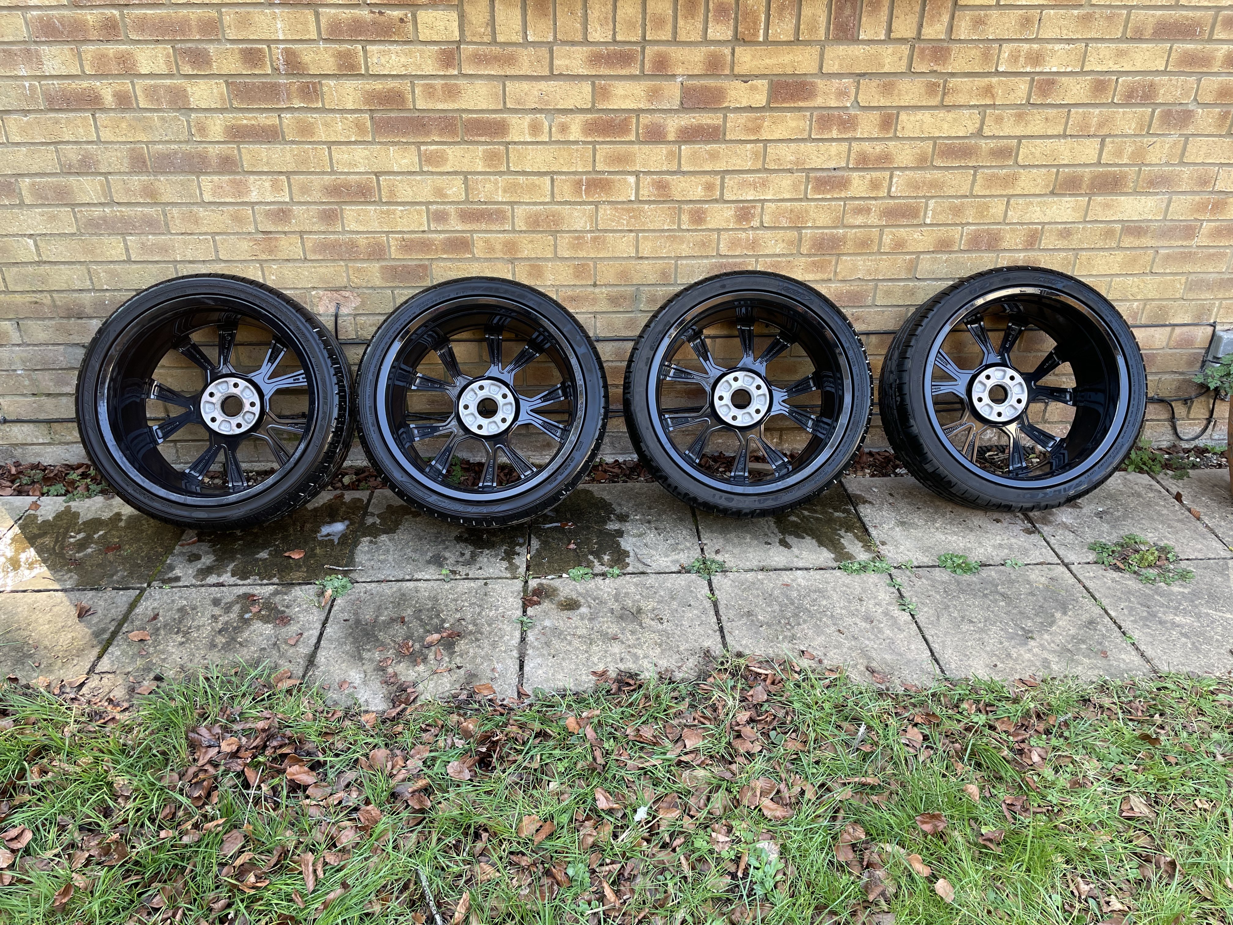

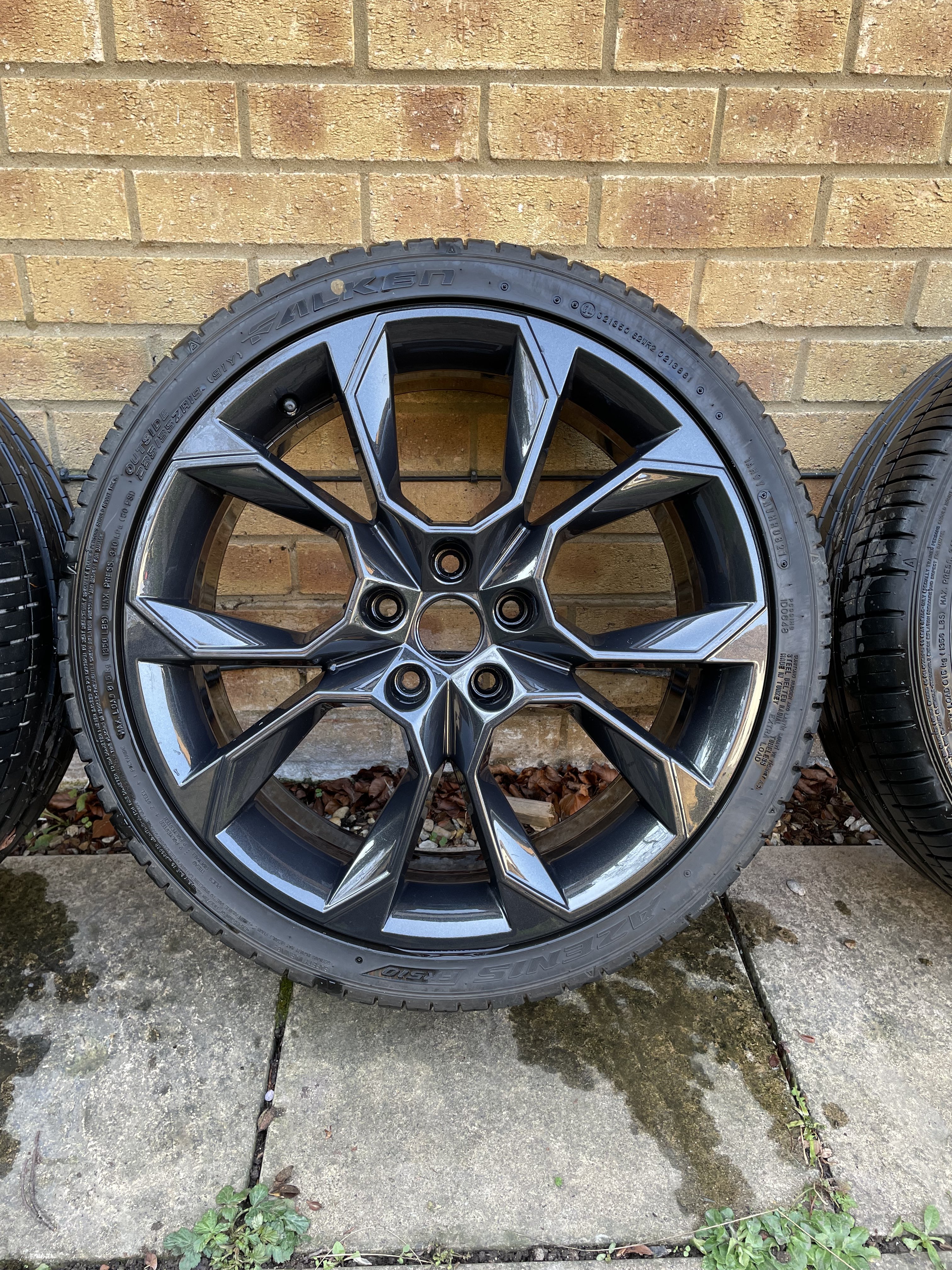

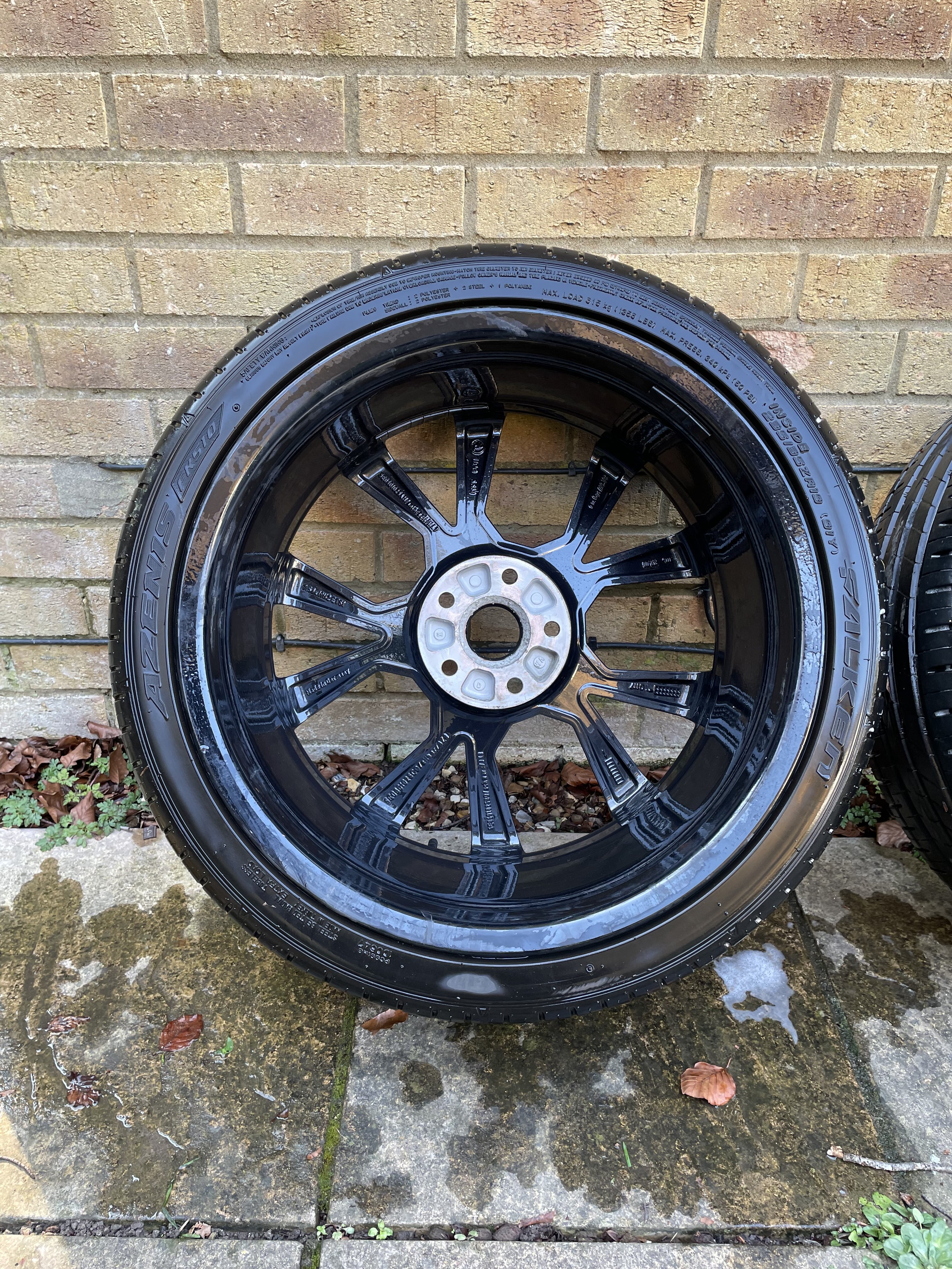

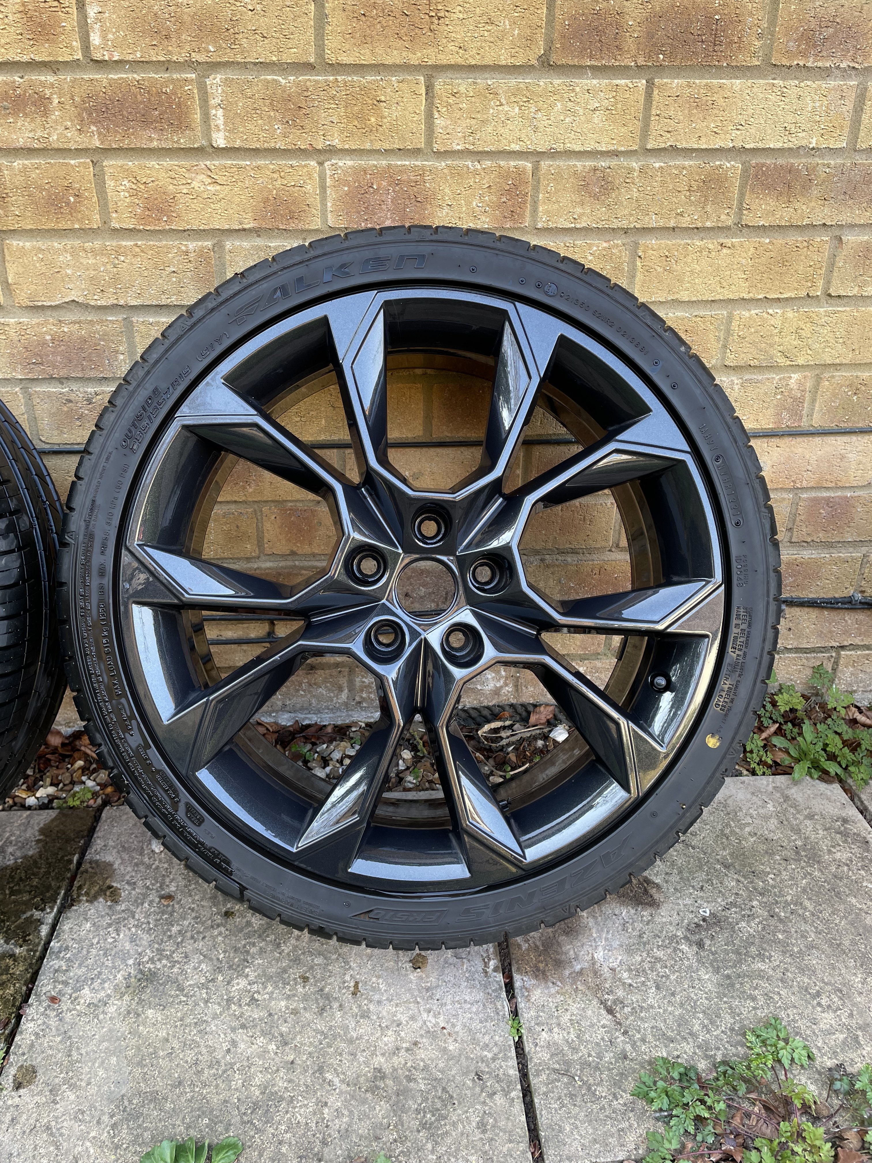

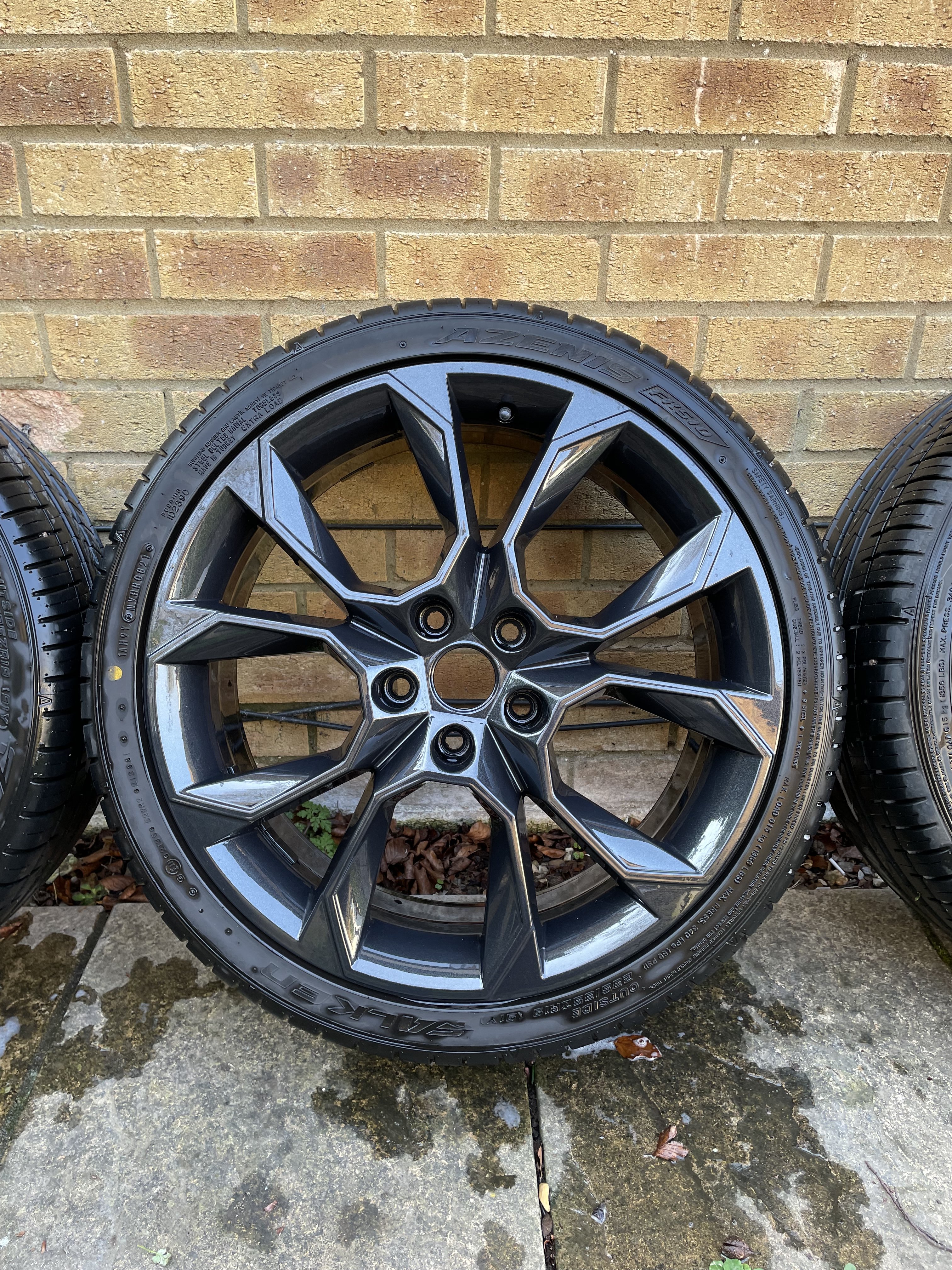

  12. Thanks, I saw a post on that earlier with pictures of what it looks like and where it is. If the sensor is inside it then looks like it needs a replacement ecu. Thats annoying! Appreciate the help.
