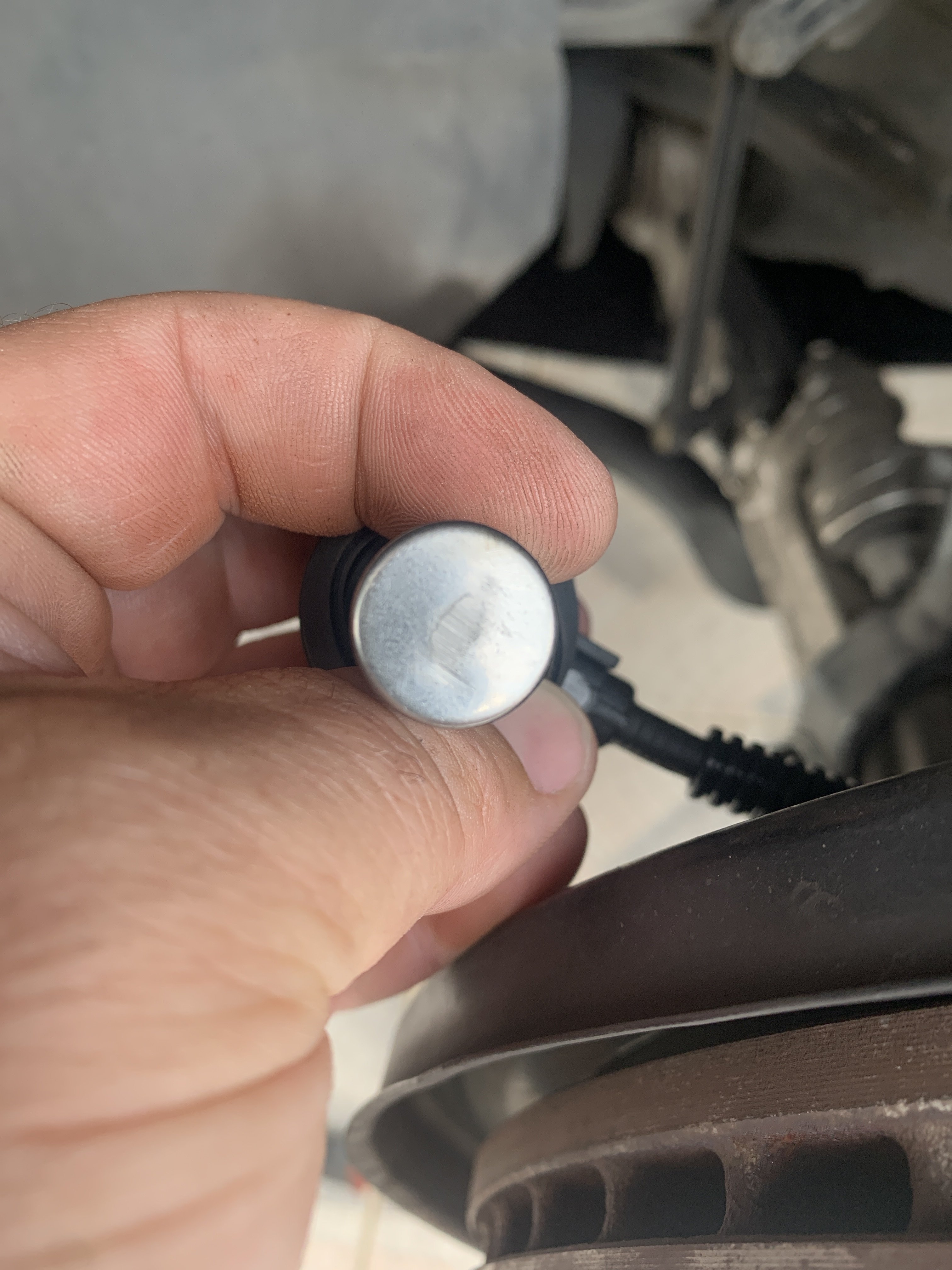

  2. I found this pic of the abs sensor, this was before replacing the bearing and it’s the original sensor:

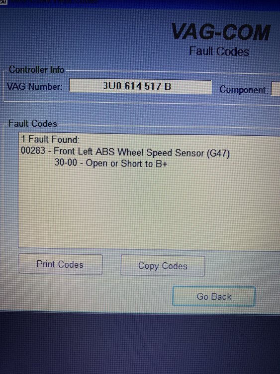

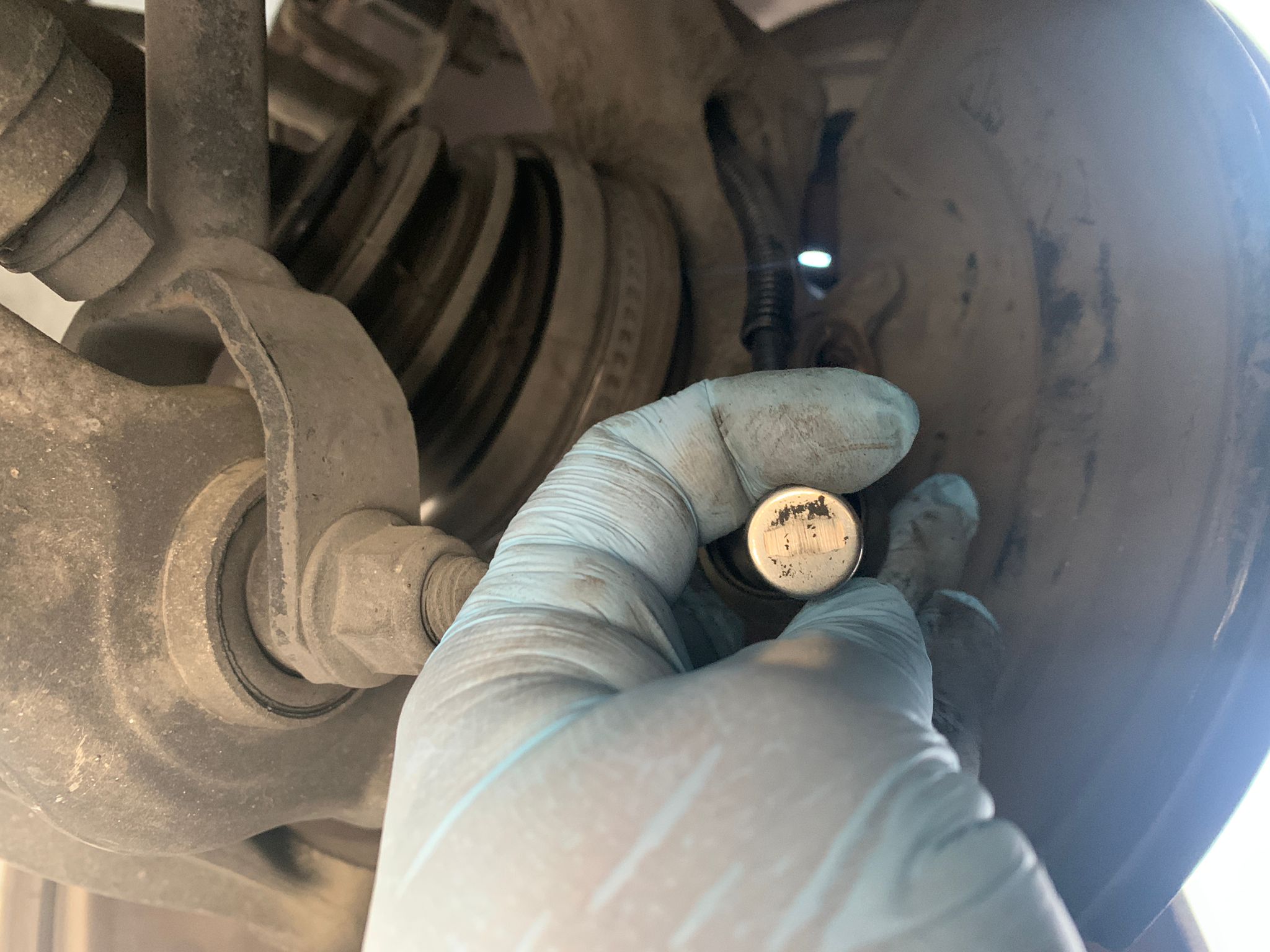

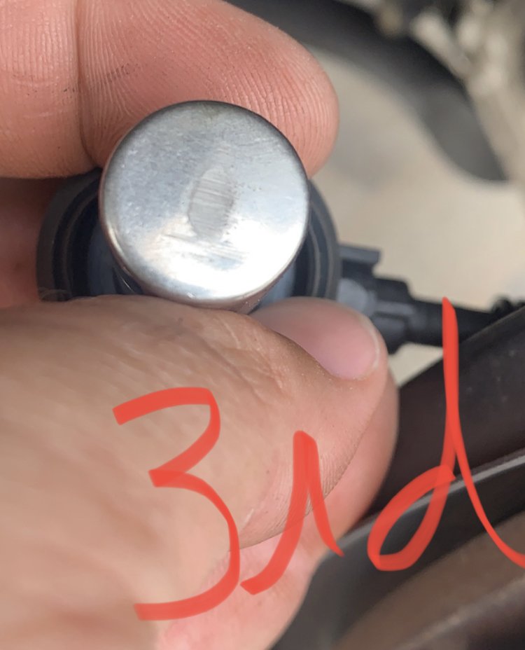

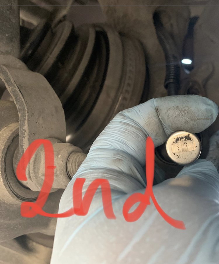

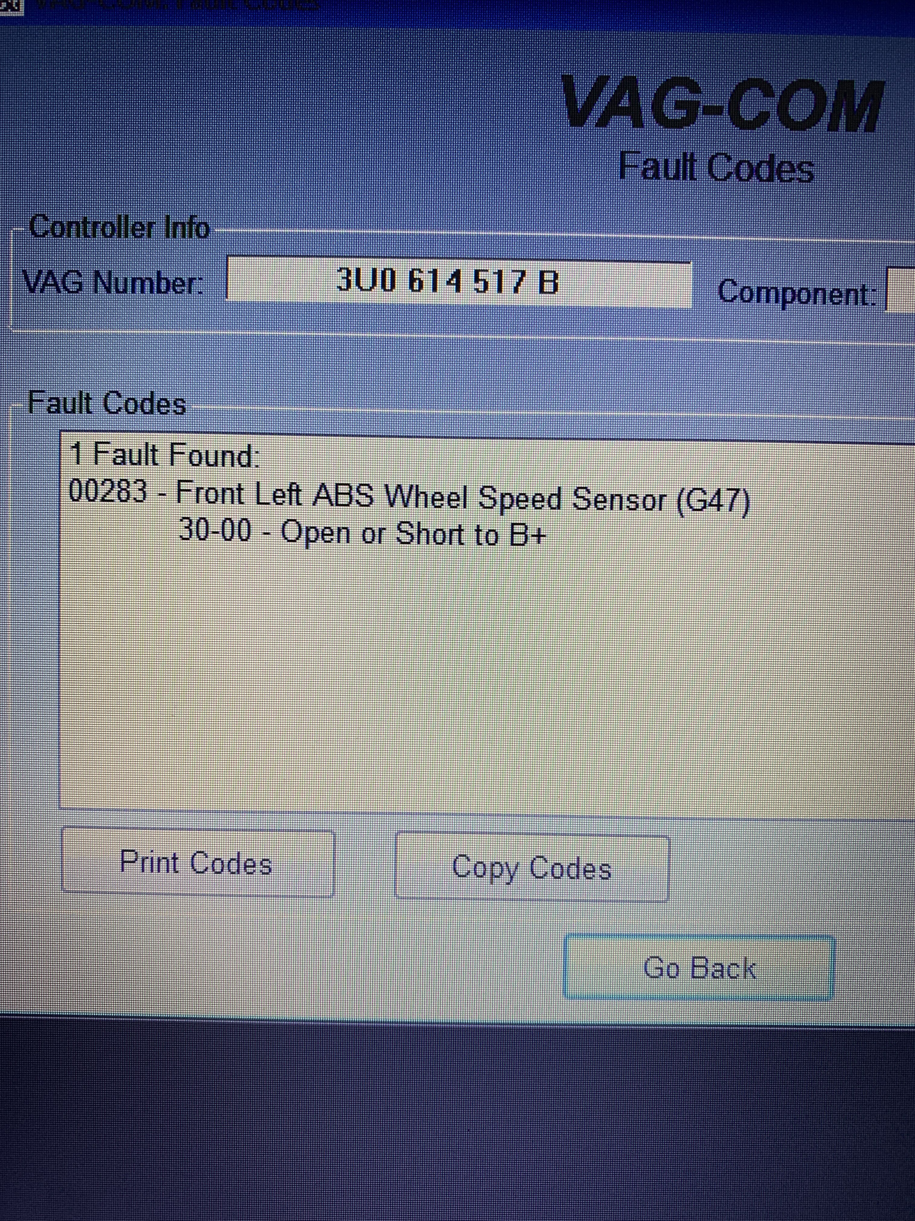

  3. Hey guys I replaced the bearing and replaced the sensor for the 2nd time. This is the third sensor and I think something is wrong with the track where it has the holes to read the speed. the sensors are like in the pictures and when I turn vagcom, it gives the error in the picture also. everytime I delete the error, lights will come again and also the error. I’m suspecting beside sensor is scratching the speed track, also it’s not a genuine sensor and for that, it causes the error. My experience with VAG parts says many parts that aren’t genuine, throw errors anyway. second sensor: third sensor: vagcom error:

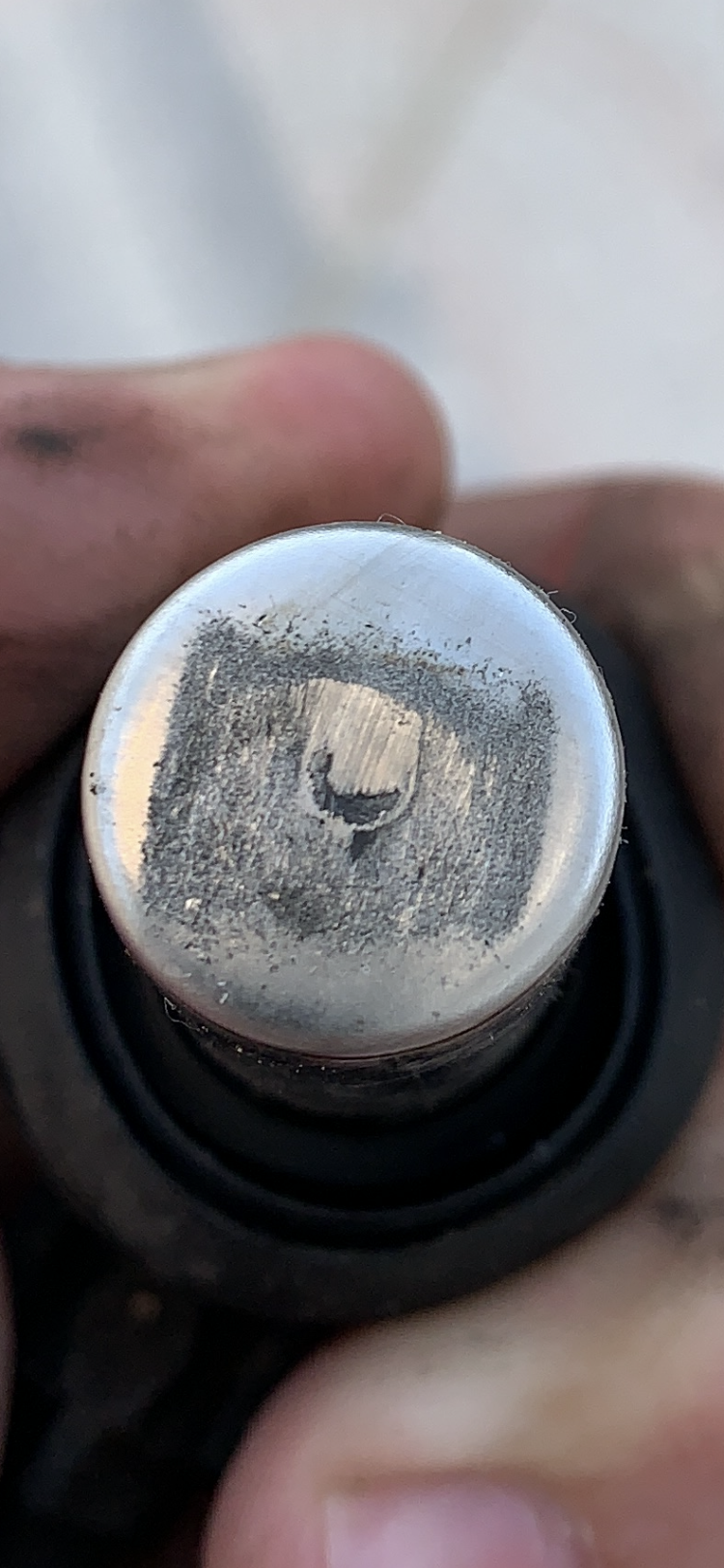

  5. Ok nevermind. The thing is I removed today the new sensor and it goes like this: how can I adjust the gap between the sensor and the wheel?
  6. Here it is but it’s a global thing, not Portuguese.

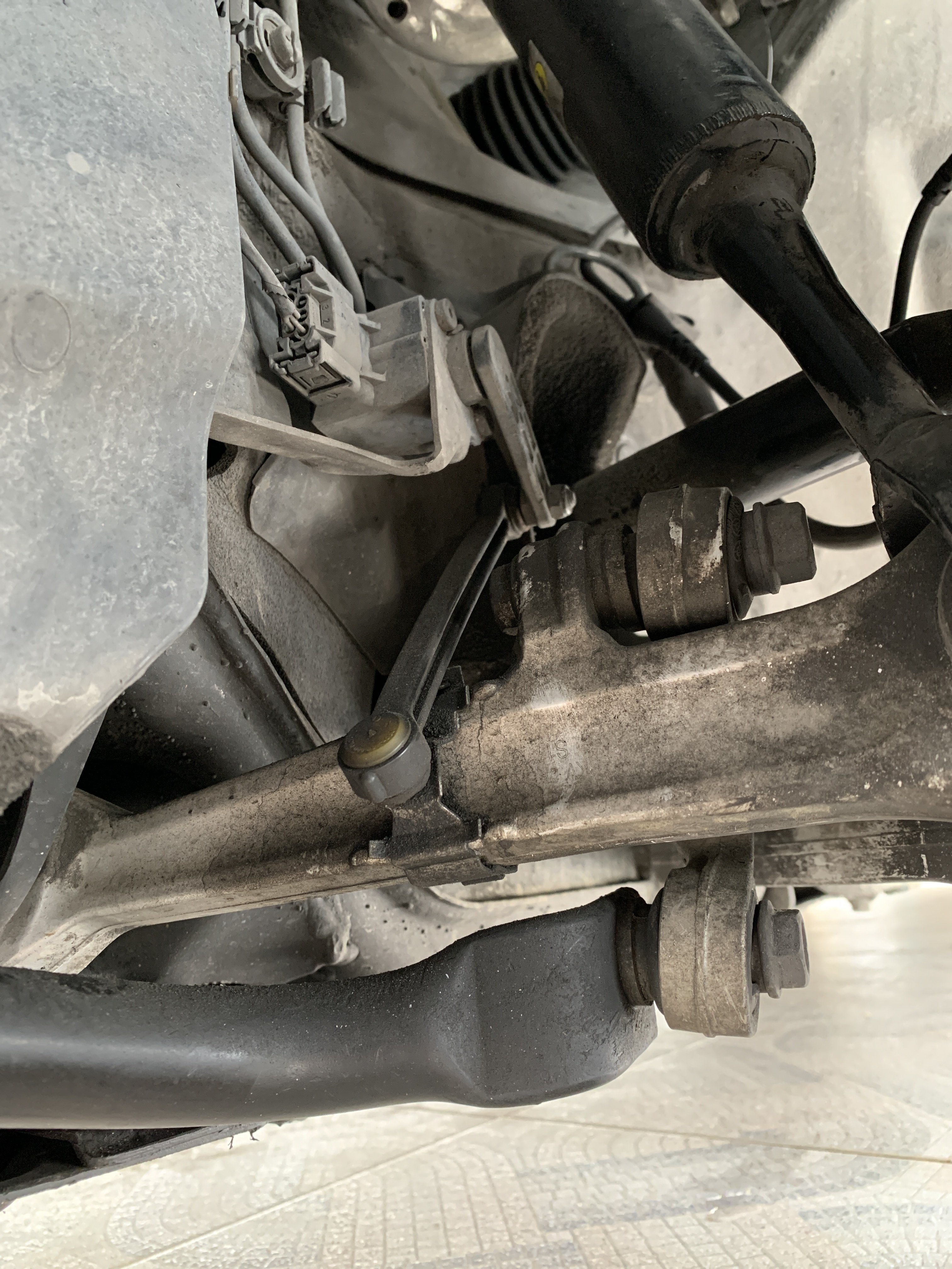

  8. Hey guys, I have two questions: just lowered the Superb with Eibach springs somewhere between 3-4 cm and now I don’t have headlight adjustment when I start the car not when driving? Is this normal? Can some send me a pic how the sensor is mounted? Because it may be a mechanic bad mount when they mounted the springs. (Please see pic to check if it’a correctly mounted) and my abs/tc light is on. First I’m hearing a noise for a while ago (maybe 3 years) specially from 100kmh which I believed was from the bearing. Then o got the abs/tc light, connected vagcom and it was front left sensor. Replaced the sensor because the stock one was scratched when i removed it. then I replaced a second time along with the bearing because the sensor was scratched again (please see pic). The roller noise keeps buzzing me, the abs/tc light sensor flashed again. My mechanic suspect the roller noise at high speed is from the tires (Toyo proxes t1r) which I doubt because the noise is like the sound of a fidget spinner.
