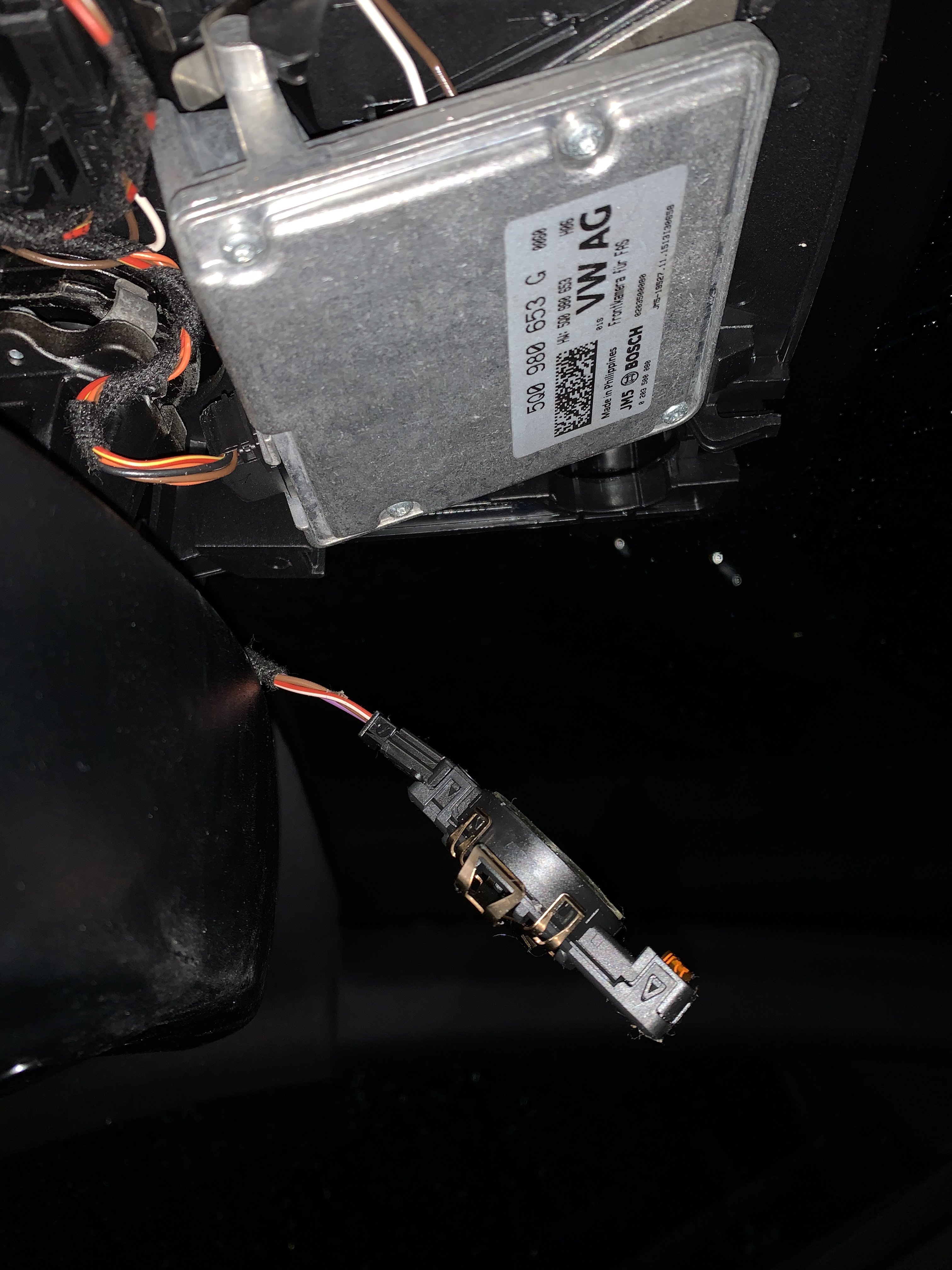

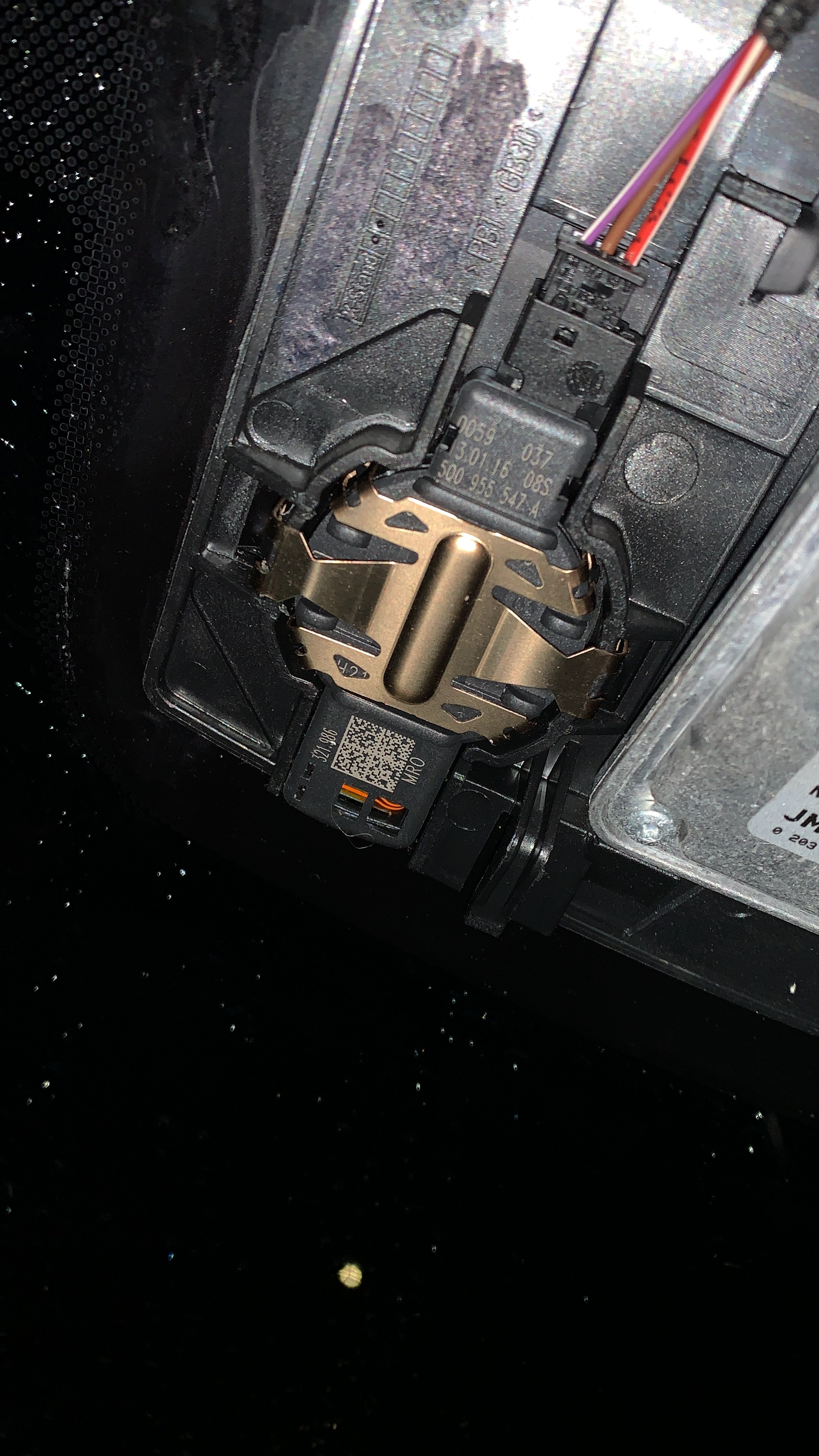

  1. Hello, so easy to change. I had to reattach mine had it had come off the screen. Have a hunt via Google for the workshop manual and gives you a full description on how to take the cover off. The tools is described can be exchanged for a knife or two
  2. Hello, thank you for your replies. So it came from a non Skoda dealer. They will be getting a bill. Yes I think a complete reset would be ideal. the interior lights work on all the other settings.
  3. Hello All, So I collected my used oct vrs last wednesday and very quickly I worked out the interior light didnt come on when the doors opened (even when in the correct setting), also the auto wipers were not working either. Again, set correctly on the tick boxes on the info system and and the stalk in the correct position too. So the car is covered by a 12 months AA warranty, so gave them a call and they booked the car into their VAG specialist (Auto Elite in Watford), so car dropped off, 36hrs later they inform me that someone has disabled both features on the car (by VAGCOM or something). The AA now know too the findings but waiting to find out who is going to pay for it to be put right. I have no idea why someone would do this, seems a little strange, when both systems can be switched off just by the user. Any thoughts would be welcome. Cheers
