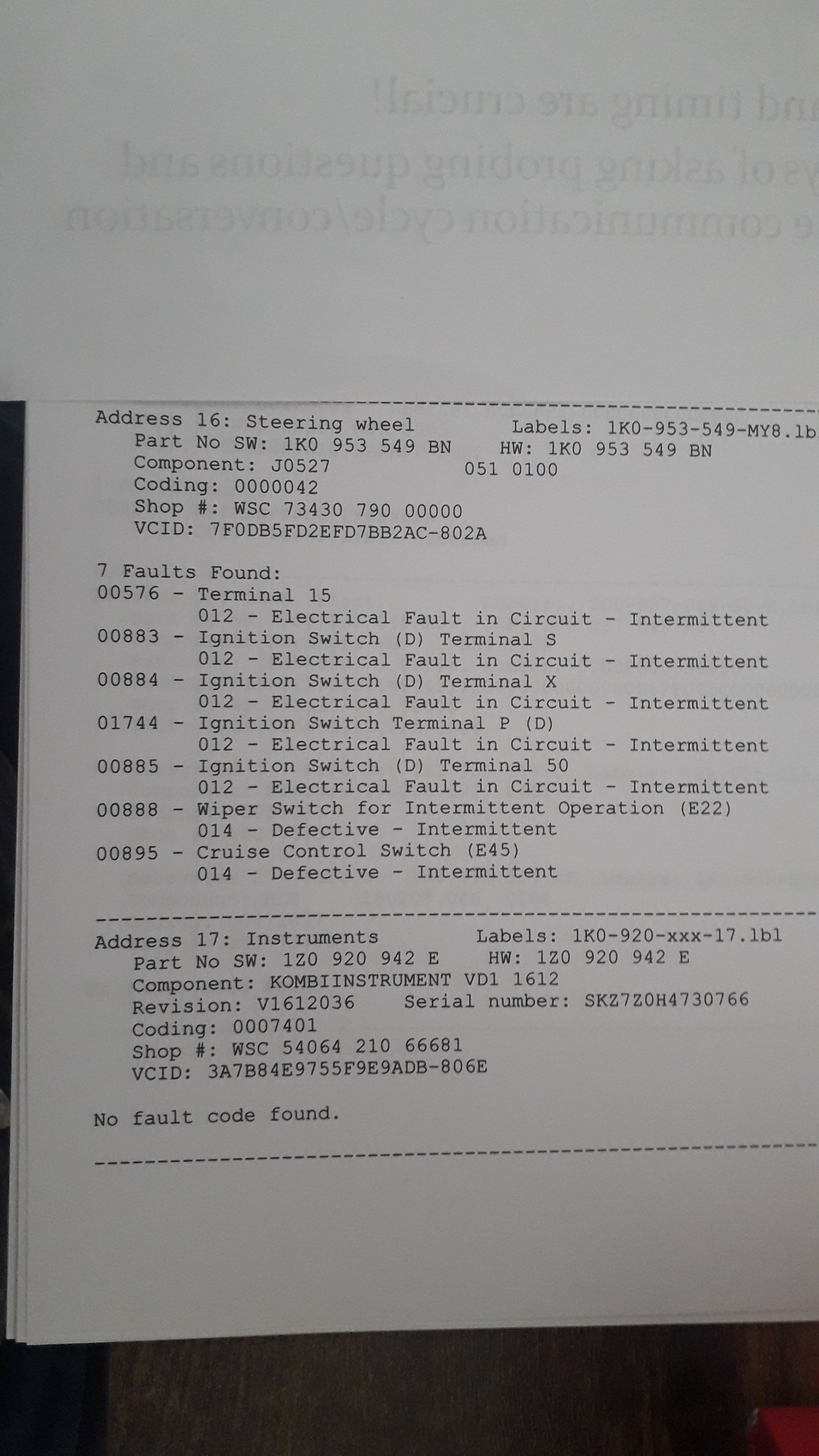

  1. Thanks for the information. Only ask as the part no 1K0 953 549 BN on the top of the address 16 is pointing to the steering wheel controller. Do you think they maybe a broken wire on the cruise control ???...
  2. Dose the ignition barrel require coding or is it plug in and go???. Just wondering if the steering wheel module is playing up???..
  3. Hello people. Could do will some help with my skoda octavia vrs 2008 tdi. Cruise control has stopped working. I have followed the nice institutions that are one here for cleaning the switch on the stork and cleared the codes but still no joy. I have done a full diagnosis check and these faults have been logged. Please see the picture. Many thanks
