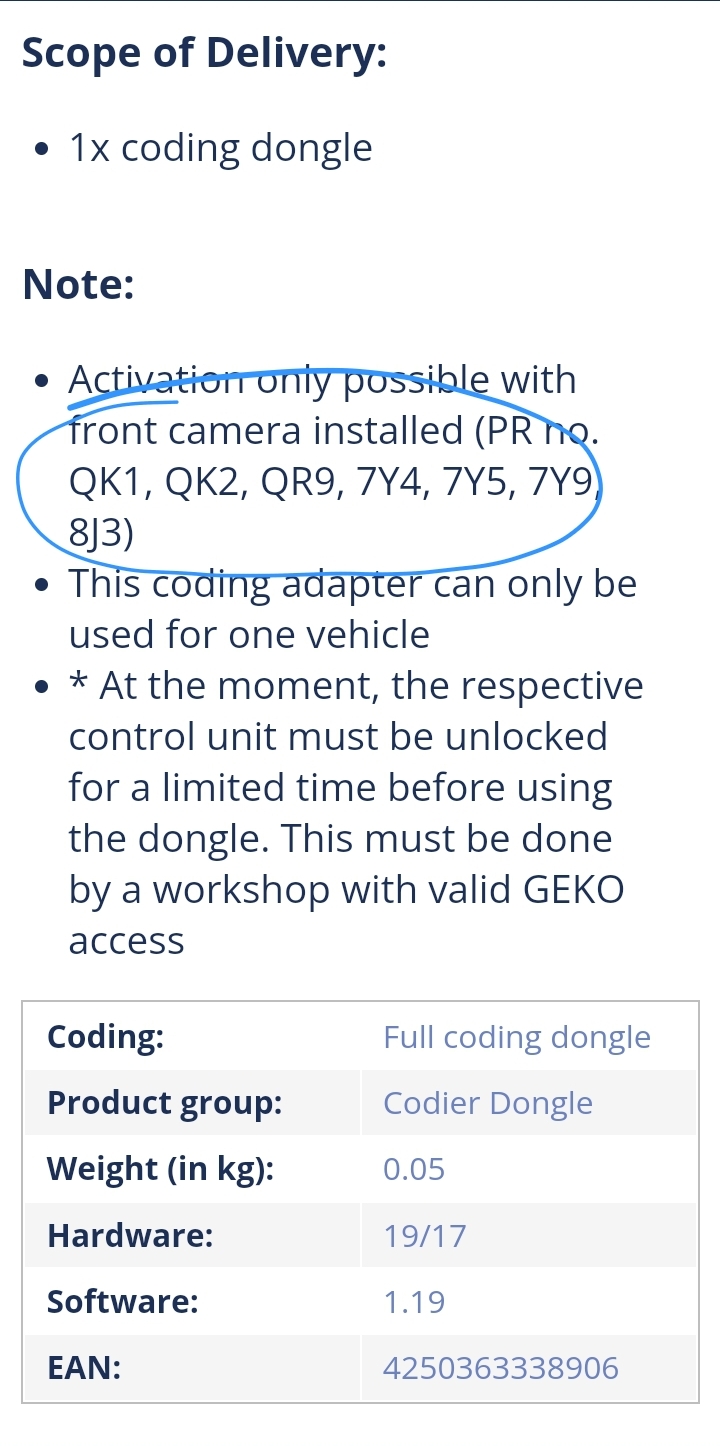

  3. Hey Langers2k... Can I ask...8f you had same build codes, did you just need the hba coding to work - ie we're all cables or whatever they use already looked to the headlights from camera? My dad said I wonder if they fit the vehicles with it but make you pay to activate? Sorry about typing spelling errors!

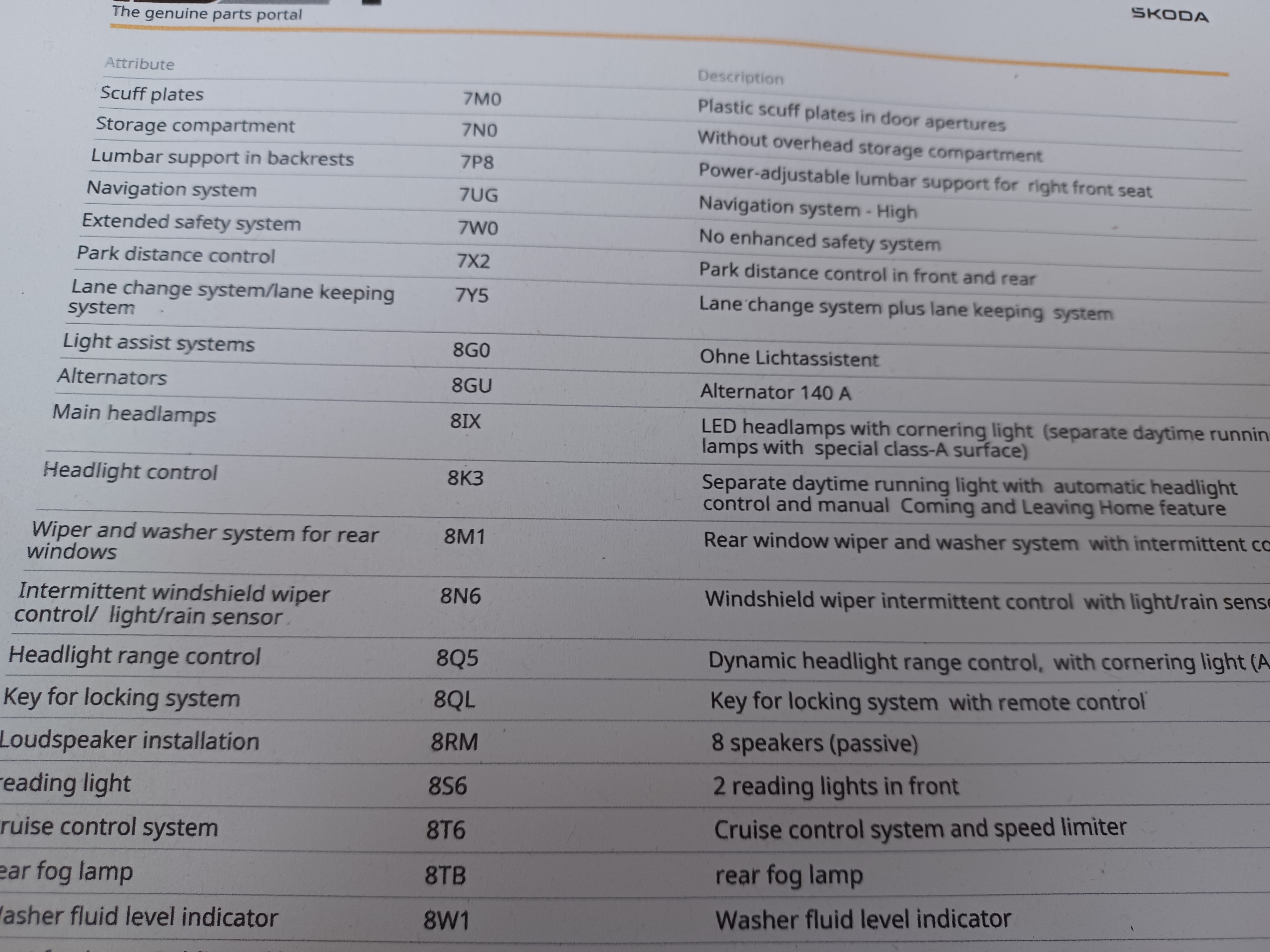

  10. Got an edition. .. cornering lights... home coming....
  11. Erm...have an edition...got cornering option , coming home ... auto on and adjust....just not auto on off high beam
  12. Thank you...I am confused as skoda have checked our vehicle and insist it can't be done as don't have right headlights capable :( I will reach out as you suggest. what skoda said... I wanted to follow up on your inquiry regarding the activation of High Beam Assist in your vehicle. After conducting a thorough investigation and consulting with our technical teams, I regret to inform you that it is not possible to activate High Beam Assist in your vehicle. High Beam Assist is a feature that requires specific headlights with the necessary hardware and functionality. These headlights must be installed at the point of manufacture, as they are an integral part of the vehicle's lighting system. Unfortunately, High Beam Assist cannot be added retroactively or activated in vehicles that are not originally equipped with the required hardware.
  13. Well according to skoda I don't have HBA and it can't be retro fitted as needs specific headlights and firmware.... Having looked on kufatec it seems they have some dongles but also internal mirrors and cabling? What I can't figure out is I have the camera, road signs, auto dimming mirror and some of the other codes they list..what I actually need or whether I should just knock the whole idea in the head! Anyone actually successfully added HBA to a karoq?
