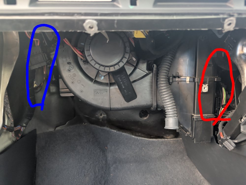

  7. Red is where the V68 module is located and blue is where the V154 module is. I hope this helps someone in the future.
  8. Hello everyone, I know this is an old thread, but I wanted to share a solution I found for a tricky HVAC issue that might help others. I had a problem with my car's climate control, specifically with error codes related to the V68 and V154 actuator motors. First, let's clarify what these are: V68: This is the temperature flap motor that controls the temperature of the air coming into the cabin. V154: This is the recirculation flap motor that controls whether the air is taken from outside or recirculated within the cabin. My initial issue was with the V68 module (part number 0 132 801 207). A new one was way too expensive, so I took a chance on a different but similar part (0 132 801 357). The connector was different; it was a rectangular one instead of the oval one I needed. Fortunately, it came with a wiring pigtail, which allowed me to confirm the pinouts were the same. Here's how I handled the wiring: I carefully removed the wires from the old oval connector on my car's loom. I then removed the wires from the rectangular pigtail that came with the new module. Finally, I inserted the wires from my car's loom into the new rectangular connector. This fixed the V68 issue, and the motor came to life. However, I was still getting V154 error codes, and the V68 module was only working at maximum hot or cold settings, with no in-between. This had me scratching my head for a bit. After some more searching, I realised the problem was that I had two separate issues, not just one. I found the V154 module, I already had a spare part for this since I had accidentally bought the wrong one for the V68 initially. I swapped out the V154 module, ran the basic settings adaptation using VCDS and everything started working perfectly. The main takeaway is that if you're getting multiple HVAC codes, you might have more than one failing part. Don't assume a single fix will solve all your problems! But if I'm being honest I wonder if the V154 was the issue module all along as it seems like they work in tandem.
