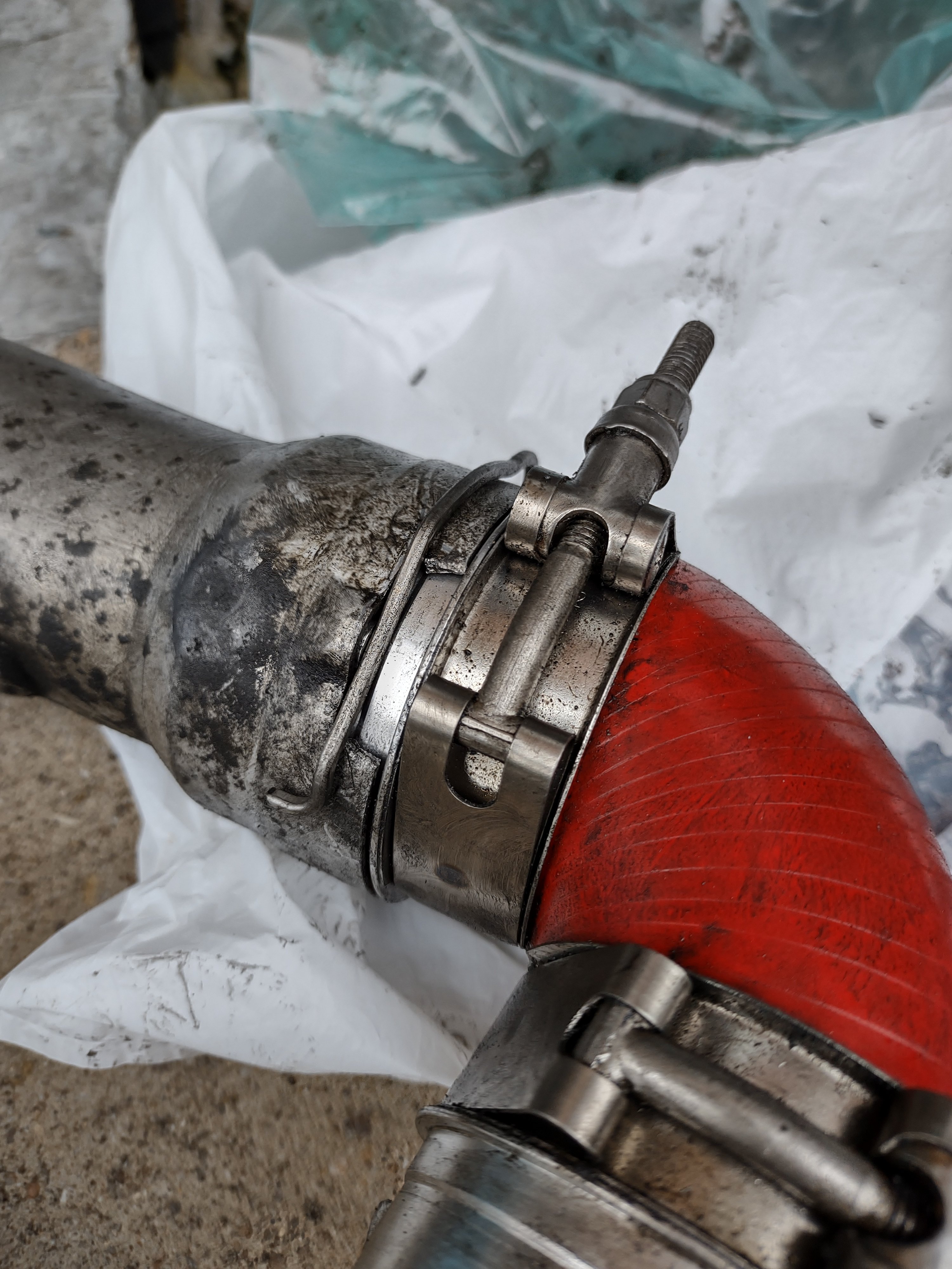

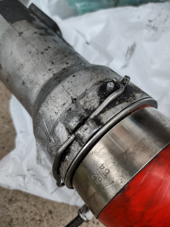

  3. For anyone whos interested, see attached photo for broken Vs not broken. I ended up wrapping a few loop of thick gauge wire round it to act as a latch stop. Not my prettiest fix and I'm sure I can have wire locked it better but car has been on the road for 2 weeks with no issue.

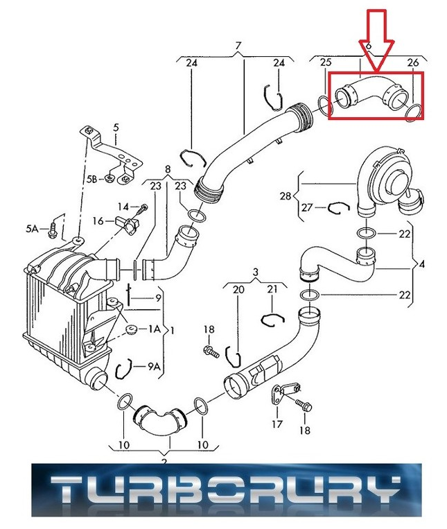

  4. Hi all This morning the bottom intercooler pipe came loose. Not the usual 90deg bend one (part #2) that failed but the metal connecting pipe (part #3). The tabs on it snapped. I suspect because I brought a reinforced 90deg bend pipe years ago, it now failed at the next weakest joint. Does anyone know if I can get an aftermarket pipe to replace that whole 3-pipe section (part #2, #3, #4) from the intercooler to turbo? Don't mind an one piece hard metal pipe replacement, at least less points for it to leak. WOuld consider replace part #6, #7, #8 if not too expensive. I had a look and ones I seen are either silione hoses or metal but designed for a specific, aftermarket intercooler for power gain. I like to retain the original one and just replace the pipe. I am also considering using self tapping screws but want to explore all the options first. Thanks.
