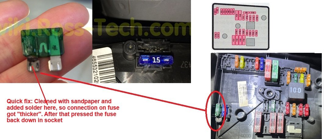

  1. Skoda Octavia II Combi 2010. Got same issue with lights in the front (right side) and light on the back left side not working. After lots of studying electrical diagrams, finally figured out it was a bad connection in the fuse socket for F16 in the Engine compartment fuse box. See this link above: http://wiki.ross-tech.com/wiki/index.php/00927_-_Terminal_30_(Right) Quick fix: Solved it by adding "solder" on the fuse connection, see above
