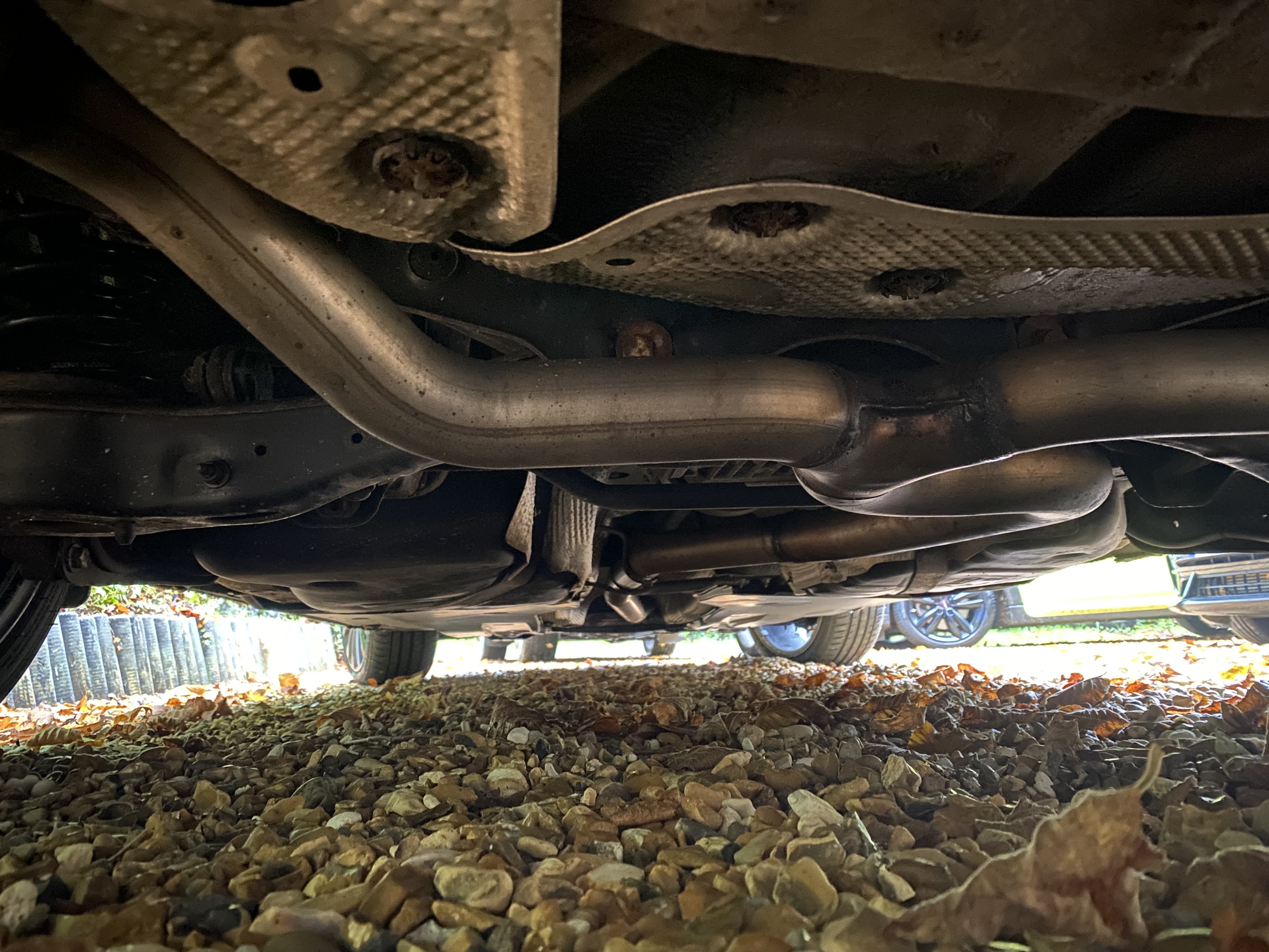

  8. Thanks for the pic. Here is the best I can do under mine looking from back to front. This is a 66 plate so I think it has the 272 engine, is that any different. The tyres are all new with only 1000 motorway miles so doubt they have developed uneven wear. Can’t get out to a decent length of 70mph road at present but from memory the drone disappears at around 3000+ rpm. Hope this helps and very interested in any ideas?
  9. Getting a drone from just under 70 to a “little” more, this is at around 2600 rpm in 6th, very annoying and does not happen at other speeds. This car a new to me so I suspect it may have a resonator delete or coded exhaust valves to open. Also the joiner is letting by slightly. How can I tell, what does the resonator look like? Thanks!
