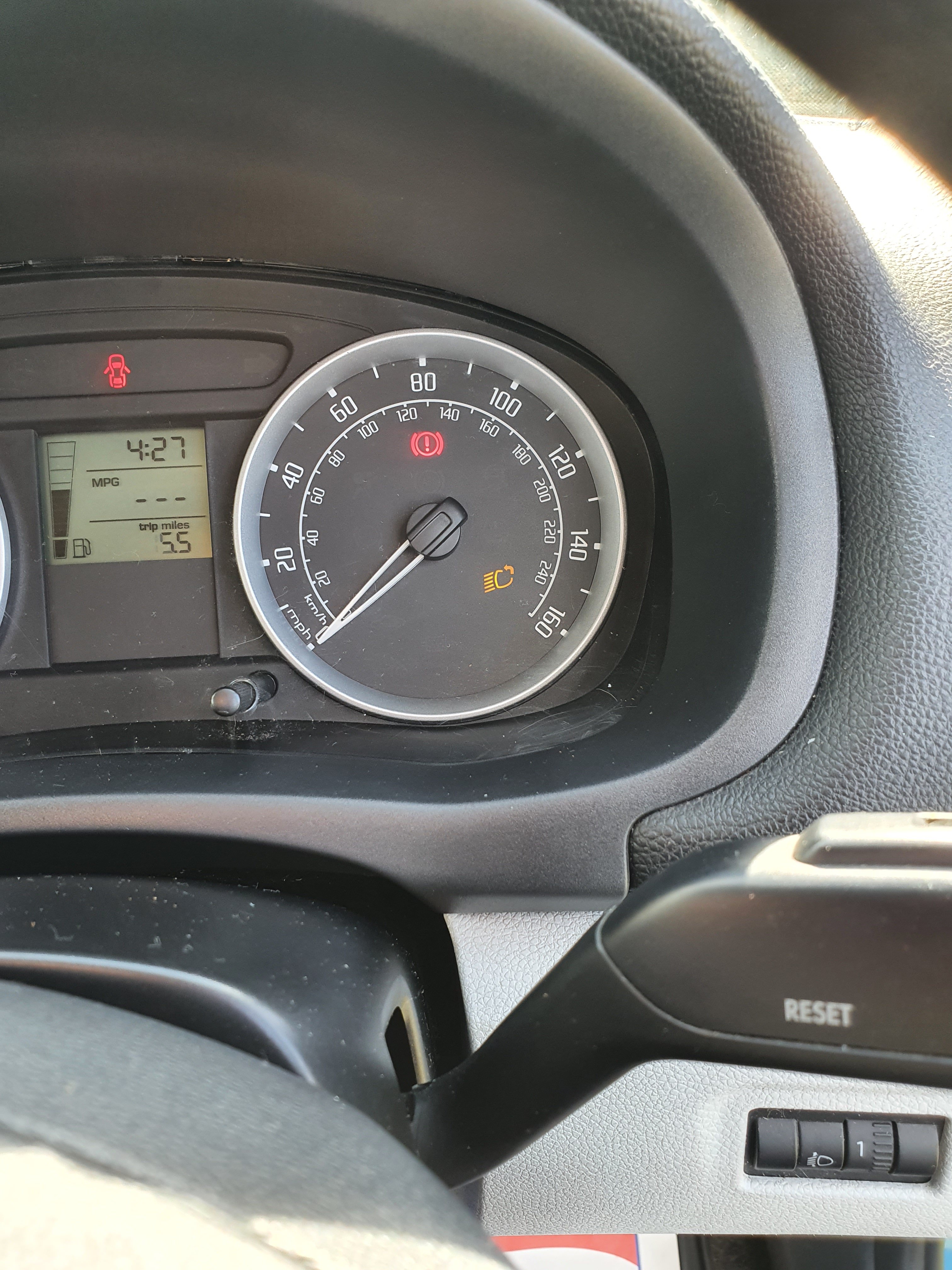

  4. Update indicators back blinking and clicking on the dash today but now have turning light flashing but I don't have turning lights plugged in no codes on my basic code reader

  10. Ok will changing out the whole dash help. Will have to do more digging
  11. Ok thanks I've sorted the the brake lights it was the brake light switch sticking so replaced that lights working good now just the indicators to sort No just standed bulbs
  12. Indicators work all round outside of the car just no blinking or clicking inside the car it's very strange
  13. hi all, i have a mk1 2007 roomster 1.9 tdi with a couple of problems which are, 1, all 3 brake lights are not working i have checked bulbs and fuse and are all ok. 2, no indicators blinking on dash but are working outside. any help or ideas would be great thanks for looking
