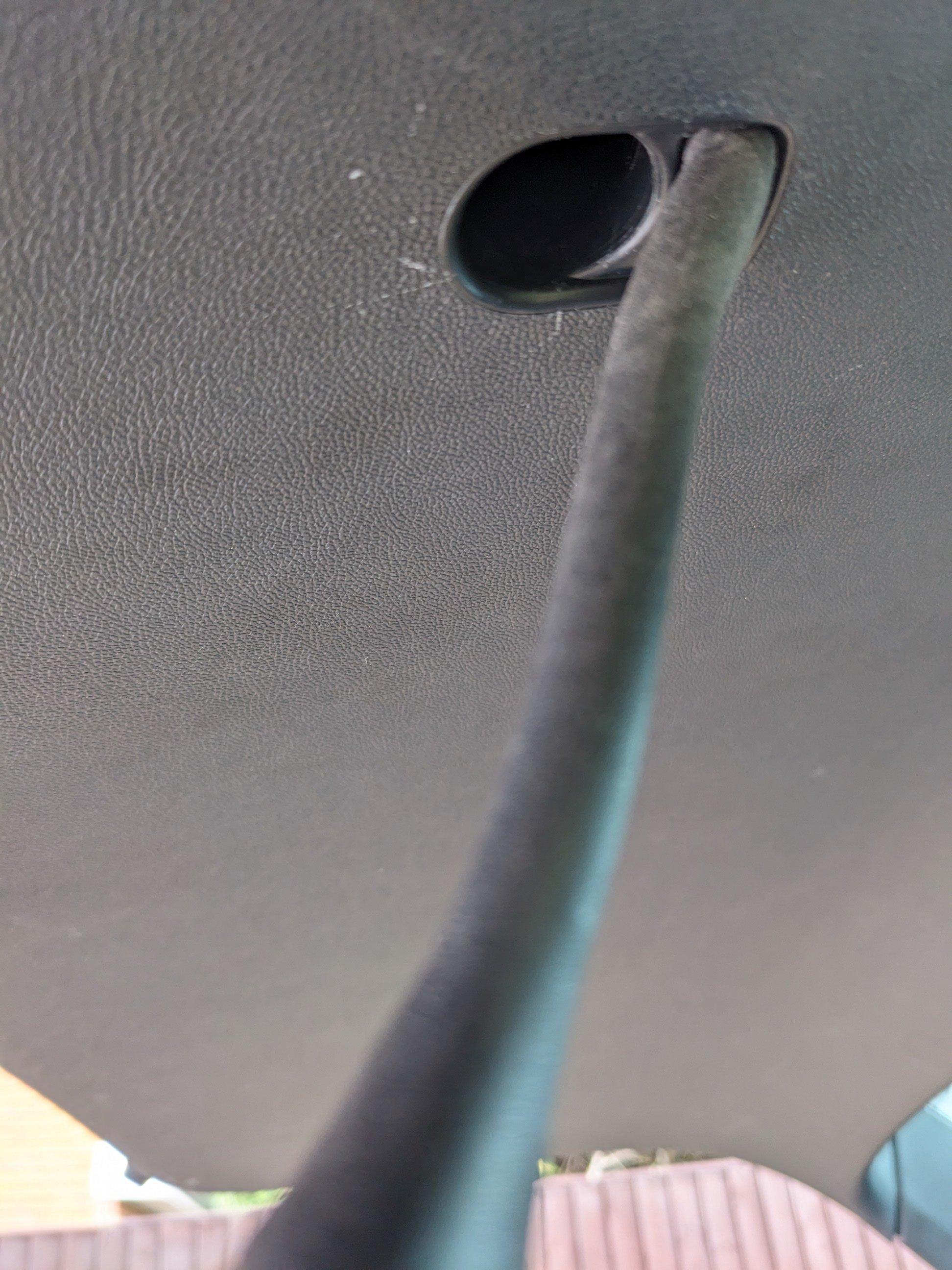

  1. Thanks for your kind words. FYI: The handle is the same shape as the parts daigram baove. I meant to photo it before I put it back in, but forgot.

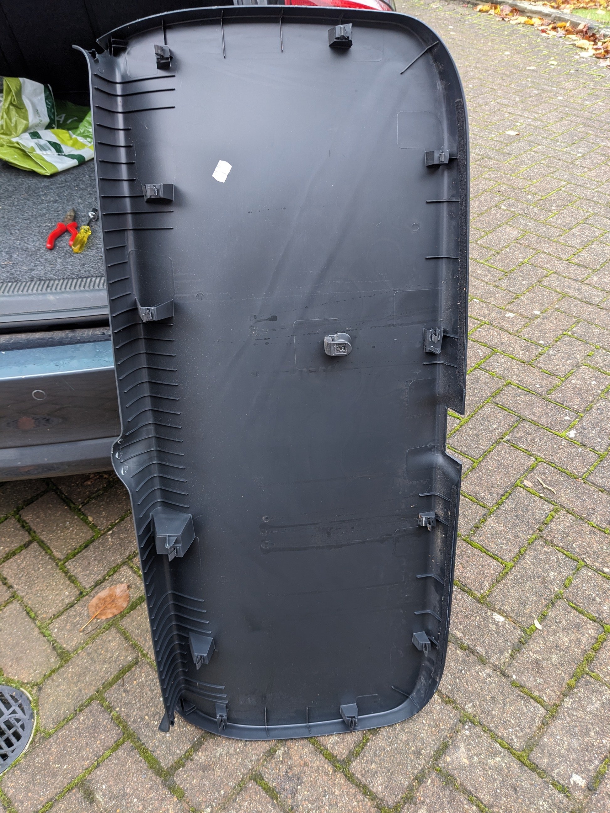

  2. Now that it’s finally stopped raining, I’ve been able to sort this problem out. Given that the pull handle was intact. i.e. the screw hole was not torn, I decided it must have not been attached properly by the single torx screw that held the large trim panel in place. Then I membered I had removed this trip panel some time ago to access the third brake light. When I replaced the trim panel, although the pull handle appeared to be in place properly, it must have moved slightly as the dozen very stiff clips were cajoled – forced – back into place. That meant when the trim screw went back in, it did not go through the pull handle. As the handle is a very tight fit, it stayed put for months before pulling out. Intact. So I just managed to fiddle it back into place through the hole next to the trim screw recess and put the trim screw back in, capturing the handle. Sorted. Fortunately I did not have to remove the trim panel to do that – that is a job I would advise people to avoid of possible. Two photos attached. One showing the underside of the trim panel when I removed it months ago – in the centre you can see the recess for the screw sticking up, and next to it, the hole that the grab handle goes though (handle is in place, but on the other side to the panel). And a photo of the handle back in place today, up close to the trim hole. Thanks for the help. Hope this helps someone else.
