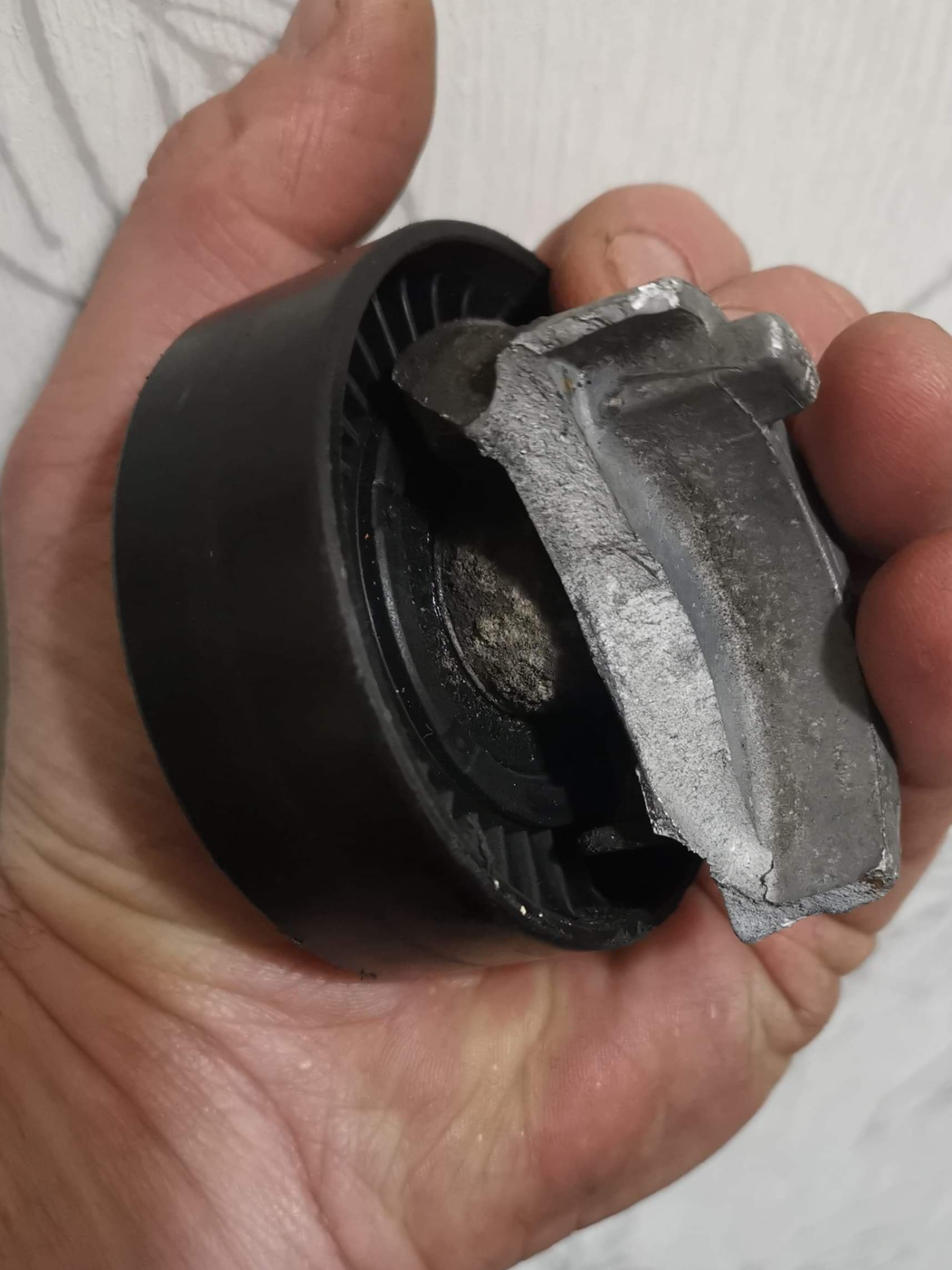

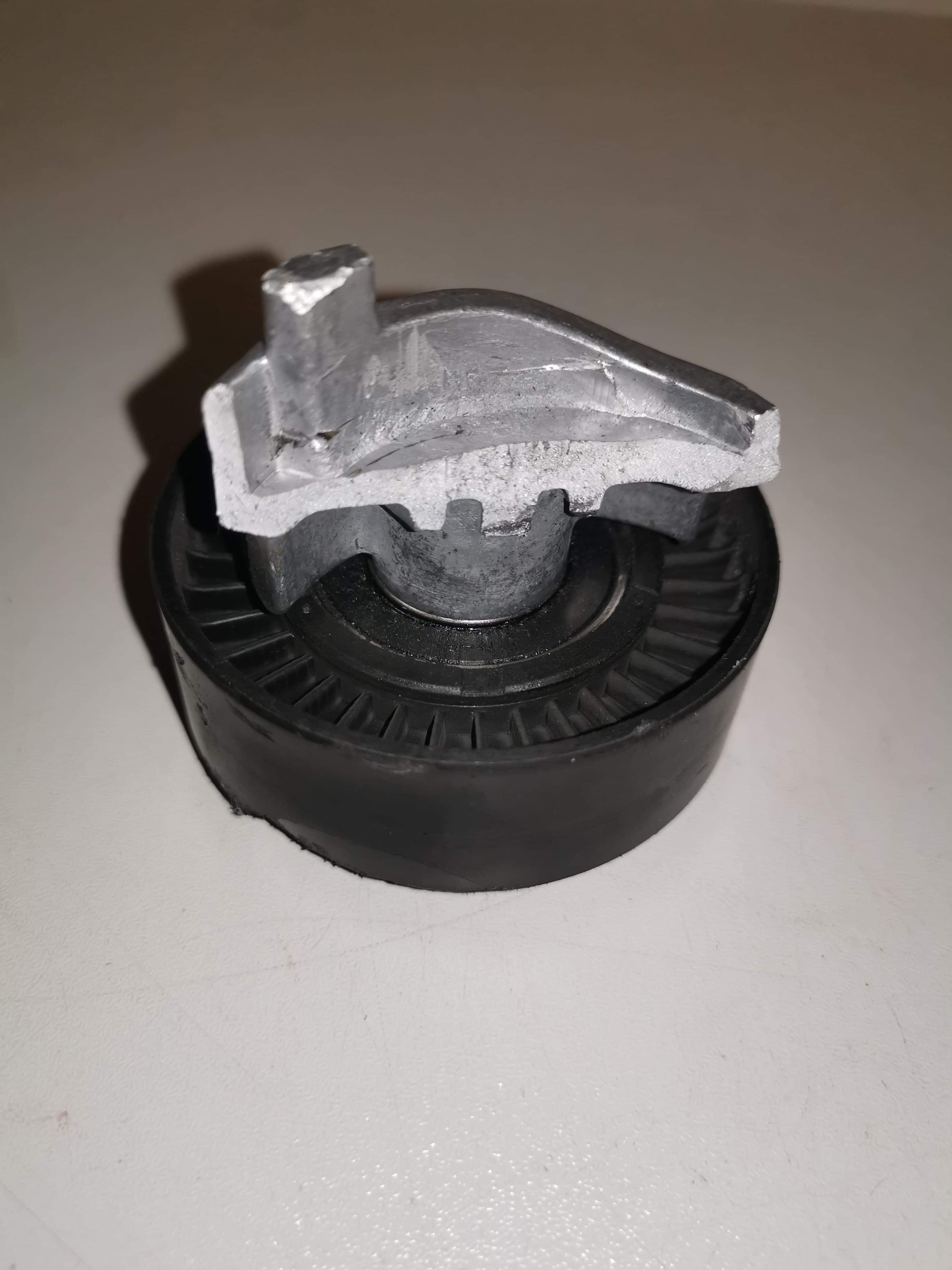

  13. Thanks for the reply. I came to a similar conclusion so bought a recon alternator with a new clutched pulley, new belt and tensioner. Touch wood it seems ok although I still think there’s too much constant oscillating of the tensioner. There’s also an awful rattle from ‘somewhere down there’ that starts when it’s not been running for a couple of hours a second or two after the engine starts and then vanishes about 6 or 7 seconds later. Engine generally runs well with no other concerning noises so I’m wondering if the air on pump might be at fault too. baffling to be fair.
  14. That’s the previous one. The damage on the lug on the first pic I think was done by a following car running over it.
