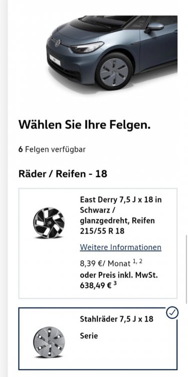

  3. ID3 configurator is online, and the base wheels are 18" steelies 🤔 😄 Question is, what bolt pattern, what offset, what hub diameter...

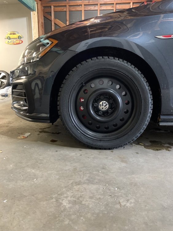

  7. These were the wheels the guy had problems with, so clearly not a VAG part wheel, he posted this picture a few posts before the one I quoted. https://forums.vwvortex.com/showthread.php?7220061-Winter-Wheel-with-Performance-Package&p=113818333&viewfull=1#post113818333

  9. Found here: https://forums.vwvortex.com/showthread.php?7220061-Winter-Wheel-with-Performance-Package&p=113826267&viewfull=1#post113826267 So depending on rotor size and welds on the inside... Not just plug and play. What size discs would I have? 2017 facelift Octavia RS 230
