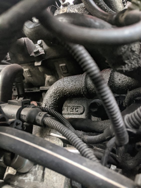

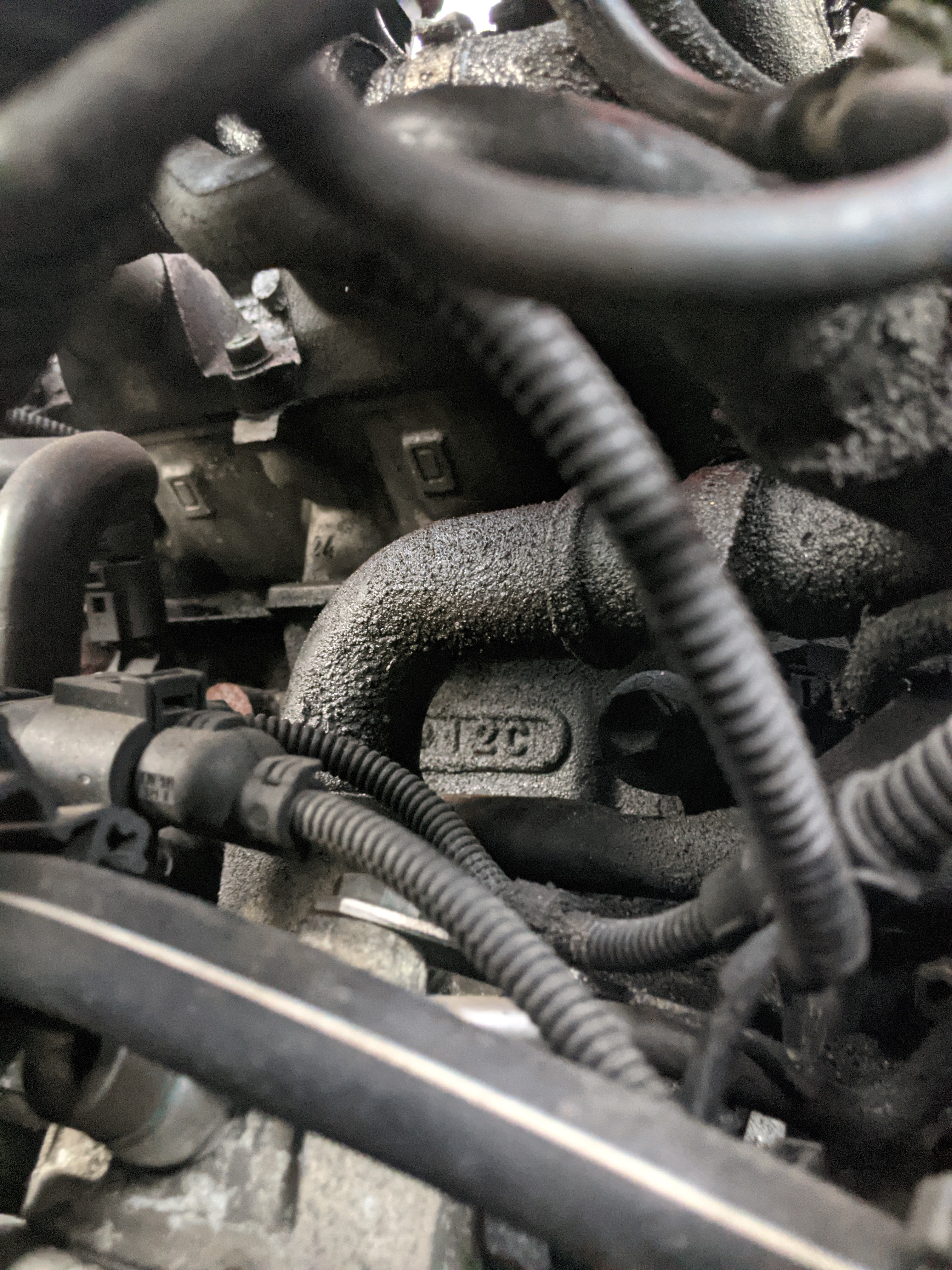

  7. I've been busy deleting the SAI today. The previous owner did the N249 bypass and as a result there are some redundant hard pipes. I was going to remove them today but then realised a third pipe headed off round the rear of the engine and wondered what it was and where it went. Any ideas?

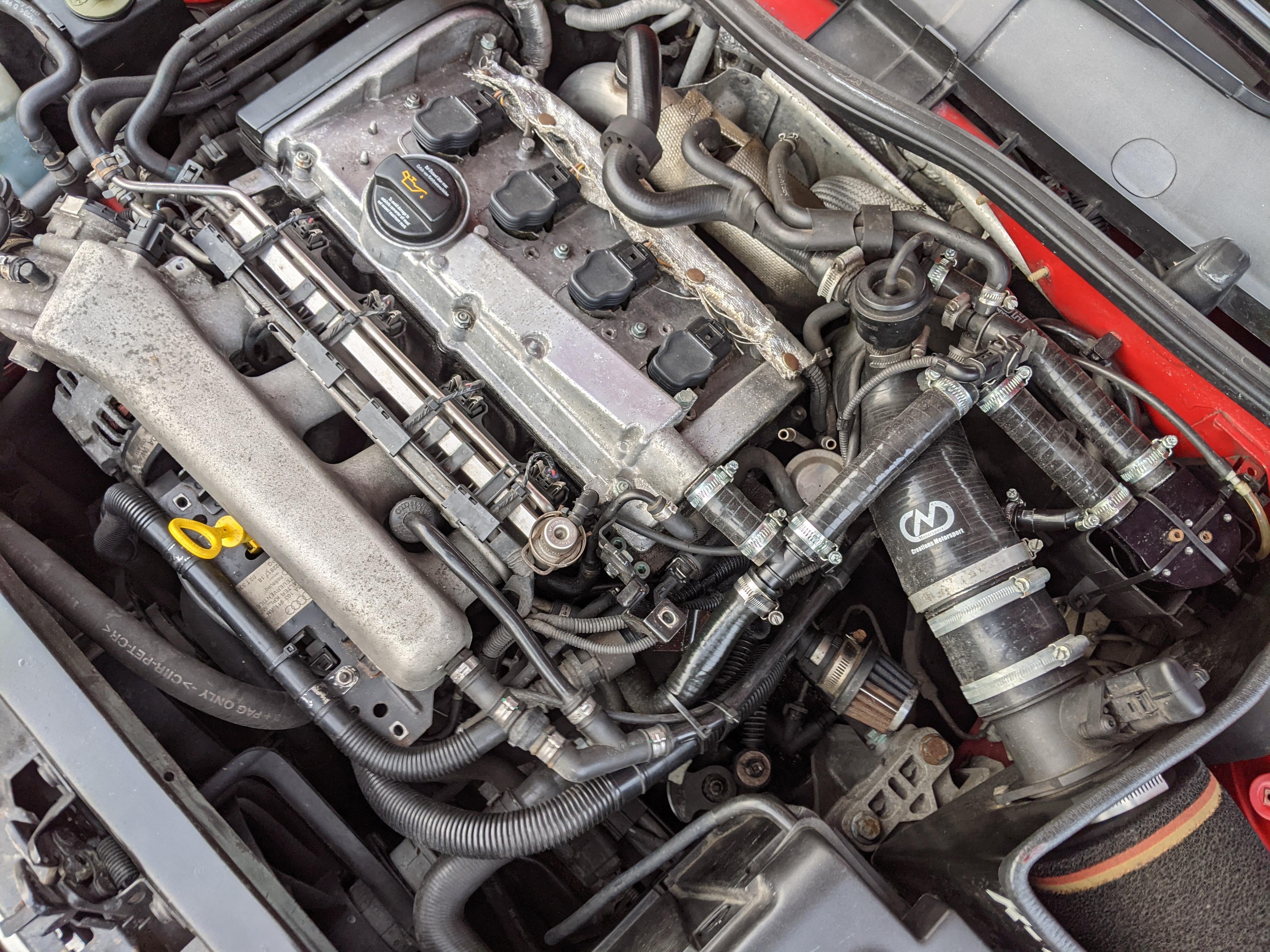

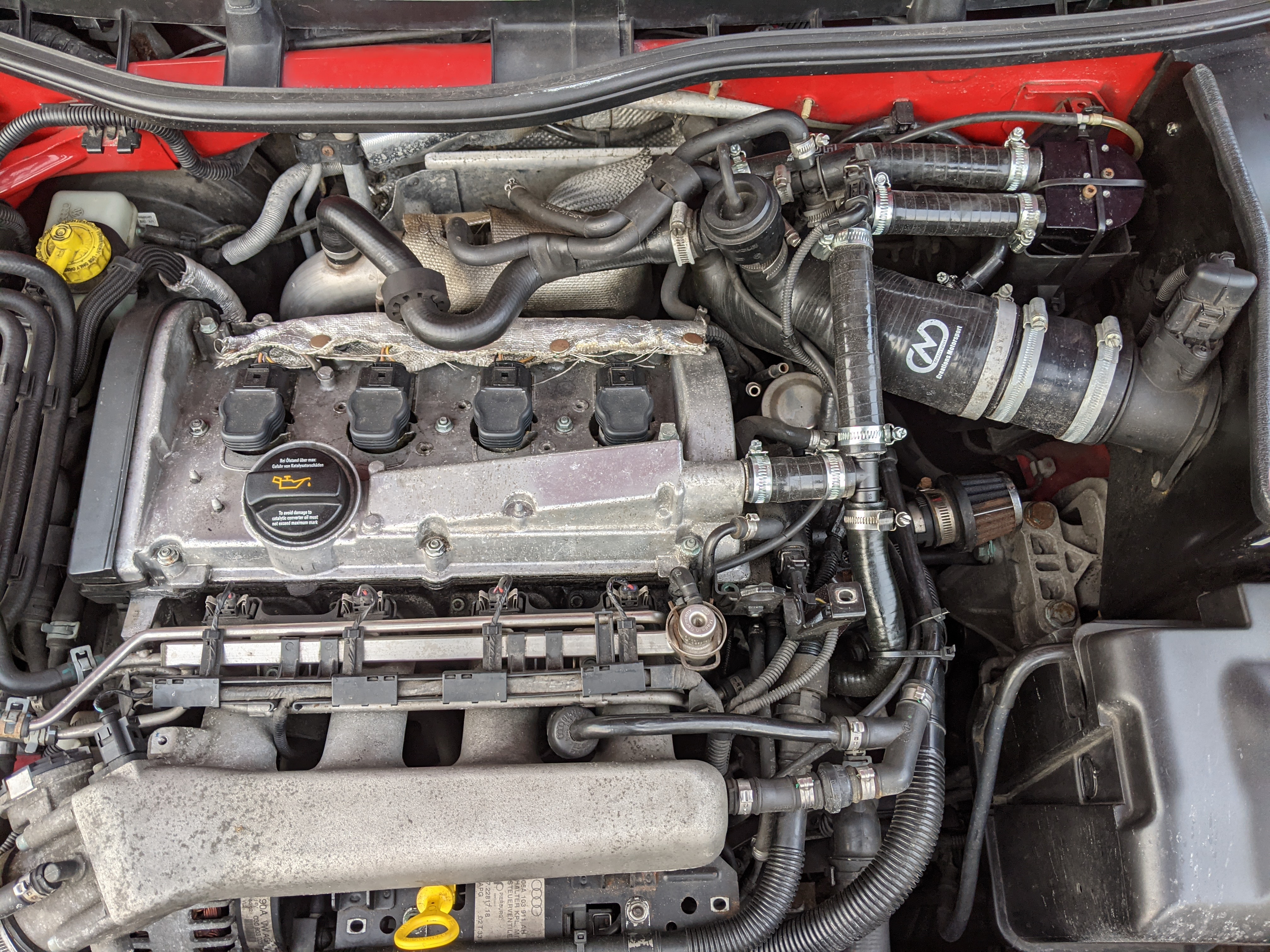

  8. Today was spent deleting the SAI. It went well for the most part but there were a few stumbling blocks. I had to dismantle the pump to remove it as there wasn't enough room to wiggle it out in one piece. The top bolt holding the bracket on was a pain to get to as was removing the SAI combi valve - I hadn't realised there was a second 10mm bolt holding it in place at the back along with the hard pipes. Apart from that and losing about 2l of coolant it was reasonably straightforward. I ran out of daylight to take some final pics but did get one of the parts I removed.
