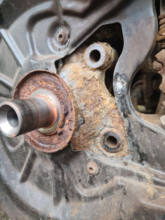

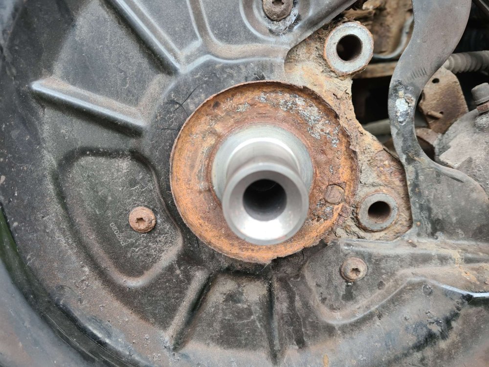

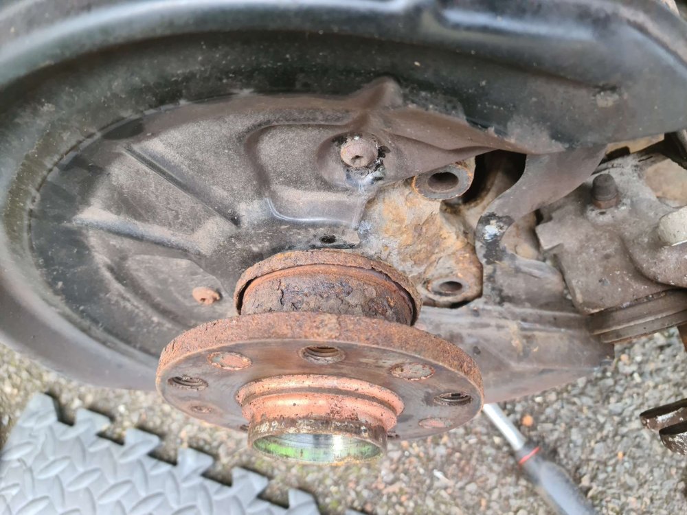

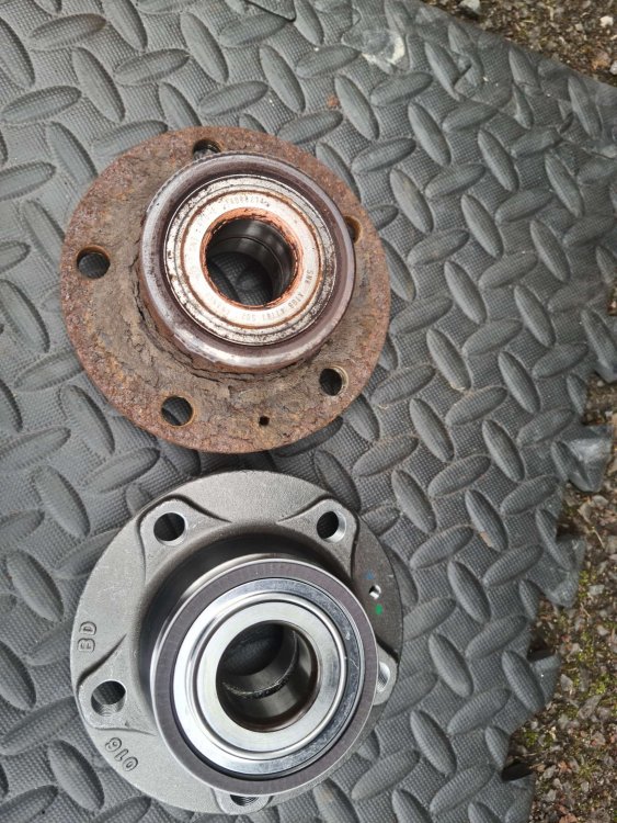

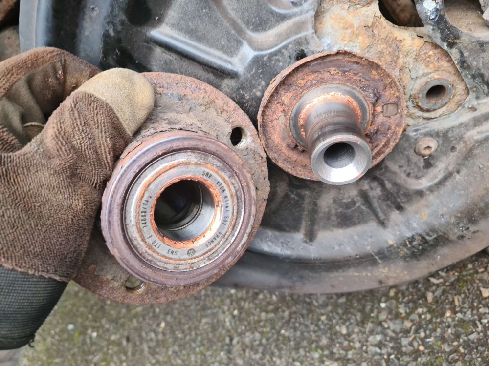

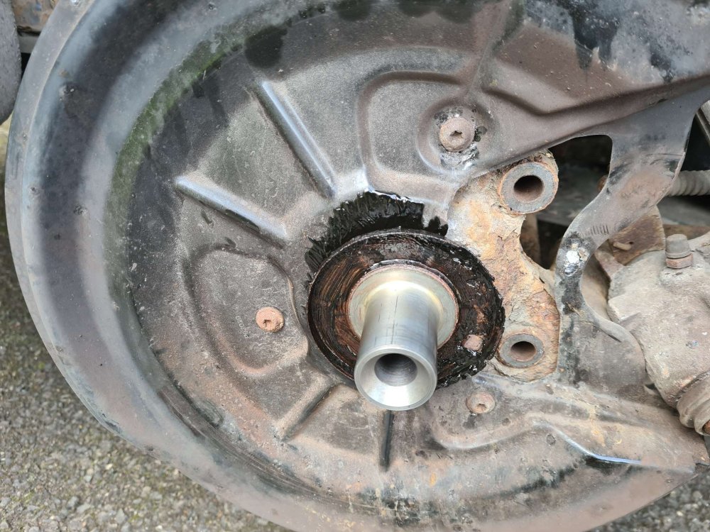

  1. Changed the wheel bearing today and fixed the issue. No ABS sensors change. Won't last for ever, so would love to hear how others deal with it? Where the cover sits: How it looks on stub axle. See the shiney bits that have been rubbing: ABS pick up ring: Cleaned up and coated. Used coating to check for clearance on new bearing.

  3. Hi, I noticed last year in tracing a wheel speed sensor issue that the dust cover that sits on the stub axle (NOT the big brake dust cover) had rusted enough to rub on the ABS pick-up ring on the bearing to the point it had worn off. I bought a bearing kit, but unlike on older cars (mk2 golf) there was no replacement dust cover. I did my best to scratch off the layers of rust without the cover disintegrating, but needed the car so put it back together. All has been fine... Think I have got same issue on other side now, and would like to source cover before I start the job. Can anyone help me source it? Cheers Andrew
