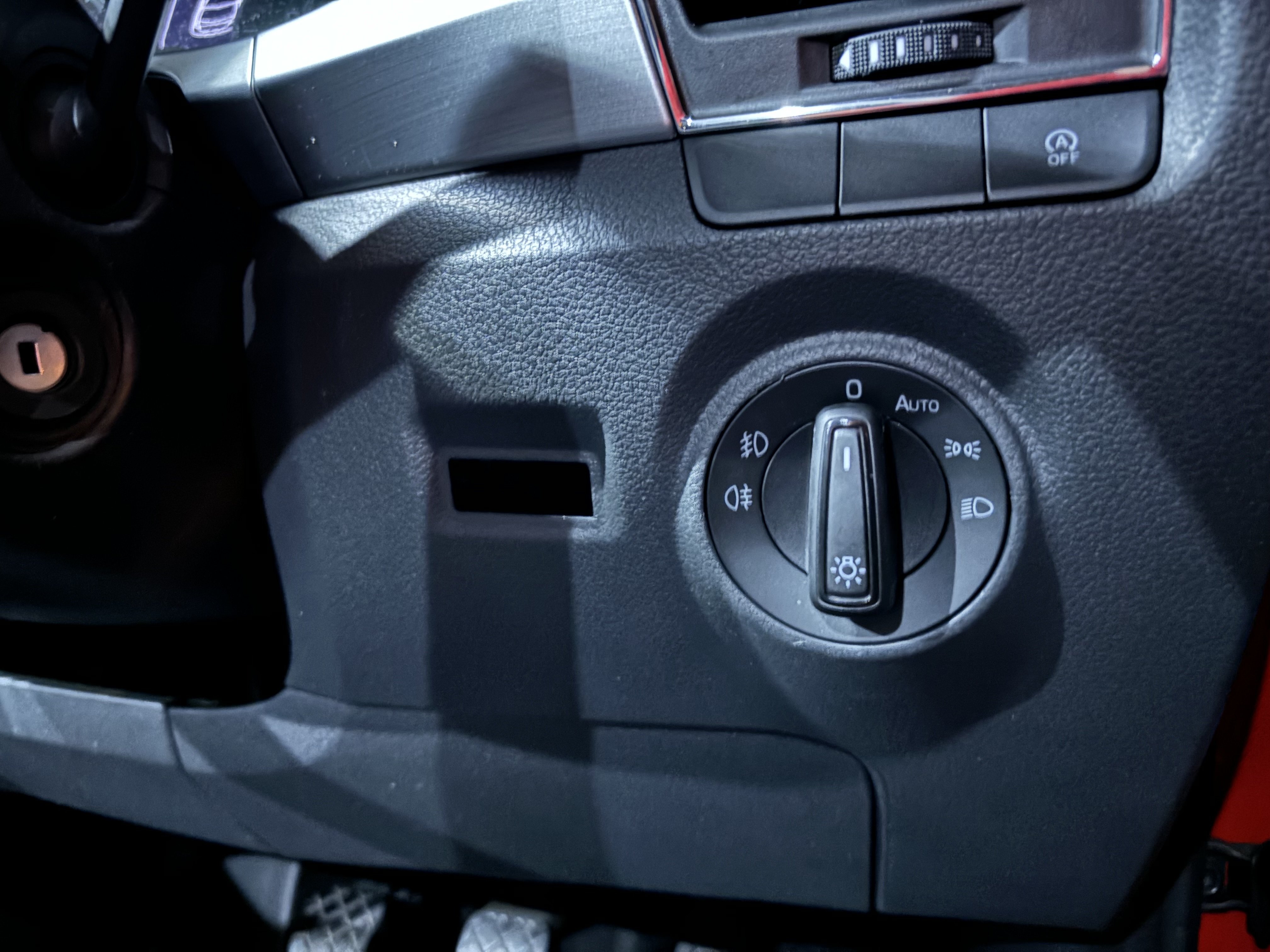

  1. I thought this was going to be such a pain to fix but it turned out it’s a 1 min job. I’ve followed the step from 10:55 from this YouTube clip. Removed the silver facia and the vent. Grab the switch and pushed it back into the position. Et voila !
  2. Thank you for your advice. So is this switch meant to be fitted from the front ?
  3. Hi, I’ve just recently picked up my Fabia 3(2021). Today, I was adjusting few bits and came across the Head Light Adjustment Switch, which looked not properly fit in place. I then tried to fix but obviously didn’t go as planned. It seems it’s been completely pushed behind the panel and can’t get back in the position. I tried to reach it from the bottom(back of fuse box?) and can touch the switch assy buy really can’t do any further. has anyone got any advice how to fix this ? Please help R
