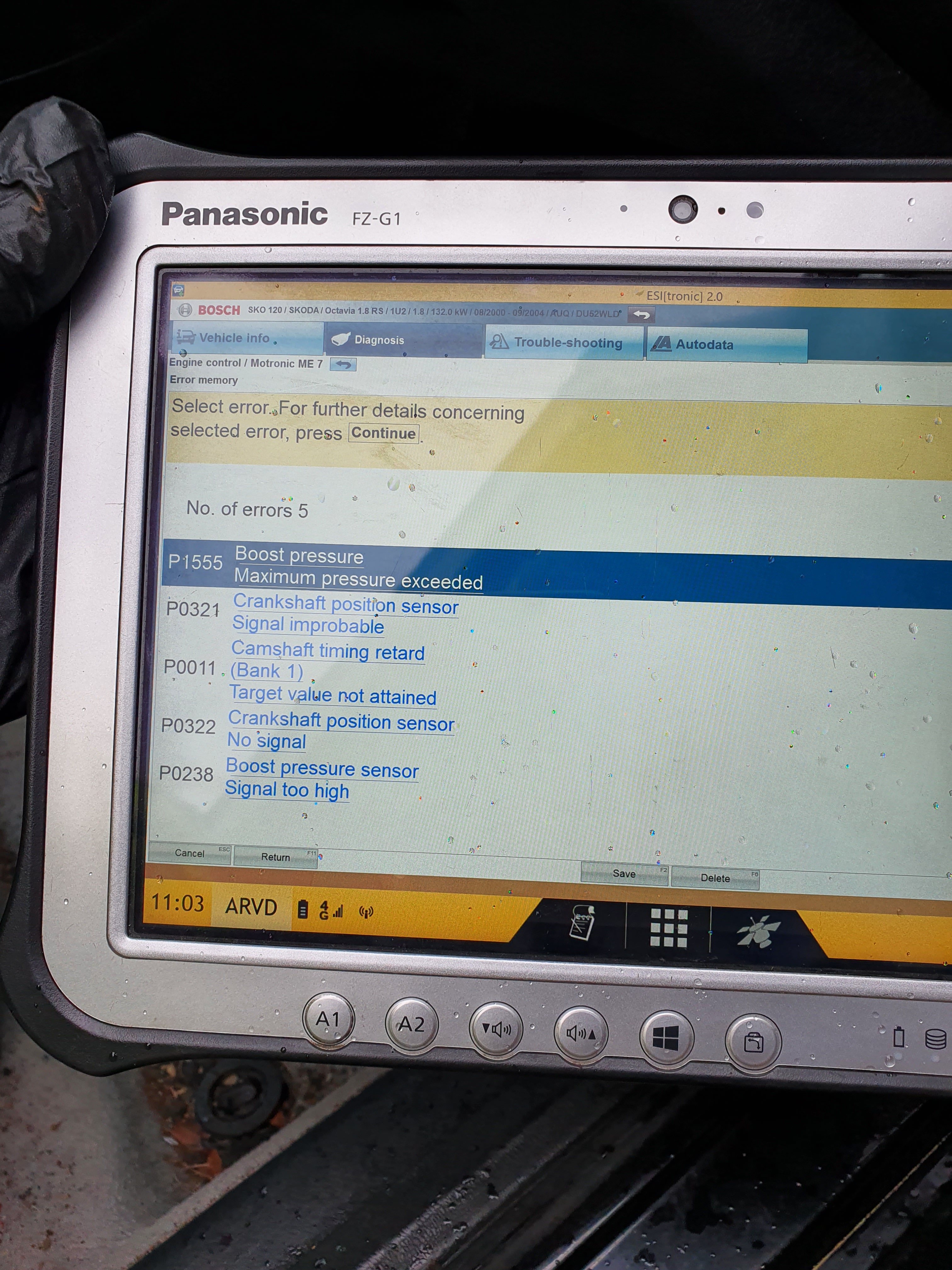

More gremlins, have had the crank sensor changed again. Was running like it had a fuel problem . Was serviced in August. Maybe time for a newer octavia
