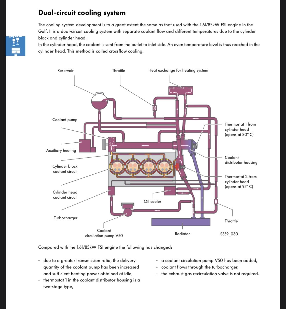

While I believe I have the temps more under control now I might be treading on my own toes, without thermostats I am not getting enough flow to the heater core, not too concerned however looking at the coolant diagram I may not be getting enough flow to the oil cooler either. at this point I’m probably over thinking everything and I’m just writing my random rambling thoughts in this forum but only having the time to work on the car once a week for 6 hours means I’ve got far more time to think about the problem than actually solve it 😓

Okay here goes… removed thermostats: front thermostat appears in good order, no buildup on it removed anyway rear thermostat had lots of white calcium buildup on it.. and the coolant sat behind the plunger was white.. assuming previous owner kept topping it up with tap water.. thermostat removed I cleaned the housings, light dusting of o-ring grease, and refitted, Fresh coolant goes in and bled the system (took ages but I think it’s bled now) not getting hot air in cabin (slightly warm), I can only assume this has to do with not having thermostats to restrict coolant in certain directions to properly flow to the heater core, not majorly concerned. results: coolant temp is absolutely solid now at 90, no concerns about the coolant not flowing properly etc, also no obvious loss of coolant so far (several short drives and a 40-45minute motorway trip However oil temp is still concerning me, it got up to 107 on a steep uphill 50mph burst and was around 105 motorway cruising, I understand this could be sensor deviation but I’m still concerned about the oil that’s in the car, I would have changed the oil today but couldn’t get my hands on a filter and didn’t see the point in changing it without fitting a new filter, Also did a combustion test again, no sign of HG leak, even tested to tester on the exhaust to make sure it was working and it is! This is my update for now, I have a 40 minute trip to make on Tuesday, hopefully it’s another successful journey. I feel like I’m getting closer to resolving this! thanks Tom

@Kobayashi thank you, the more I think about it the more your answers make sense, the coolant is getting to 90 and holding until the oil reaches 100 or so then the coolant starts rising, must be a duff pump, surely it wouldn’t hold 90 otherwise, even a leak in the system would cause the coolant to continuously rise in temp, have to dig into it after I’ve sold my bmw now, can’t keep paying for double insurance! lucky that my other Skoda hasn’t missed a beat in 5 years of ownership ☺️
