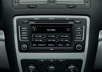

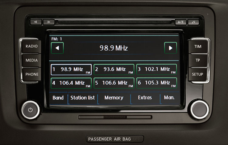

There are actually 2 front shapes
The Superb one is slightly more squarer
This is the Octy one
