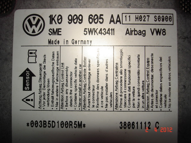

i need another help, since in elsawin it is no difference between left handedand right handed cars but in etka for same unit 1k0 909 605 aa is for left or right handed cars, can anybody tell me the difference between this two units?
the electric diagram make no distinquish.
a atach a picture with unit
