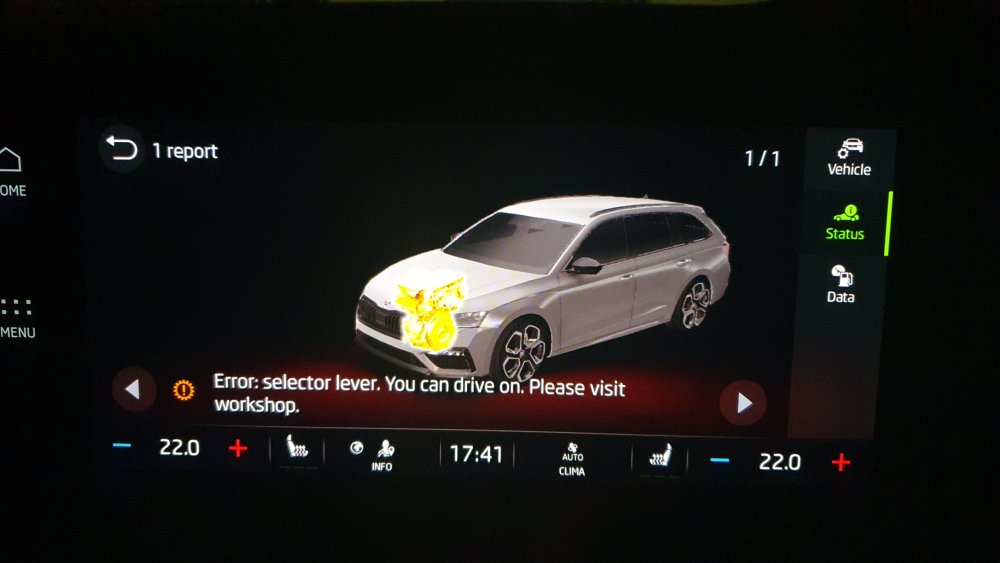

Hey, guys!
Here's a new one I got yesterday - "Error: selector lever.  You can drive on. Please visit workshop."
It must be the gear select lever, but everything works just fine. The error disappeared after leaving the car rest for a while. Today it showed up again after driving a short distance (a out 3 miles), stopped the car and then started again after 10-ish minutes...
Anybody had this?
