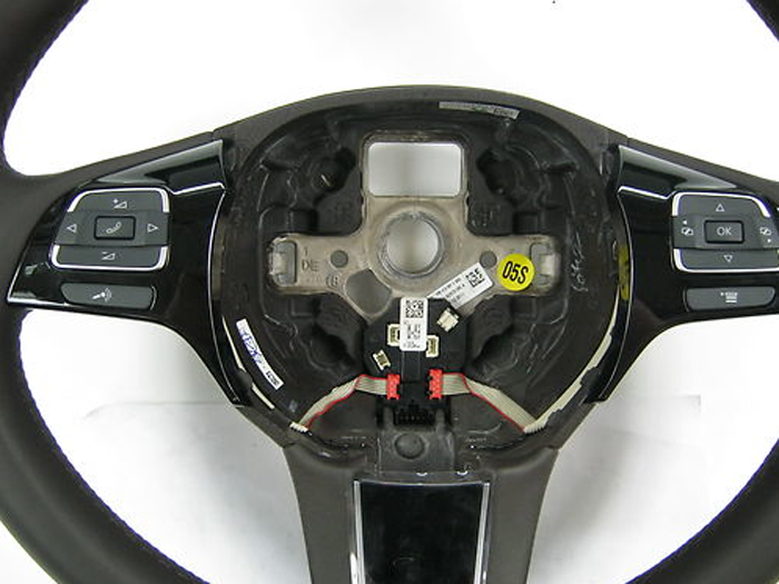

Does anyone know whether the latest VW/Seat Multifunction Steering Wheel will fit on a pre-FL Octavia?
P/N: 3C8 419 091 BE or 5P0 419 891 AS or similar.
I'm about the upgrade my steering controller to 1K0 953 549 BP and I was wondering whether this was new enough to support all those buttons?
Also what airbags would fit (or can the VW logo be taken off the airbag and replaced with a Skoda one)?
Has anyone tried this yet?
There seem to be a few of these used wheels around at about £60-80 which seems pretty reasonable to me, but not reasonable enough to take a gamble without the advice of someone more knowledgeable than me.
Thanks.
the answer is NO
you would need a CH controller if you wanted that type
The airbag is different and you would need one that matches
Didn't think it would but thought I'd check before wasting money again.
Just discovered that the buttons are also backlit - in VW red.
As I expect changing the colour to suit Skoda (i.e. green) would be rather involved, I think I might give up on this one.
Unless you know otherwise...
