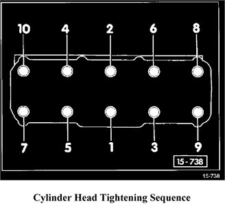

isn't there a sequence aswel as torque for the head so as not to warp it?
Yeah a sequence aswell .
