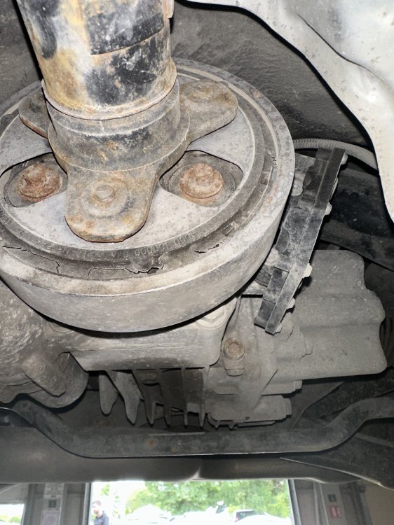

after inspection you can see this 😀 The pad is strong but the metal part moves when pressed, does it serve as balance?
In local service they told me that this joint is ok 🤨 what is you opinion?
Chached! But the problem I still here 🤯
