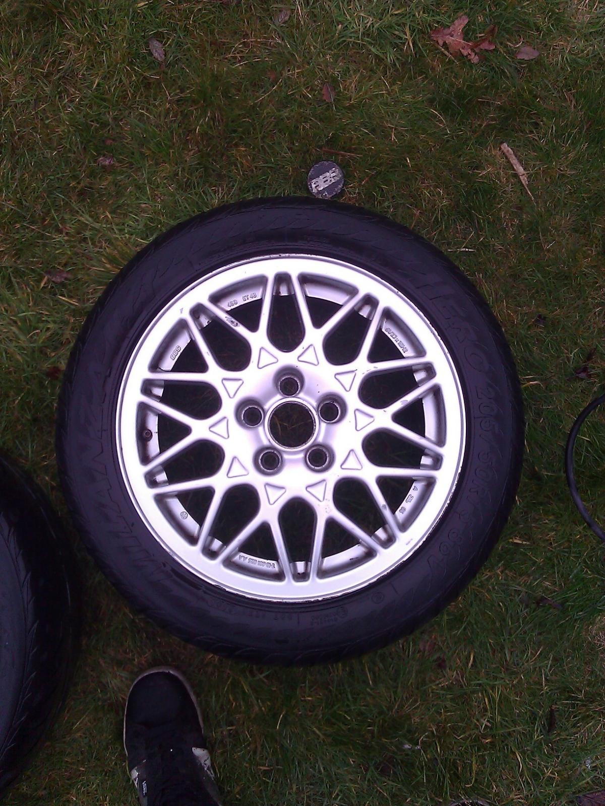

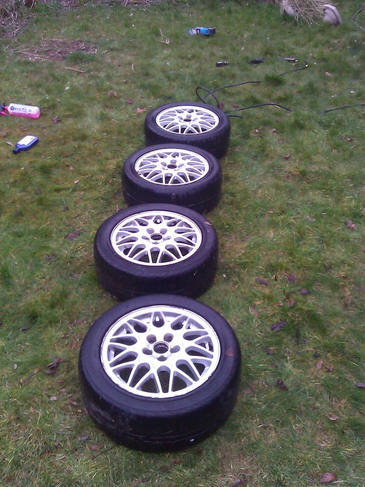

Got a set of these free, wondering if anyone knows if they'l bolt straight on my fab without the wheels failing or grinding the arches to bits on full lock? 5x100pcd so no worries for adaptors, if they arent a straight fit what do i need
205/50/15 ET35

Tyre sizes calculators has them as almost an exact swap on to a VRS and i guess that all Fabias run the same circumference of tyres so they should go on perfectly
yep straight on, and nice and flush with the panels too
Wrong tyre size, you need 195/50/15

They'll fit fine. They're mk3 Golf/Corrado BBS wheels, and the offset is ET43 not ET35 (you can see it stamped on the wheel in your second picture)

My bad i must have read it wrong! unless i have different wheels with different offsets cause i dont know where i would have got the 35 from?,, its probably just me being stupid :)
