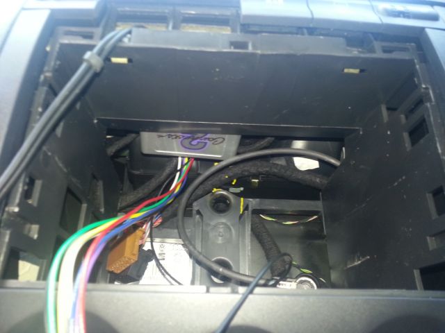

Hi guys, I'm driving my 54 plate Skoda Fabia to Mongolia with 3 friends this summer as part of the Mongol Rally and decided we'd be needing some tunes to keep us going so have fitted a AUX kit.
I made a post in one of the technical guides sections where 'Stormchaser' suggested I post some of the pictures of the finished product over here as well :D
I took one of the panels from above the stereo and stuck a 3.5mm Jack Coupler in there to make a plug to plug an mp3 player into, it looks a lot neater than it does in the pictures as the flash really showed up the glue I used.

great idea, where did you buy the connects2 box from? and can you still use the cd player? does the adaptor sit idle until you plug in an mp3 player?
cheers
I bought the Connects2 CTVSKX001 AUX interface from EBay (you can find that if you search online, I pmed you an EBay search for the item.)
If you use this AUX kit you can't use a CD changer but I think the standard CD player still works, I will check and get back to you.
