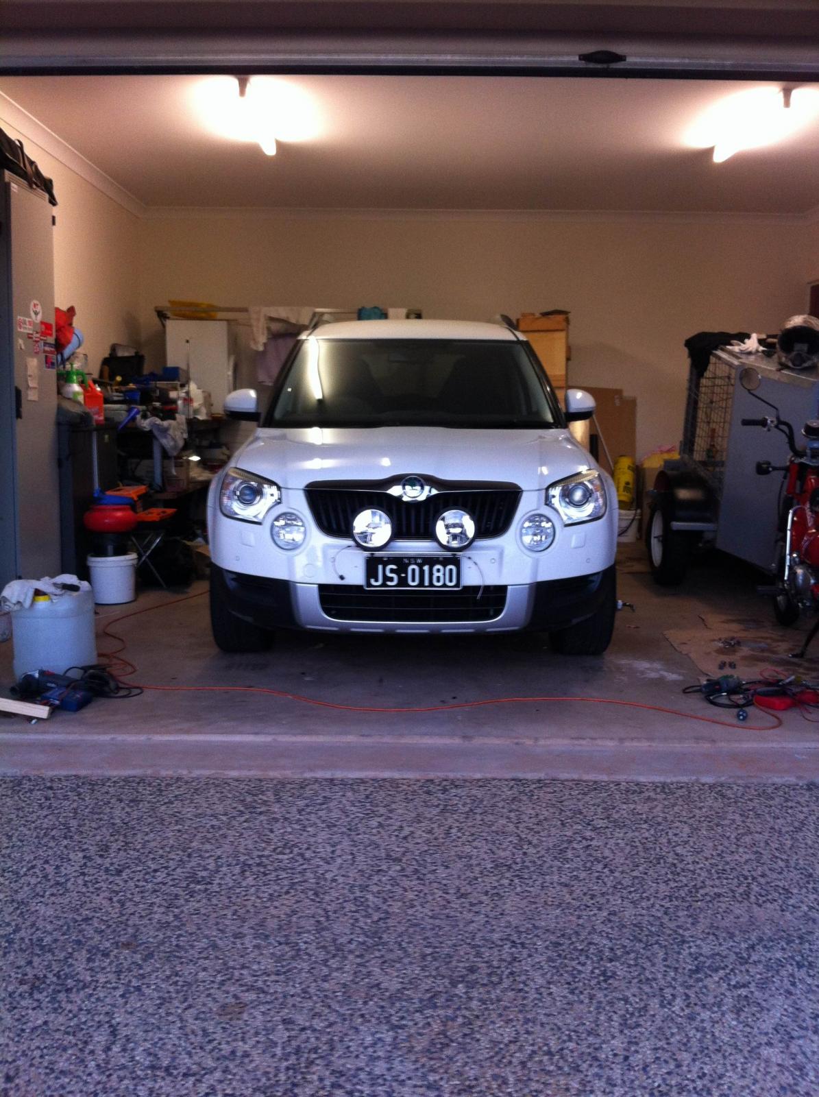

Well this has to go down in history as the longest driving light install ever.
I have enough pics for others that want to try their own install but I'm leaving for a 2 week trip tomorrow, 10,000km to drive. I'll get them uploaded when I get back.
I have to say I'm pretty bloody happy with the result. These are all wired up but I'm waiting on a HID kit. If it doesn't arrive I'll put the 100w Halogens in.

Looks neat.
I presume you didn't use the bar thing then?
That looks like you have mounted them on a alloy plate with the top bent at right angles, using the number plate mounting screws. Is that correct? It is similar to the thoughts I've had, as I have about 8mtrs of 2" angle alloy at home from an old frame around a flue.
Looks neat.
Yeh mate, Thats pretty much what the bar thing is. It's just a peice of alloy angle thats pollished up. I has to cut the tube peice of the front because my lights are very low and wouldnt fit. It was only welded on the bottom side so my cutting is not visible unless someone gets lower than the lights.
As for mounting. I had the whole bumper off. Its so easy when you have the workshop manual. The plate had holes for 4 x M8 bolts but the silly thing was the lower 2 were only half way down the plate which is full number plate height. I went against my better judgement and just used the provided holes, only to find it was not rigid enough to stop the lights vibrating so I had to add 2 more at the bottom. I'll post pics but just imagine 3 x M8 bolts on either side, spaced out from the bumper to match the curve.
Dont worry about whats behind the bumber. It's just foam. I want to put all the pics together with instructions and information but here's a sneak preview.

I think the vibration is from the softness of the plastic. I have no doubt of the strength to hold the lights. It's just a little flexable and allows the plate to move. I have also added a couple of stays of the top of the lights that completely stop that forward/back movement of the top of the lights.
I'm also into RC Helicopters so I crossed the hobbies a little and use some heavy duty (RC heavy duty) ball joints from the light to the car. The ball joints are connected by about 3mm threaded rod with a carbon fibre tube. The carbon fibre tube just hides the thread and looks cool..
