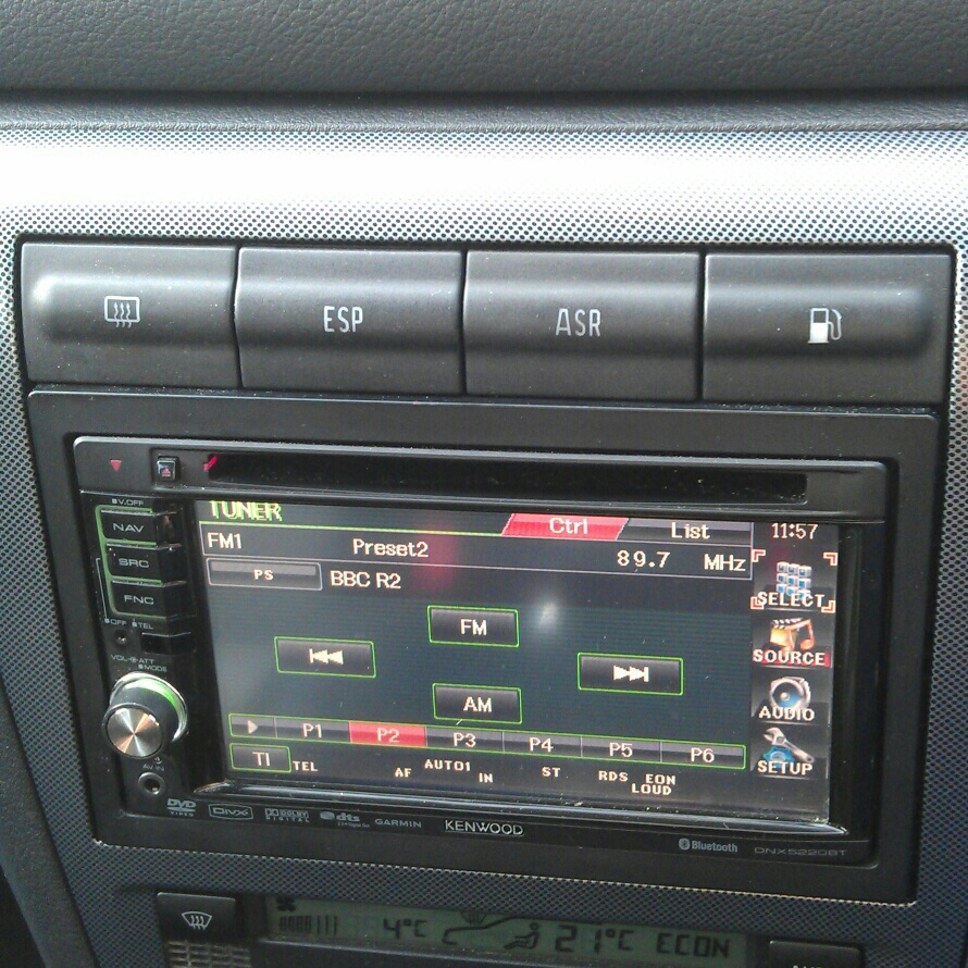

Want to retrofit the double din stereo in my octavia.
Currently have the single din stereo with climate control is it just the case of removing the bottom bit and fitting the stereo?
Yep, pop out the steteo and pocket
There b a H shape plastic brace u need to surgically remove to help for space tho
Got my kenwood in without cutting the plastic. Have to remove glovebox to aid routing wires as there's minimal room.
Fitted my Sony without cutting the plastic or removing glovebox.
