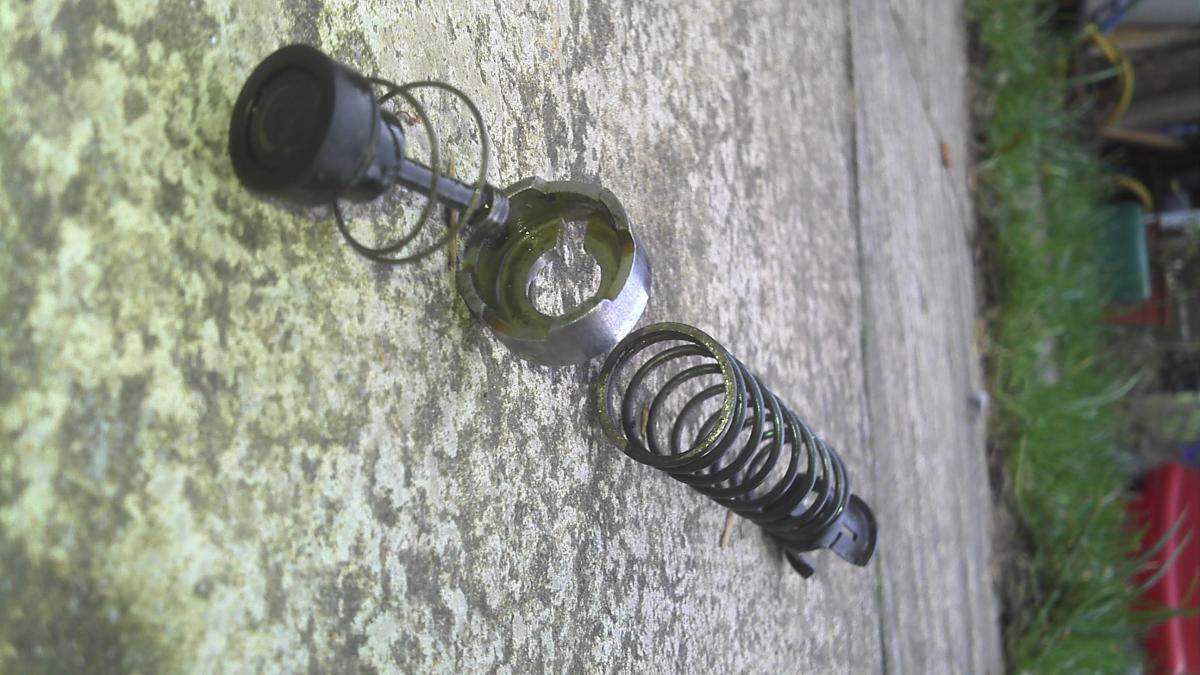

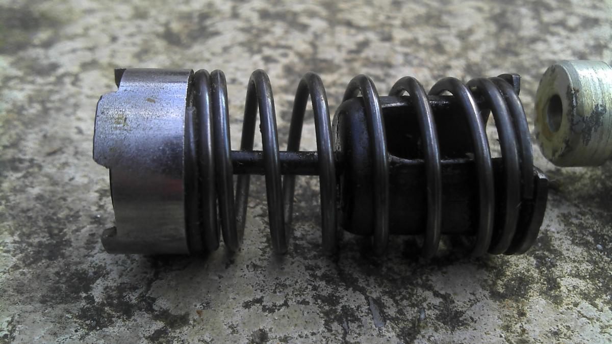

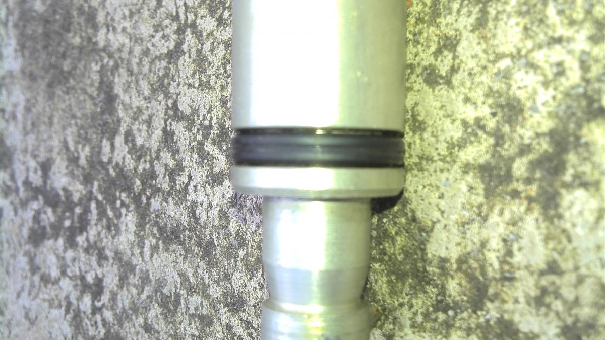

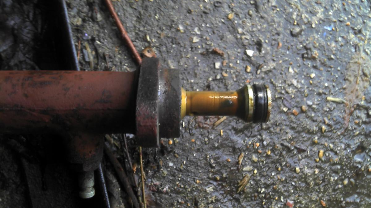

i removed the master cylinder and inspected inside the cylinder and also the pistons and springs ,it was pretty skank. although after cleaning off any stubborn residues it wasnt to bad. this is the insides before cleaning.post-111247-0-25856100-1389125273_thumb.jpg
i think this seal was the main factor.
 so a quick trip to local motorbitzofactors and no seal kits available , apparently according to them "no ones repairing them these days, your a few years late. ha" so......
  skoparts international here i come. thanks
 forgot to mention i rebuilt the cylinder and bleed the system quickly at the master cylinder. drove 15 odd miles with a good responsive pedal! although i think rears need some work as im locking up at the front before noticing any real "action" from rear brakes.
