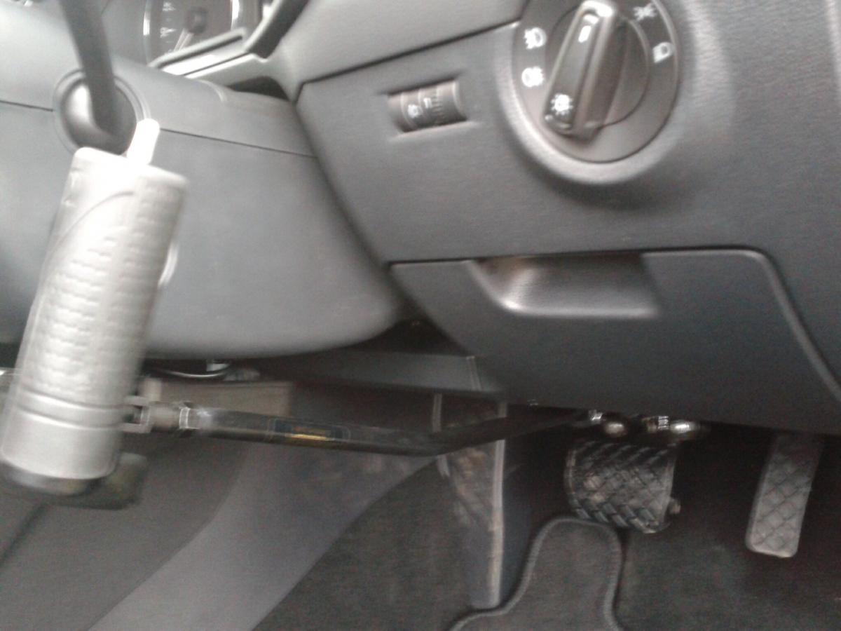

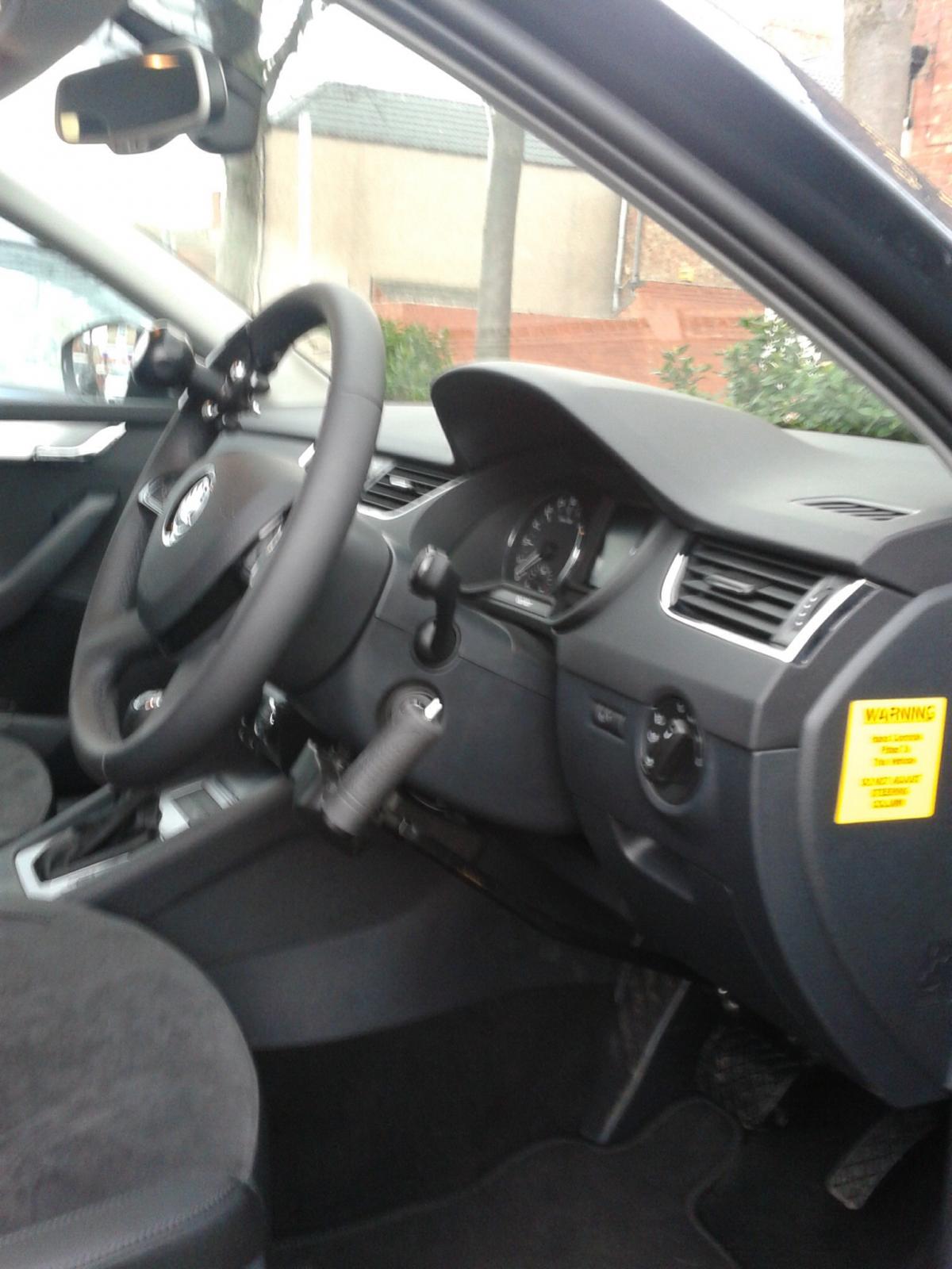

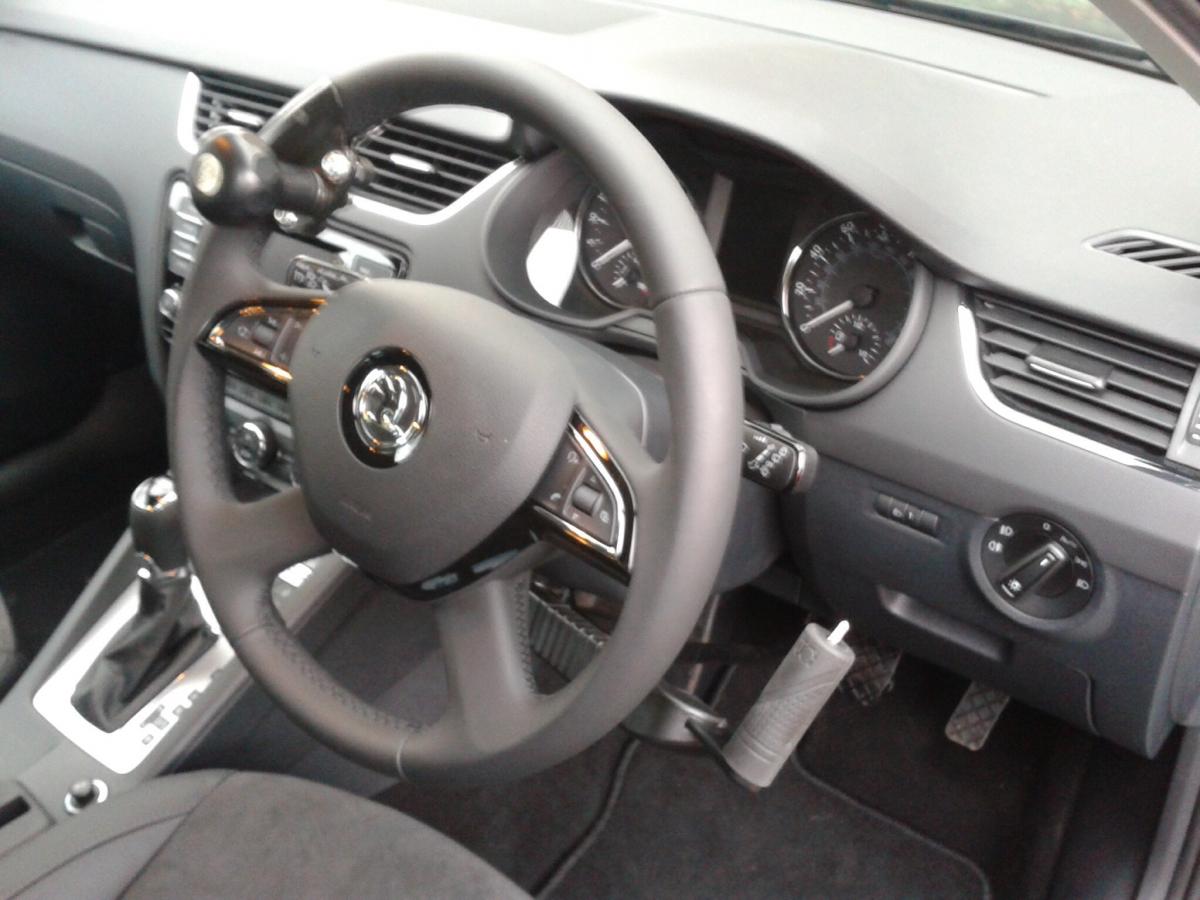

As requested after my first post I have attached photos of the hand controls
They are very easy to use, pull to go and push to stop.
You will notice that the design enables the use of the pedals if I can bring myself to allow someone else to drive!
Sports Suspention option was added to reduce body roll making the use of the Steering Ball easier; great on roundabouts!

Is the accelerator controlled by right thumb on that button?
Hi again
The hand controls were fitted by Bewick Mobility.
The button on the top is for the indicators.
The rubber grip is connected by a rod and a system of levers to the accelerator and brake pedals.
Pushing the grip towards the pedals operates the brake, pulling towards the driver operates the accelerator, simples!
Hope this makes sense
