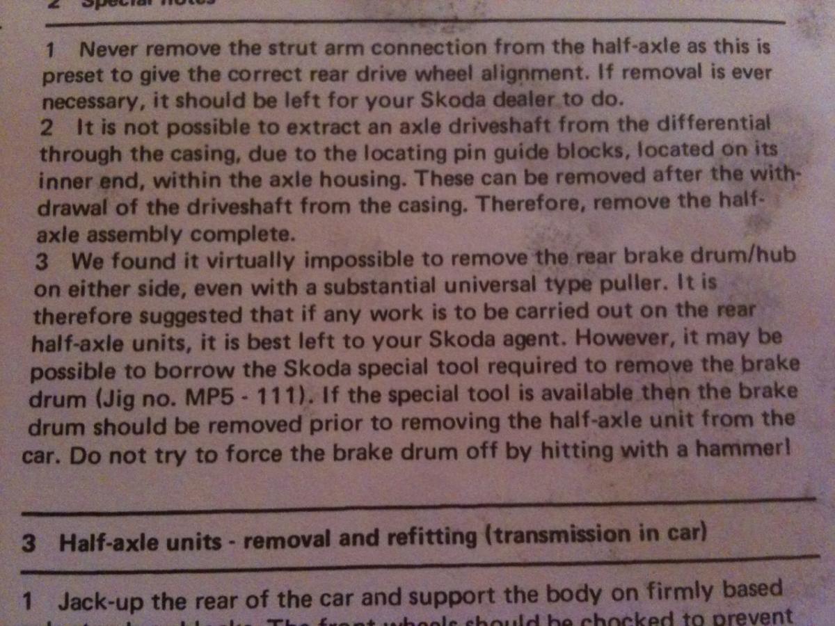

So, to replace the rear brake shoes. Special puller? No worries, there'll be something out there that can shift the drum-cum-hubs methinks. Hmmm, Google shrugs and walks away whistling, Haynes throws it's arms up in despair (see point 3 in pic).

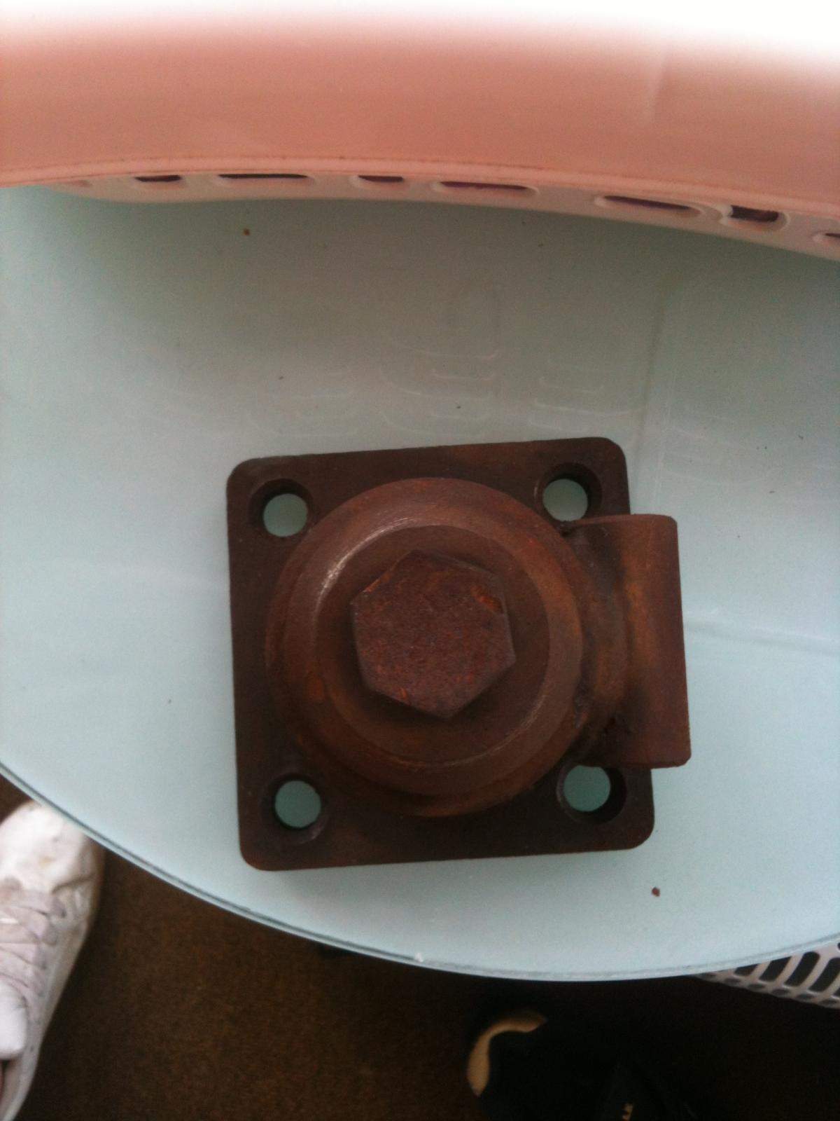

Got the special puller today, not tried it out but it looks like it should do it. Photo's below -

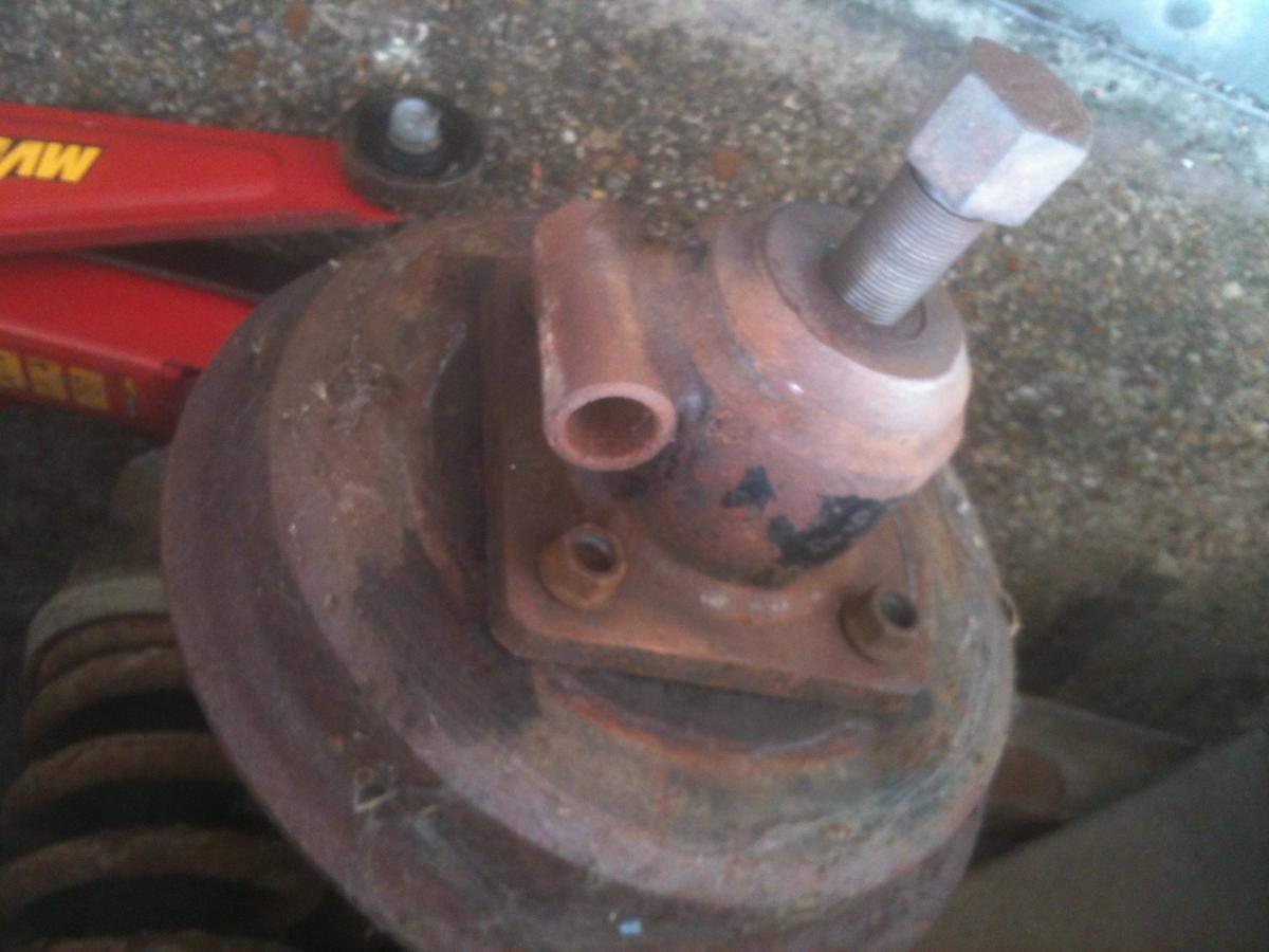

Quick look at the puller in position. It took on hell of a lot of effort to free it but when it did it went with a loud PANG!! Drum and shoes looked in great condition, just a little sticky grot on the outer edge of both drum and shoe surfaces. Cleaned off easily with brake and carb aerosol cleaner.
