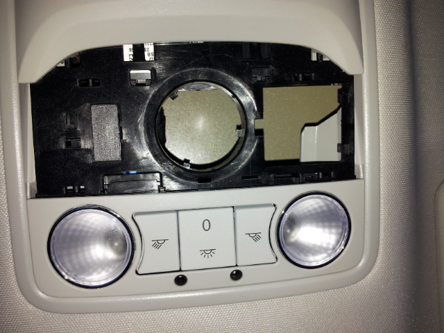

I'm trying to remove the interior front light panel so that I can change the bulb, I managed to pop off the middle section but it didn't look like the drawing / guide thats been posted before.
I've tried to prise off the panel around the lights themselves but there is quite a bit of resistance around where the LED ambient spots are and that's where my  bottle gave out! I felt that if it was going to pop off it would've done. I was hoping it would be straightforward like the lights in the rear of the cabin but it's not. I know lots of you have changed the bulbs in this unit before, so am I bottling out too early or using the wrong technique?
this is what it looks like when I remove the 'middle' part
Any ideas greatly appreciated, cheers

Thanks individual, but that only shows the sliding roof bit which I don't have.  Still trying but it doesn't want to seem to come off without a fight.
If you're still baffled by this, don't worry! The plastic cover further away from the lights swings down with a little pressure, exposing 2 Torx 20 screws. Loosen the screws and the entire unit swings down, giving you unfettered access to the lights from the back. It's easy peasy from there!
