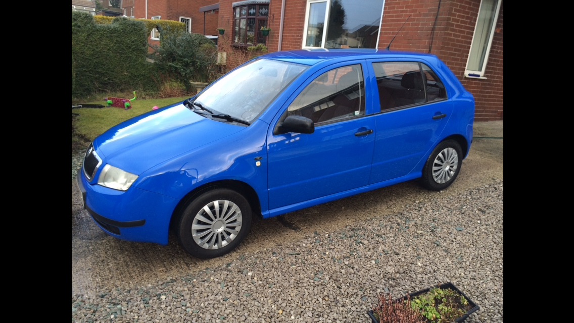

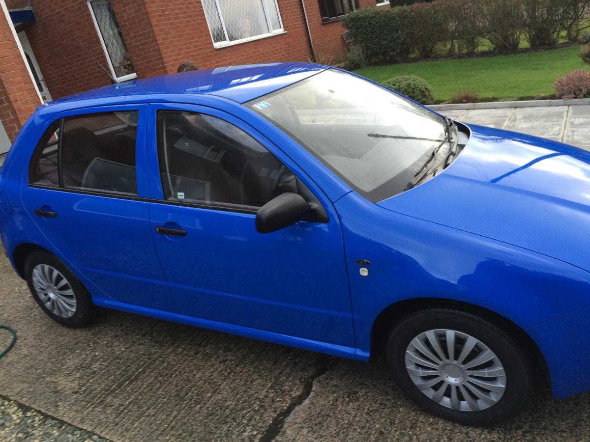

And a few little pics...
Picture after a wash and the paintwork is looking very good for the age of the vehicle. The Mrs seems happy with the little Fabia.
