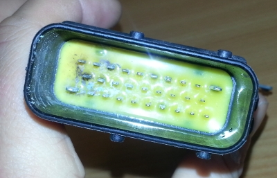

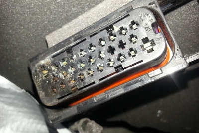

I have had some funny behavior on my 2004 Octavia VRS recently. Central didn't work on the drivers door, micro switch on the drivers door was intermittent and the led light by the door lock indicator was always on. I traced this back to a wet connector for the control module in the door which i have since removed as it was smoking and running my battery flat!!!

You may find this useful, for future protection if nothing else. It looks like the female plugs in the block are a bit corroded, male pins don't look too bad but the unit itself may be too far gone.

Your led light could be a knock on effect of water ingress, and you say the multiplug was smoking? Could be fried. Check sections of the loom for other damage. Microswitch has been talked about alot lately, there's a how to on replacement, or its a new lock mech (or used if you dare). Your temp sensor issue I can't really help with I'm afraid.

Your corrosion is slightly less than on mine, which I cleaned up and got working this afternoon. See link to my post in YellowCar's post #5 above.
Take a close look again at your last photo. It seems to me that the middle row pin on the left hand side has corroded away and may no longer be able to reach the mating contact. This is the +12 V feed pin. You may be able to break it off/drill it out and put in something to take its place that is longer. Nothing will work when there is no connection on this pin.
