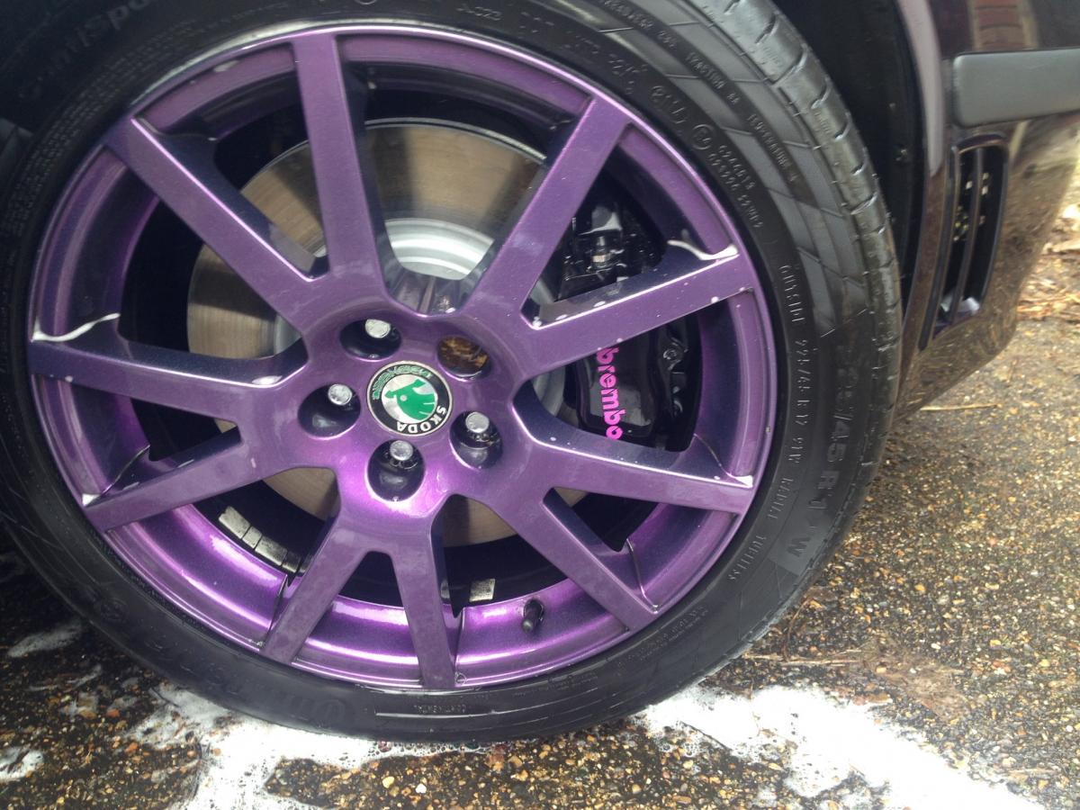

finally got my brembos all fitted up :-)
got a slight problem though when i go over 50mph an up an when acceleration im getting wheel wobble that i never had before im not getting it when i brake just accelerate ive fitted 5mm spacers an longer wheel bolts so im gussing its heading towards my spacers they are hubcentric from creation motorsports has anyone ever fitted 5mm spacers with spiders?
ive ordered the allignment tool as it was a struggle to get them all on an lined up i was wondering if this could be my problem?
thanks guys tell me what u think
You've probably lost a wheel weight. If you have not lined up the  spacers then you'd struggle to get the wheel on, so I doubt it's that. Get the wheels checked/rebalanced.
I hope it's that simple of a fix got it goin in to be balanced tomorro is there anything else it could be?
I doubt highly its the spacer. I ran my Celica GT4 with 5mm machined spacers on the fronts to clear the huge four pot calipers. I did three track days with them and some very hard road driving for two years without any adverse side effects/knocking/vibrations.
First thing, get the wheels balanced, if the vibration continues then you can fault find further eliminating the wheels. You'd be amazed how much difference a 10 or 20g wheel weight makes.
I fitted those exact spacers with 30mm bolts and no problem. As said above check balance. After I fitted mine I went to my local tyre place and got them to torque evenly all the way round, for peace of mind more than anything, could try that.

Yeah mate, it was a bit disconcerting how much I had to turn and tighten the bolts round the wheel to get it all seated which is why I got them re torqued. Turns out I wasn't far off but like you say it was a handful getting them on. But as said above once the bolts are in they should be well in place, just gota tighten the buggers up. Awesome gti now sell a wheel hanger to make the job a lot easier, will be getting one of those I think.

I will give all this ago tomorro got my alignment tool turning up an ill tighten the bolts I done them up with a nut gun so I'll go over them an see what I come up with :-)

Balanced an alignment tool used an it's all good slam my foot on the brake now an U fly straight threw the front window :-)
