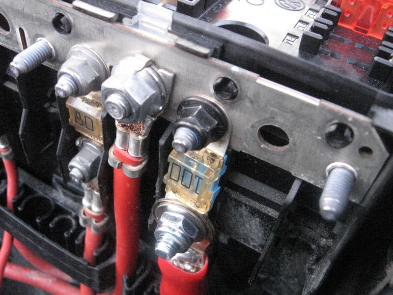

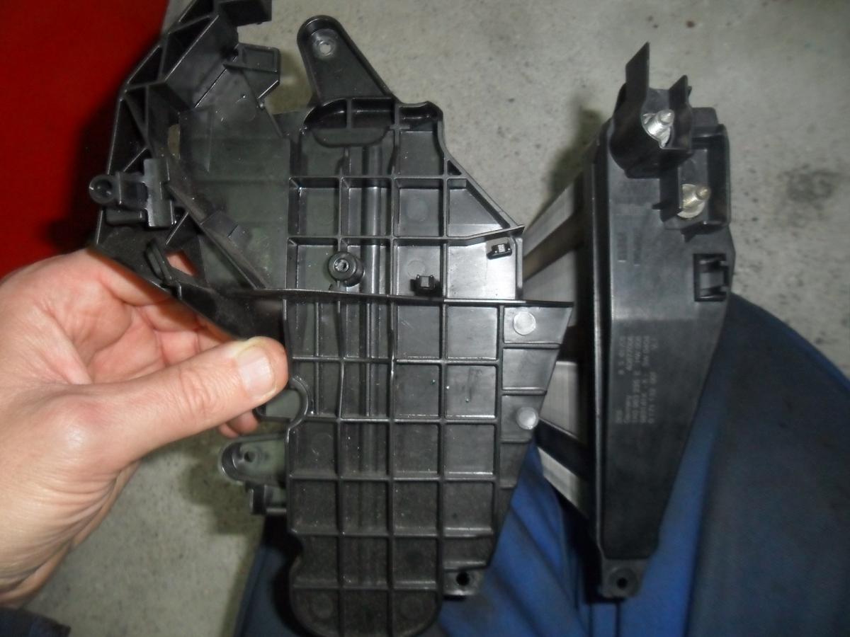

I found if you went to a breakers yard and looked at the fuse box first, if there was a heavy red wire coming off it with a 100amp fuse, chances are it had a heater fitted. This was on vw golfs or passats. If you looked inside at the heater controls, if it had climate control then it would be the canbus controlled heater fitted. By pulling the side trim off the passenger side of the centre console then you would be able to see the heater and heavy wires directly in front of the heater matrix. If you do find one, make sure you get the small plug and some wire for the canbus, plus the cover for the heater as this will differ from your existing one which covers the hole where it goes in the heater box.
Here are some pictures to help explain the the above. The 100amp fuse on the fuse box, The slot in front of the heater matrix - after the cover has been removed, The heater with the +ve and -ve threaded posts and the small plug hole along with the new cover, The unit fitted to the heater box with the heavy wire in view and the small plug with wire to splice into the canbus loom.
