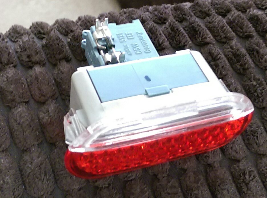

I have a complete drivers side red / white unit if you need it, I had to buy a new door card and mine doesn't have the electrics for it.
If this is the one?
