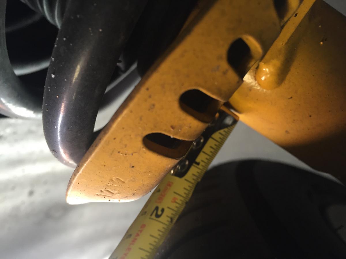

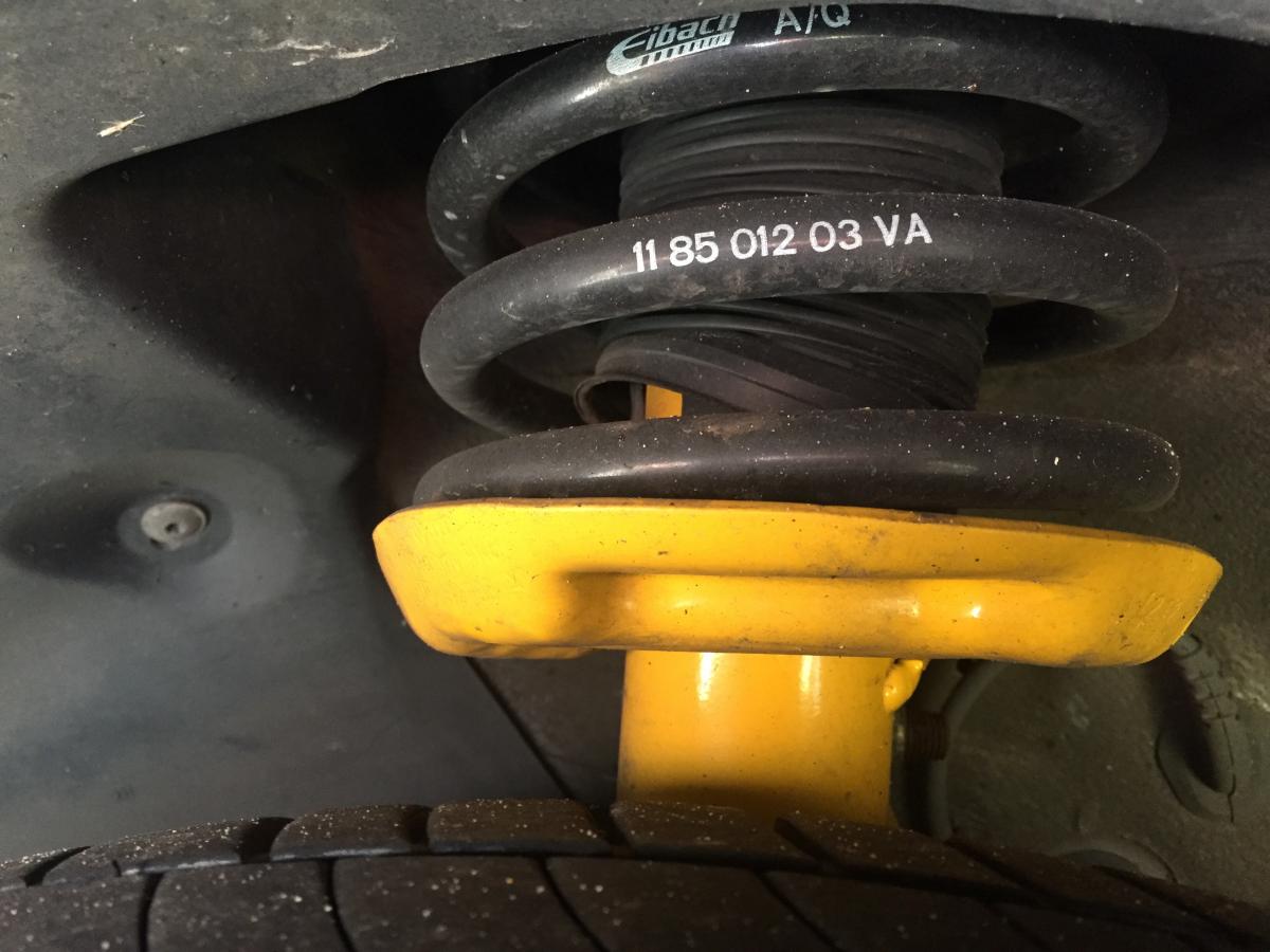

You will lose 1mm clearance on the caliber and 13mm clearance to the strut:
http://www.1010tires.com/Tools/Wheel-Offset-Calculator#
That is providing the new wheel doesn’t have thicker spokes!
Now that's a very useful link! Many thanks Gizmo! :)
Hmmmm. I don't think this will end well :(
That does look rather snug... although on our 2014 L&K fitted with 7”x17” ET45 Origami wheels I have approx 25mm clearance to the strut (measured by how far I can get my finger between the strut and sidewall)
Interesting. That would indicate that I should be ok but with the max camber I can run up front and the fact (iirc) I no longer have the standard oe damper units (which iirc are shaped/indented to clear the top area of the sidewall) I reckon I'm in for a let down :(
