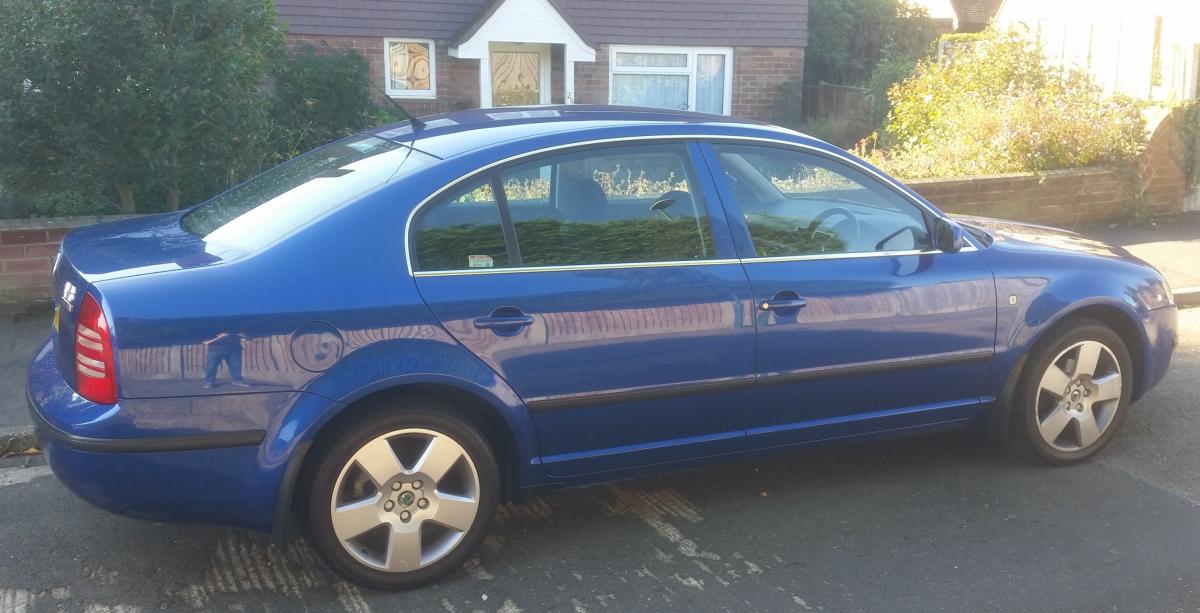

Picked up my Superb!
I got it! Had scuttle tray off, no standing water all internal electrics seem to be working!
Good times!
