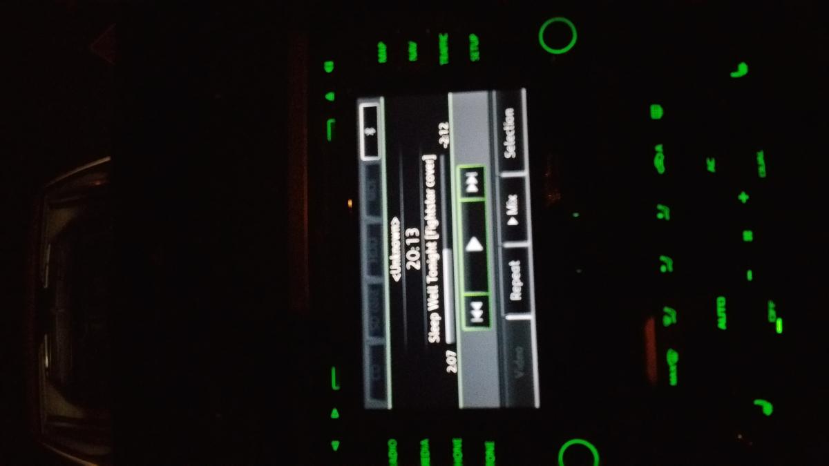

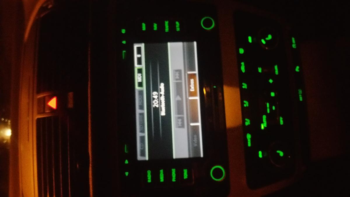

If I change bluetooth setting on columbus to be able to control the phone to change tracks via car I get info of track on the screen and can change track but no sound comes out. Change back to just basic streaming and works fine... anyone help with this...
This setting works fine so sound
This setting allows me to change track on screen and timer but no sound
