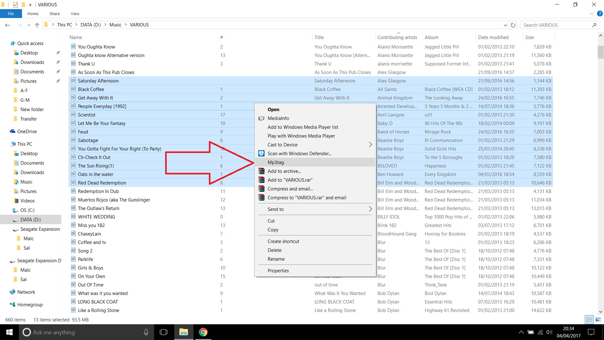

anyway highlight your track(s) and right click you should notice now mp3tag is available as an option mptag1.thumb.jpg.03b77e7c0caa2e971683f0765c09c8a6.jpg

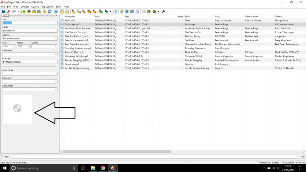

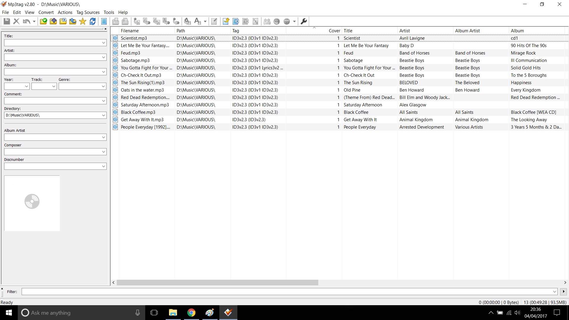

you then should be presented with this screen (same highlighted blue tracks but now loaded in mp3tag )

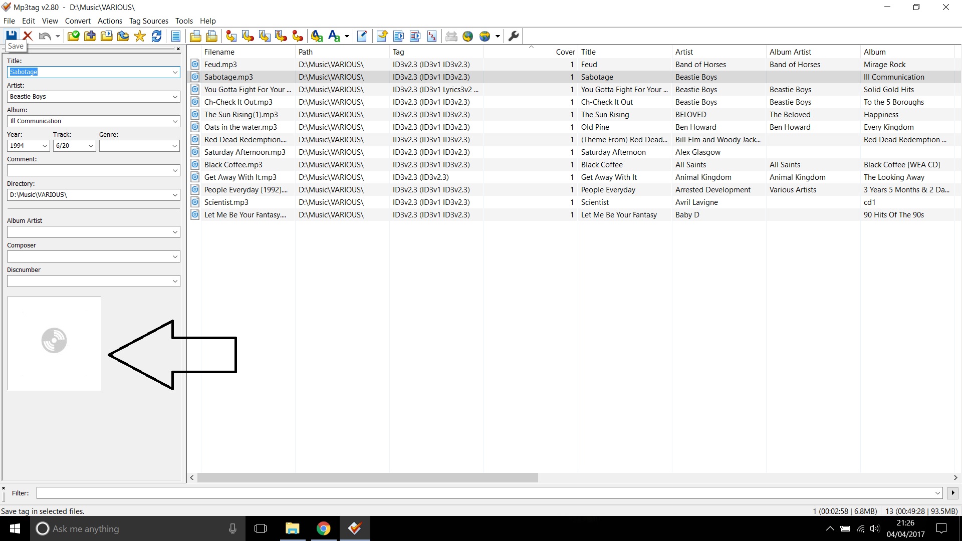

so for the guide i selected beastie boys sabotage notice how in the bottom left of the screen the album artwork is not present the boxes on the left allow you to alter any names etc
occasionally artwork may already be there but it may be too large or too small we will address this in due course i think the limit safely is 500x500

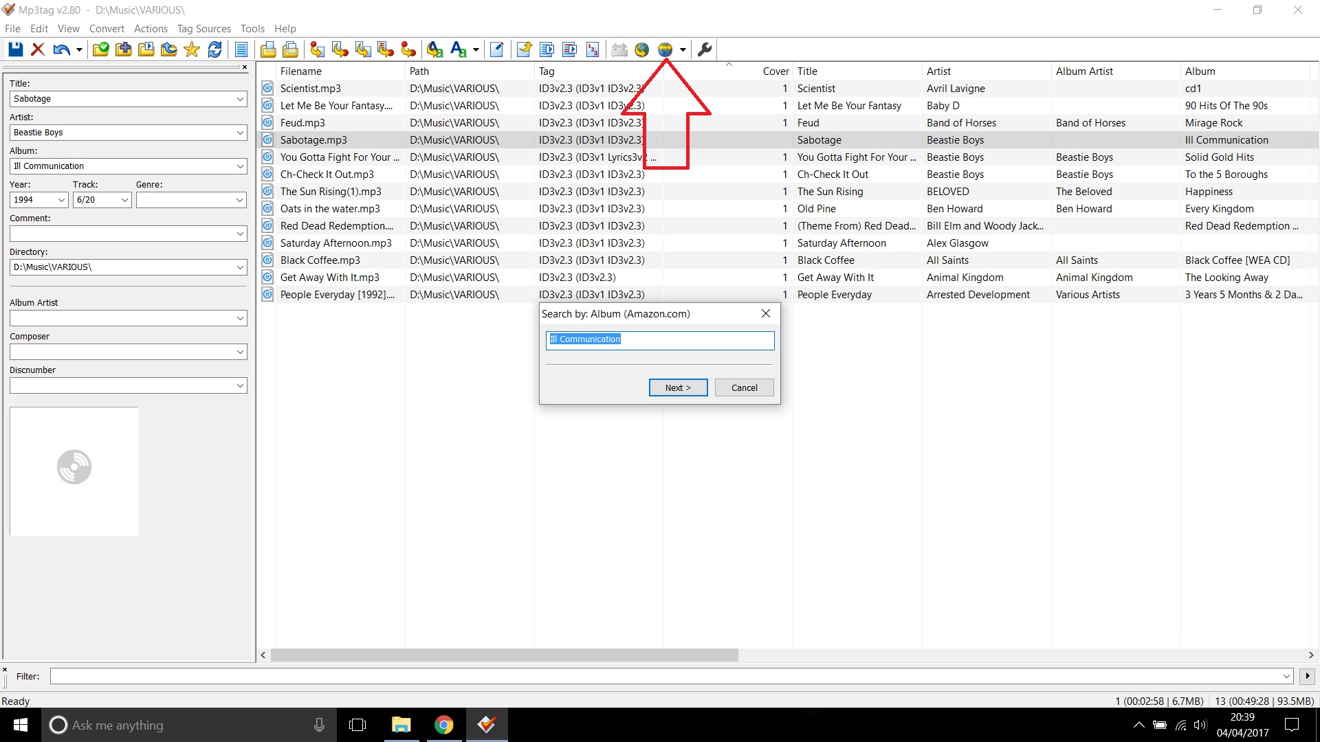

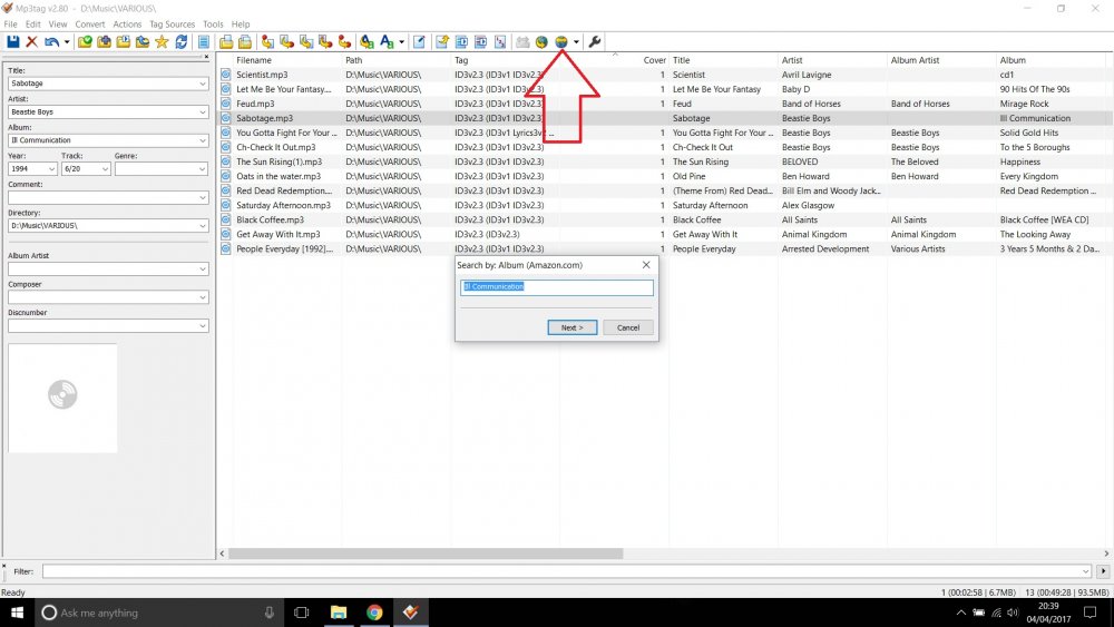

with sabotage highlighted i click the following button and it populates the album title for me  mp3tag3.thumb.jpg.6694f0da48b22322a98bfb3442017ef0.jpg
click next and a search box appears hopefully with your album first and highlighted you may need to drag the little bottom bar across to check

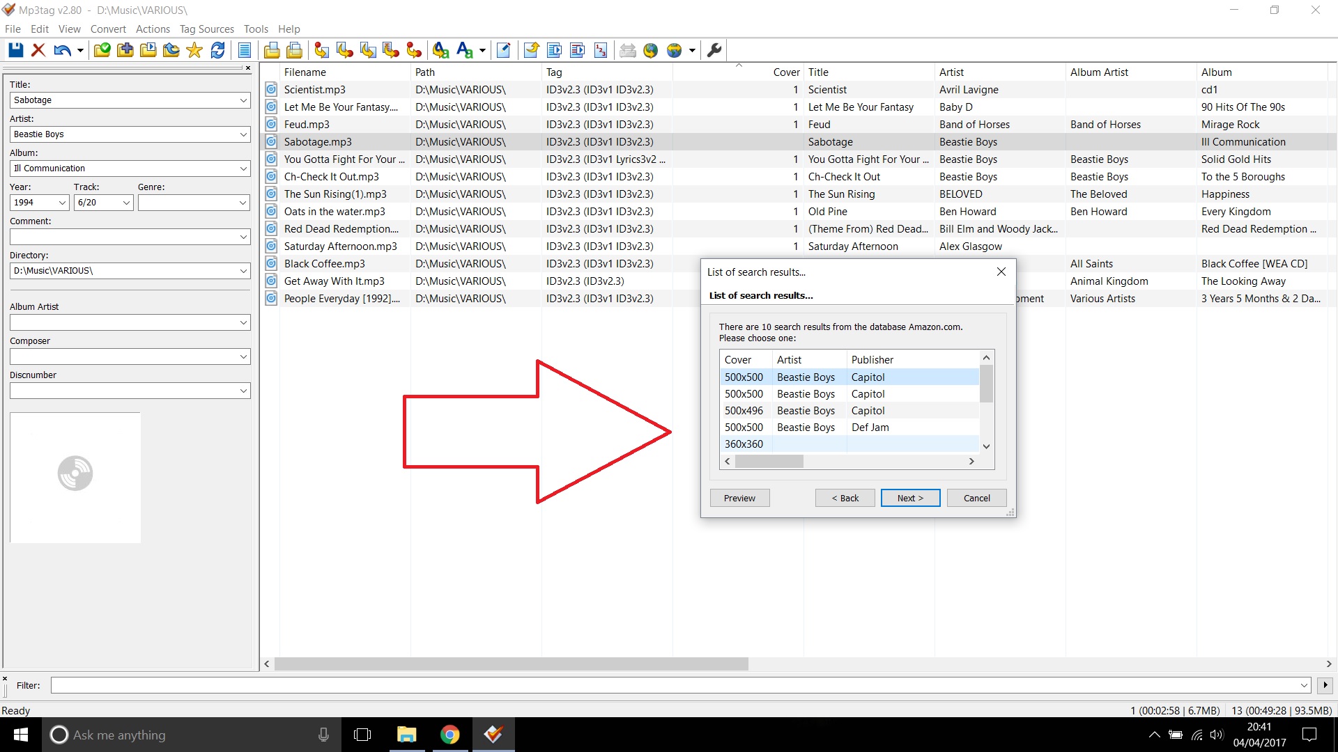

ok so this next step is where things can wrong badly

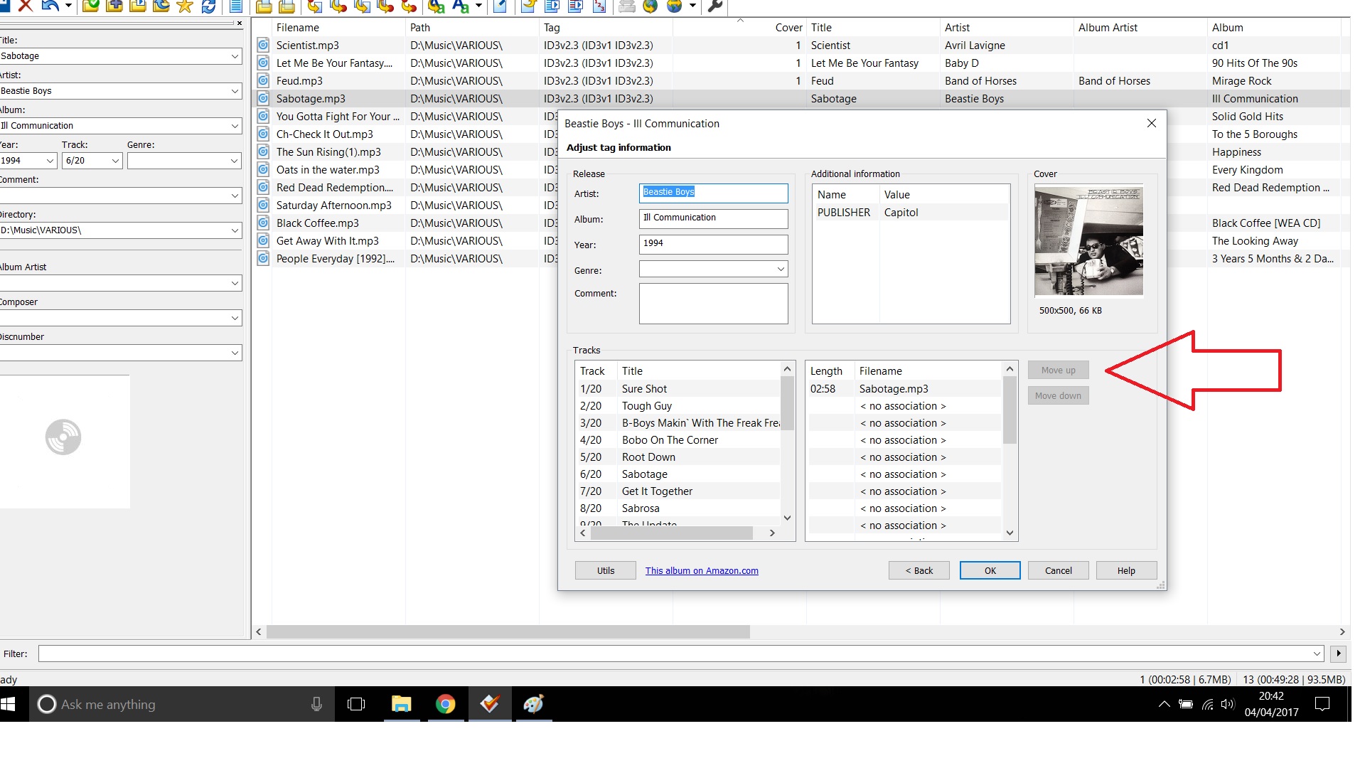

in essence what this next screen does is load the tracklisting from amazon in the left column and your highlighted track in the right column but it places your track in track number 1 position if you were to select ok here it would change the track name of sabotage in this case to sure shot...
so what you need to do is highlight your track and use the up and down button to place it in this example number 6 position then select ok

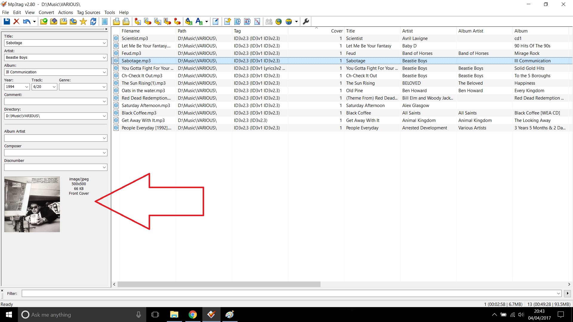

notice how the art work has now pulled through if there was any picture there previously it gives you the option to save previous covers i always select no

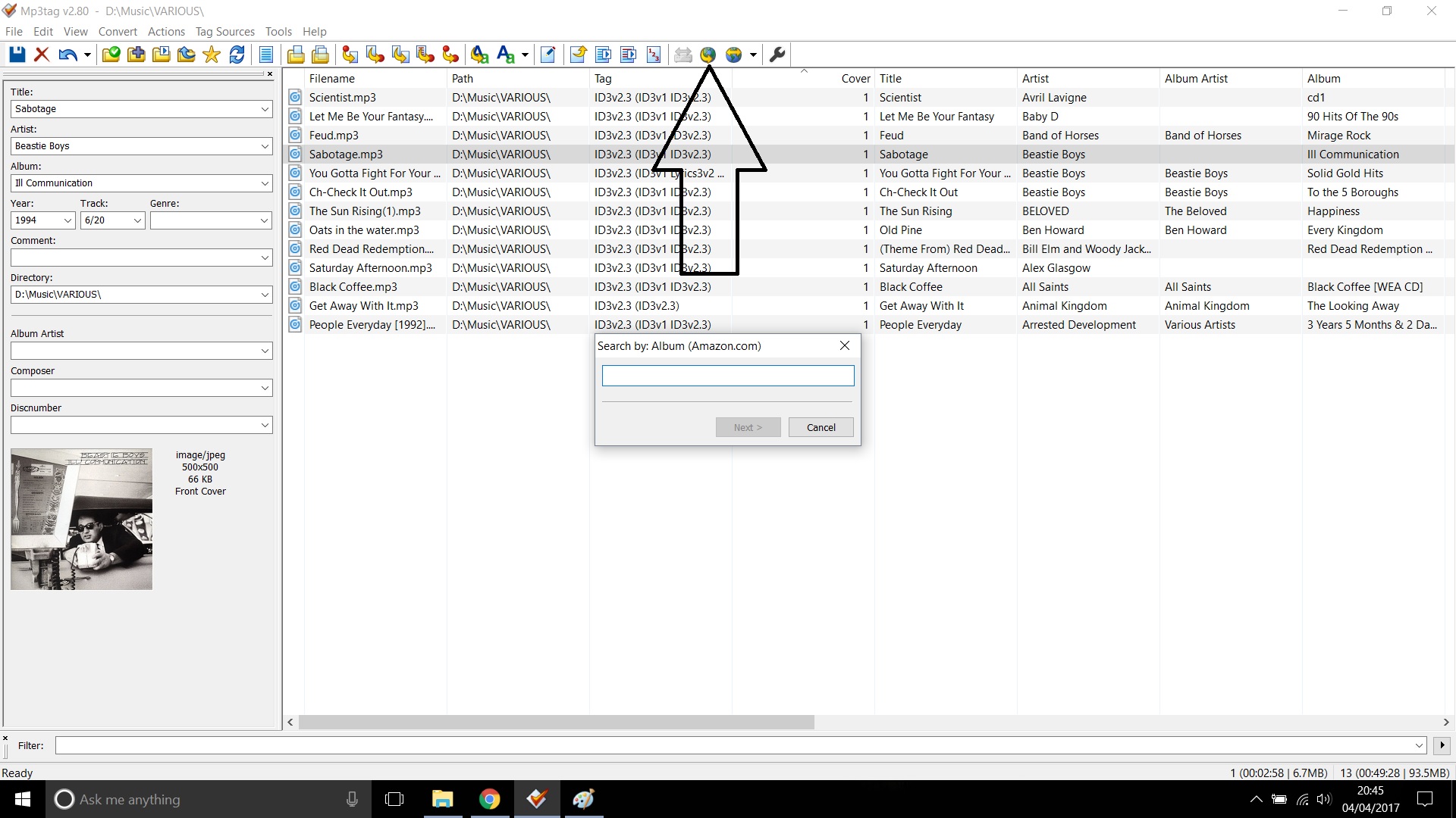

occasionally you may not have the album information in your initial tag so by clicking this you can search on amazon by song title or artist or album name (i usually google the album first )
