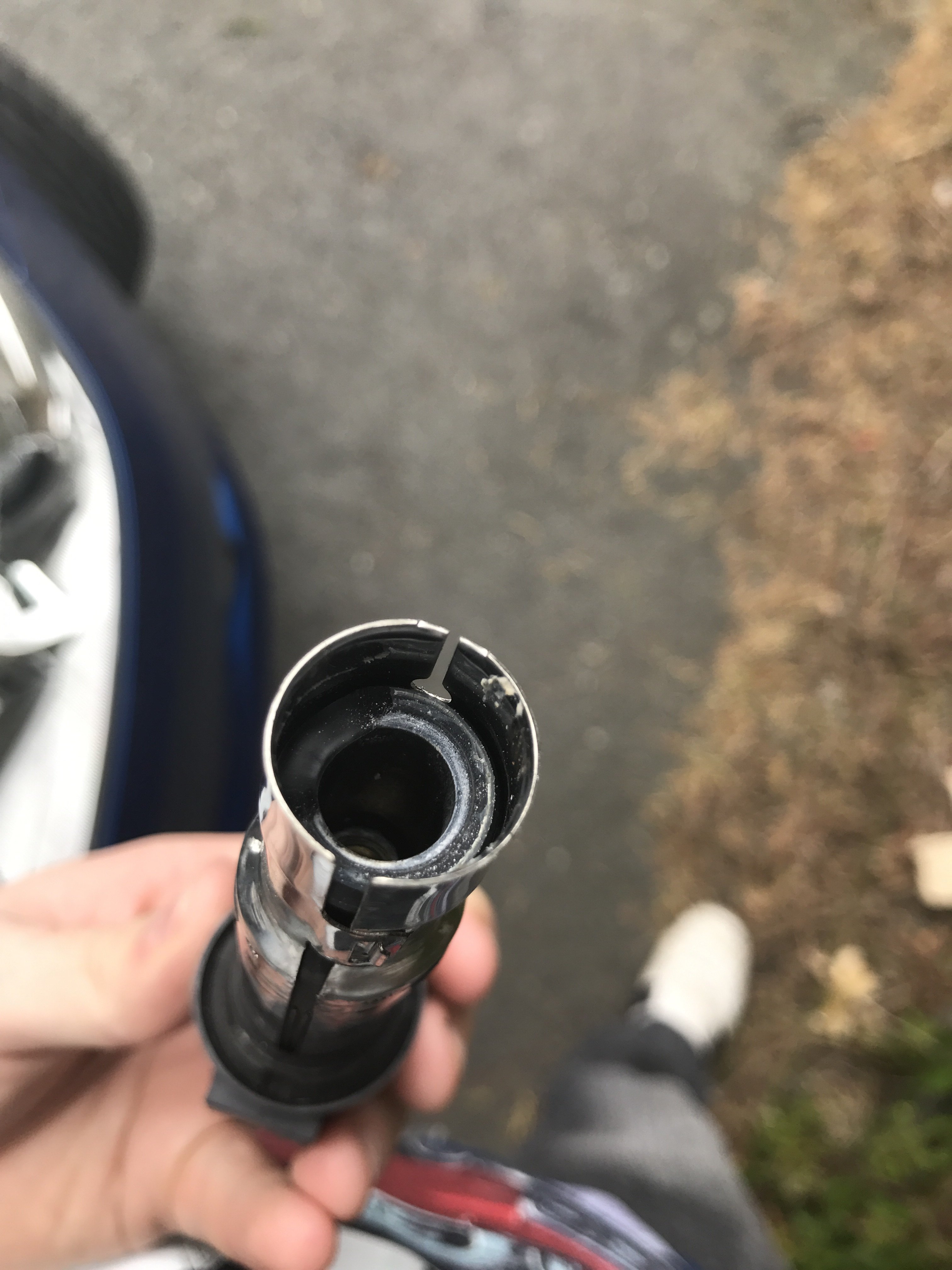

I've being getting a slight misfire with my car, I know all about this problems that this engine has (2011 cave) however this misfire is only very specific when in 3rd or 4th gear around 3000rpm it will splutter once then pickup like normal, it's fine when I hammer it off the line etc no loss of power.
Ive just gone to check the plugs which where changed in January to see their condition but before I even got to that I have notice that one of my coils has a piece that appears to have broken off, I can't see it anywhere and haven't removed the plug yet. The piece of the coil that's missing looks like it's the rubber that goes over the plug, do you think that this could cause any issues or not? I'll upload a pic of the coil, I hope you guys can help me out! Cheers

Do not remove the spark plug until you get any bits out beside it.
You need a new coil, maybe 4 if the person that did the plugs last was handless.

I haven't had the plugs out but i have replaced all 4 coils and its fixed the problem i was having, the car feel much more responsive now and no longer misfires when under load.
when i took out the old coils all 4 had pieces missing like in the photo, there was no broken bits down in the spark plug well, so my guess is that they have been like that for awhile.
