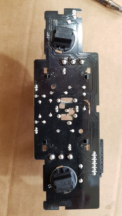

Ahh this might explain my fault, exactly the same as above! No voltage going to the central light with doors open. Will it be obvious which track I need to repair? Fancy meeting you here Sasha!

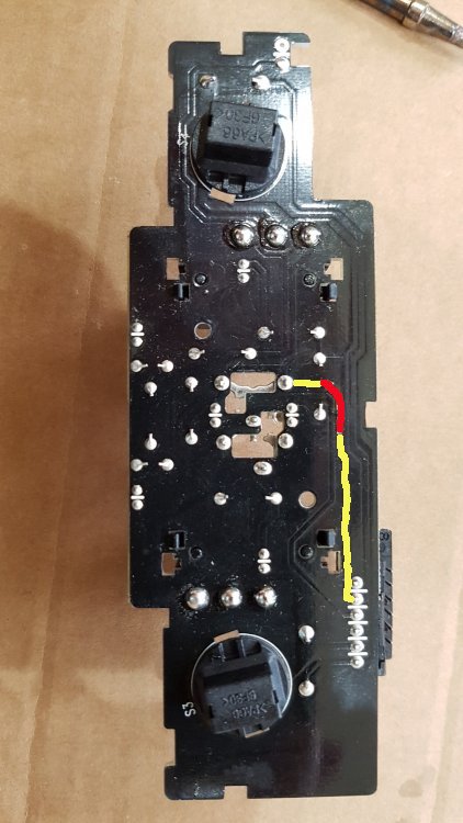

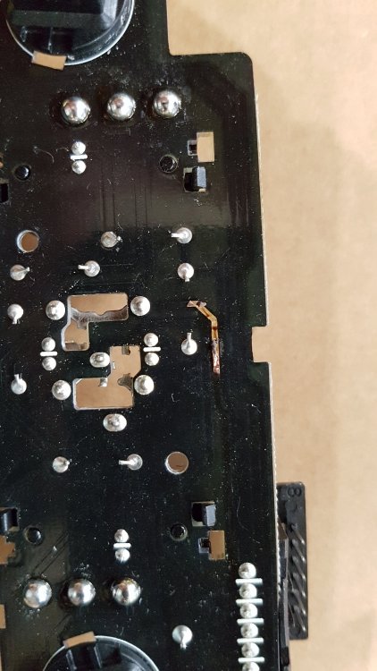

Mine had fused in the red area but it could be anywhere along the yellow track shown
I will be getting the soldering iron out tomorrow!

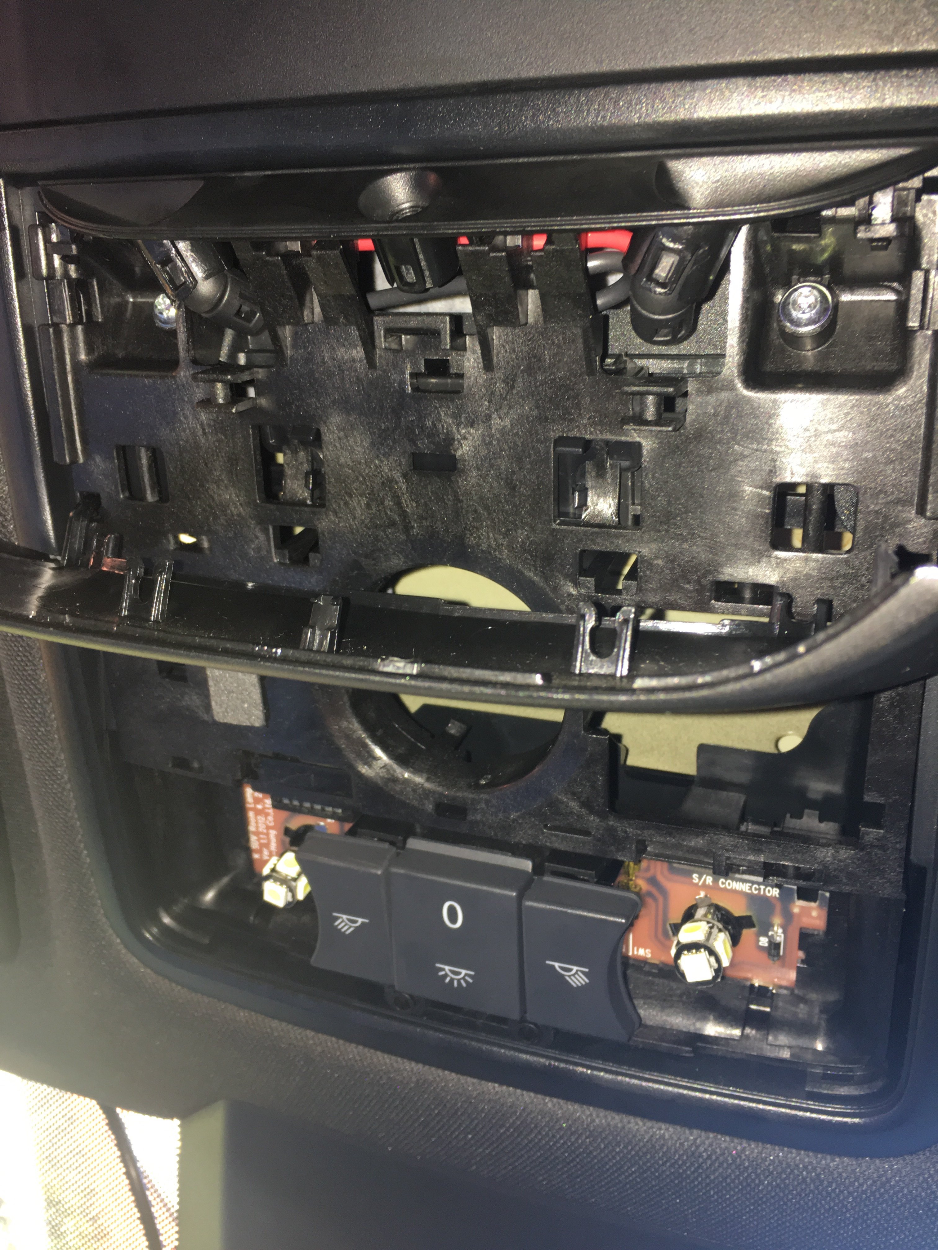

Quick question, to get to that board do I have to strip out the whole central light? Does the whole unit pop out, if easily or do I need to unscrew the small hex screws?
Edited by Ballsy
Unscrew those two screws and pull it out :)
