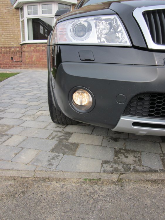

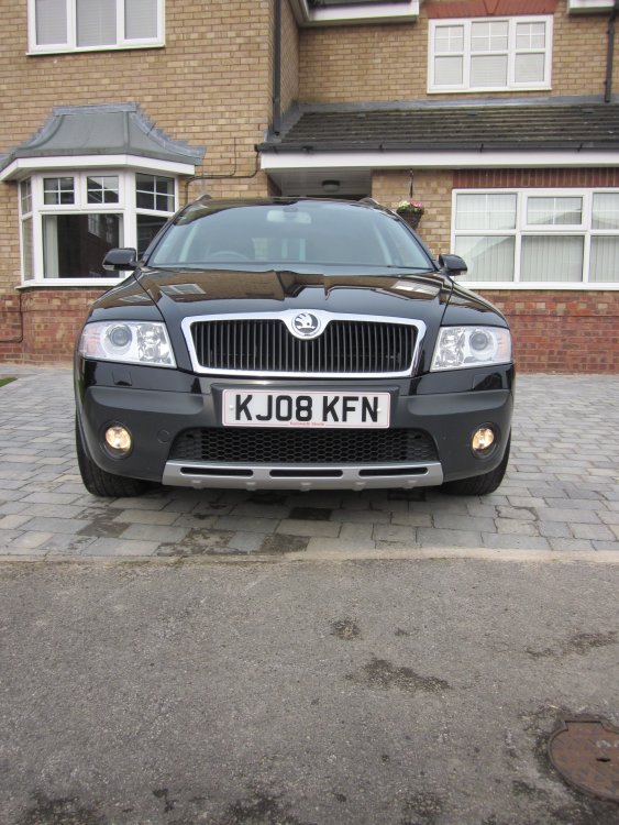

If you have front foglights then as you mention these can be set-up using VCDS to operate as DRL's at reduced intensity. I did this on my 2008 Scout...
59a9931f405a5_Picture34.thumb.JPG.ff3ce61b98f89c2d859a145123a07c19.JPG59a99337a450c_Picture35.thumb.JPG.4670849fcdde98fe3505d76fff6d3ef1.JPG
No disrespect whatsoever intended, Silver, but the lights in your pictures are hardly noticeable imo.
Or is it just the pictures?

It's the pictures, was a very bright day and the slope on our drive doesn't help.
The brightness can be adjusted in roughly 10% increments, I think mine were set at around 60%.
They look pretty dim here but on a duller day they were just about right.
