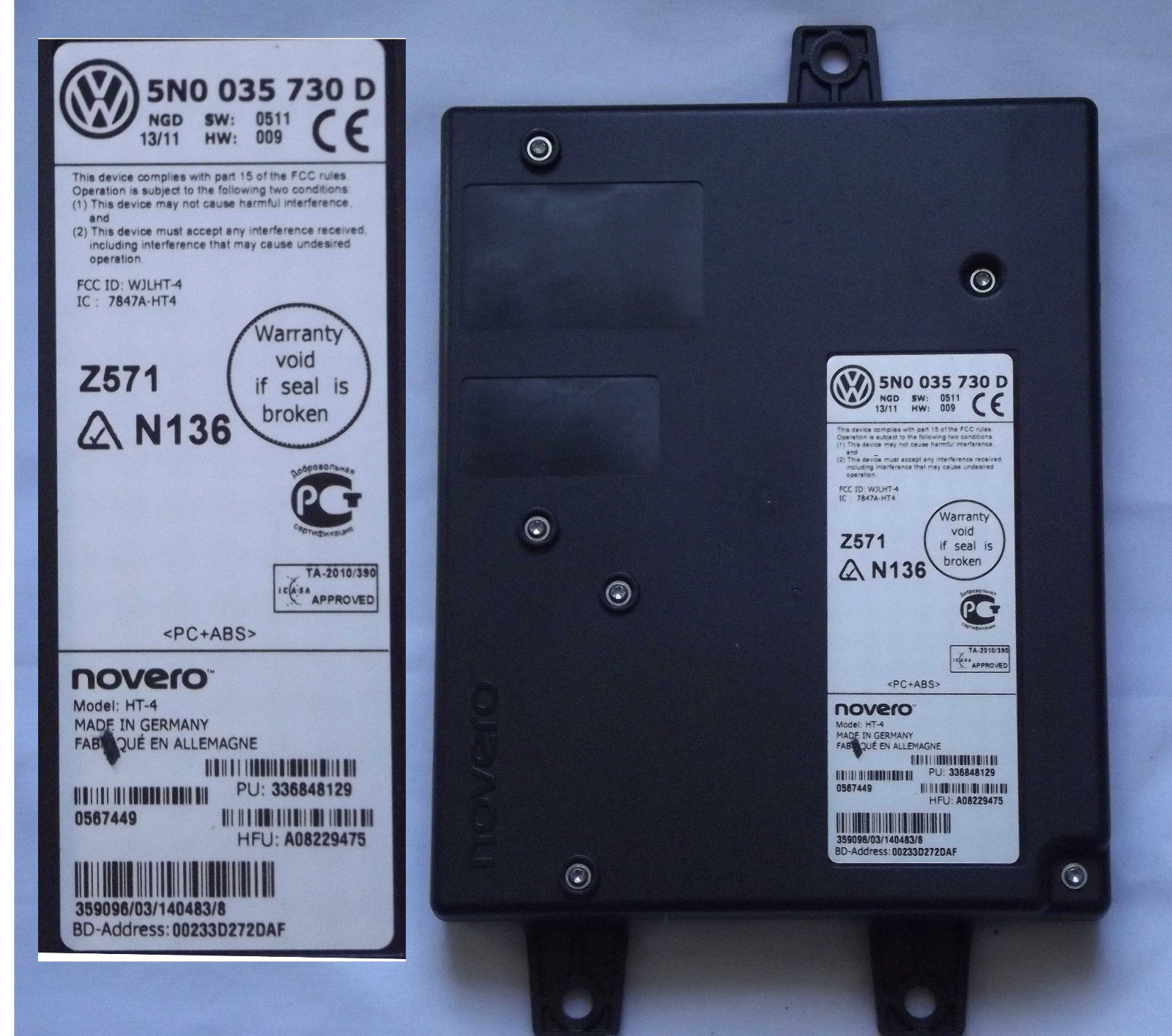

i have tried a samung s6 today and having the same probblem. so im now thinking it could be the bt module under seat that needs upgrading  to
Skoda VW rSAP Bluetooth phone module 5NO 035 730D but will it need recoding
