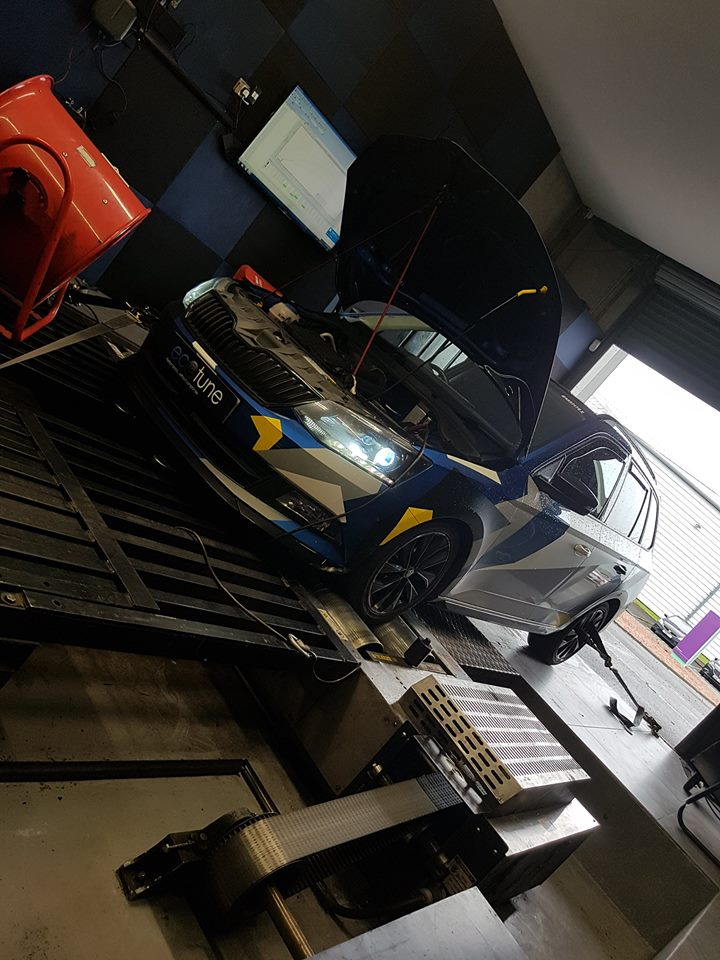

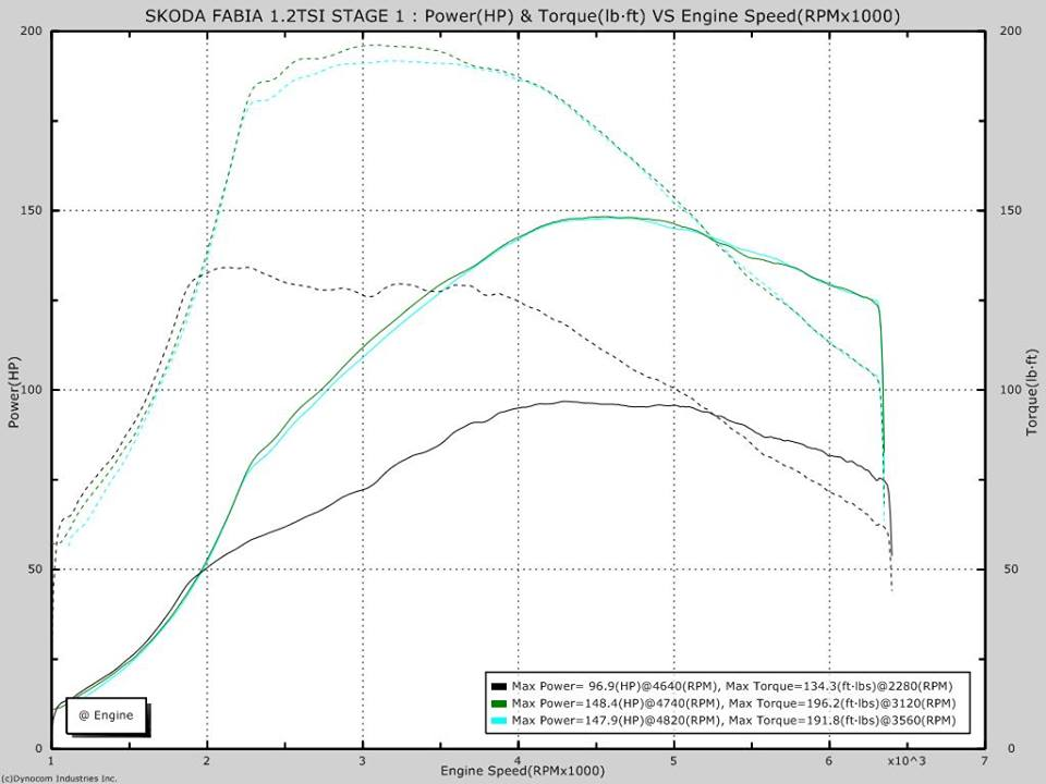

The results on Scott Penny's Skoda Fabia 1.2TSI were just too good not to share.
We applied APR's software to the 1.2TSI delivering peak results of 148hp and 196ft/lbs of torque using APR UK's 98RON Calibration, completely transforming this car.

The APR Calibration is interesting seeing as UK Super Unleaded is 97 ron unless Shell V-Power Nitro+ , Tesco Momentum 99 or the 99 ron Super Unleaded COSTCO is selling.
So can we assume when Dynoed in the UK they have the car running on 99ron Minimum and not 98 ron or 97 ron?
Edited by Headinawayoffski
Car was on vpower
It would be good to see what it puts out on 102 ron.
APR never seem to have put anything on the bumff they publish about the UK not being a Country selling 98 ron.
VW Group never seem to either.
