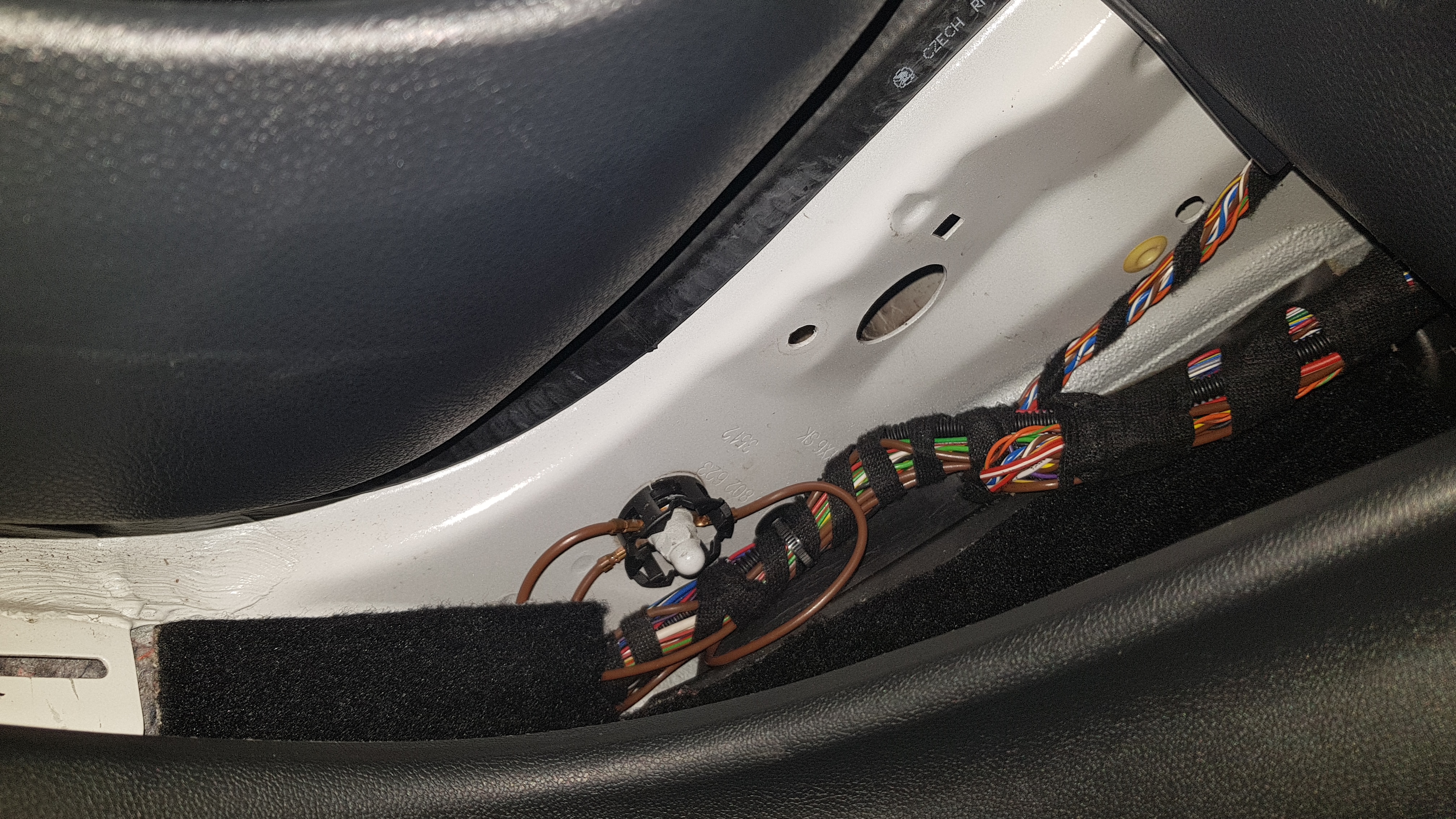

Hi there posted a topic about a year ago on here about my Octavia 2012,with a leak in the frame of my car on the passenger side in front of the door.when I put my finger in the hole of the frame it's all wet,It's also affecting my electrics,the light bulb symbol keeps coming up saying check rear brake light the wet or moisture coming and going over the wiring near the leaking hole.
A year ago I checked all drain hole and looked for blockages nothing seemed blocked.The only thing that seemed to work is when I put a screw driver in the hole and wiggled it about in an attempt to make the water drain out,which did work but now my break light warning is coming on and there's a small amount of water collecting in the frame hole.

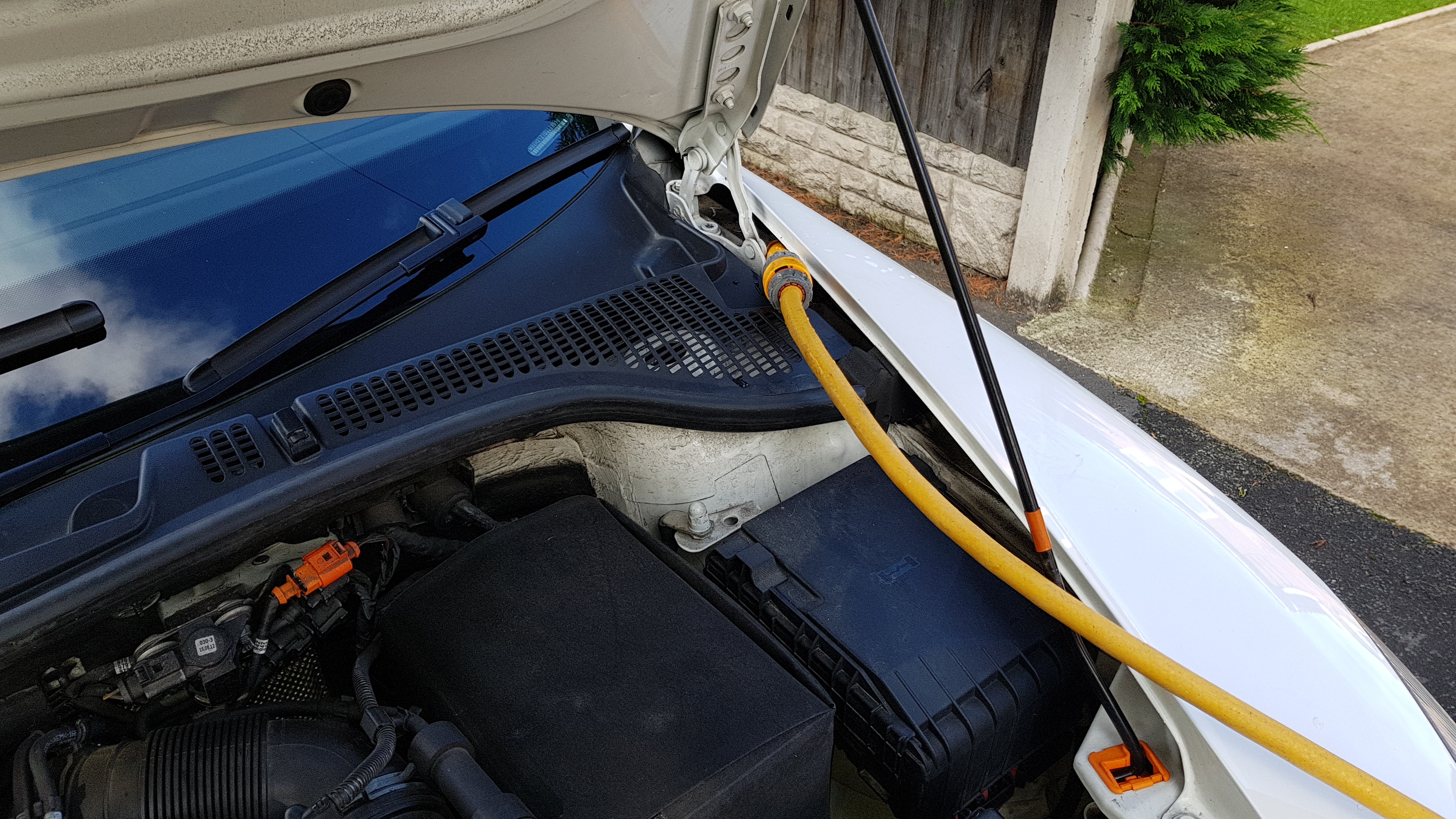

I done a water test today to see where the water was coming from and it's when I put the hose on the windscreen no water came in When I sprayed water in the wheel arch or under the car.

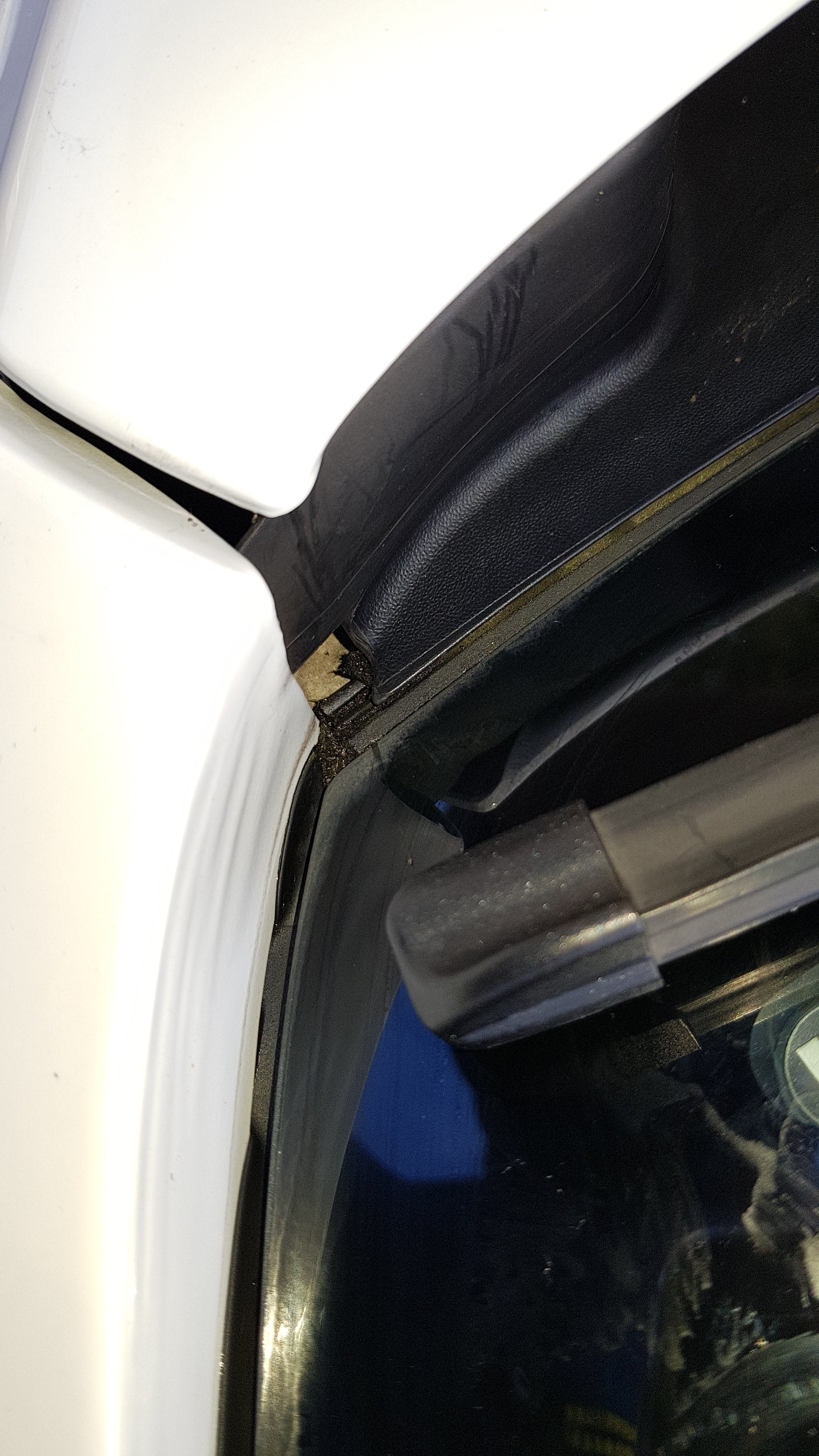

No mate, I done another water test and the water is coming in from underneath  the wing I also noticed that there's a gap at the bottom of the windscreen which allows the water to drain onto the wing.
It's entering there and ending up in the pillar. 150739665805926123201.thumb.jpg.66cd50029ac5898e95cee9becbc6ec4f.jpgpost-62482-0-05553600-1457975410_thumb.jpg
